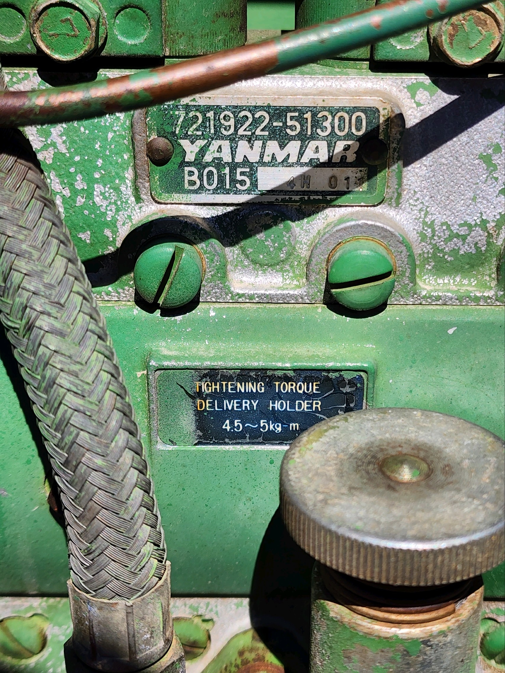

I have a 1984 JD 1650 (yanmar built).
Seems to be hard to find parts for. Tractor currently has 2900hrs but would like to find source for future as I plan to keep the tractor.
I am at a loss...

Yeah I've not posed the question to JD dealer I do not have a real local /close by shop.
Mainly thinking along the lines of injection pump, engine wear etc. When I google the numbers I don't see rebuilt kits or anything hardly for the engine.

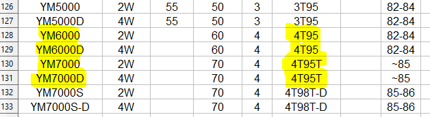

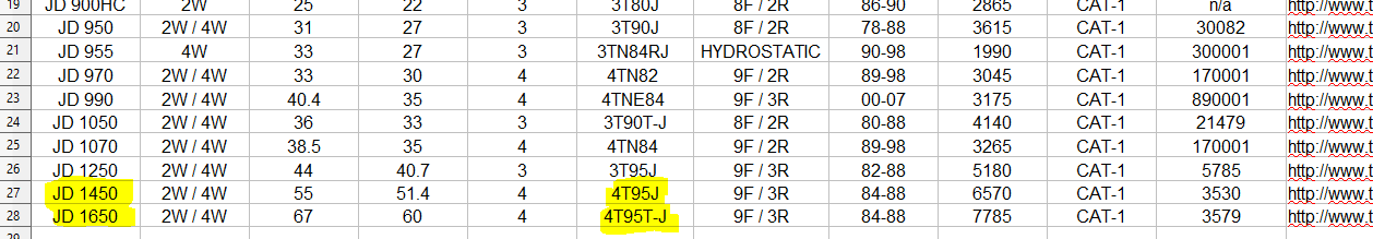

The JD1450 is really the same engine as the JD1650. The JD1450 is with-out the turbo. Look at the rebuild kits for the JD1450 to see if the numbers cross over.
Should you reach out to the Yanmar parts network found on the YTOG, then these engines would match too.
Do not get anything related to the YM7000S. The 4T98T is only shared with the larger Mitsubishi tractors of that era.
