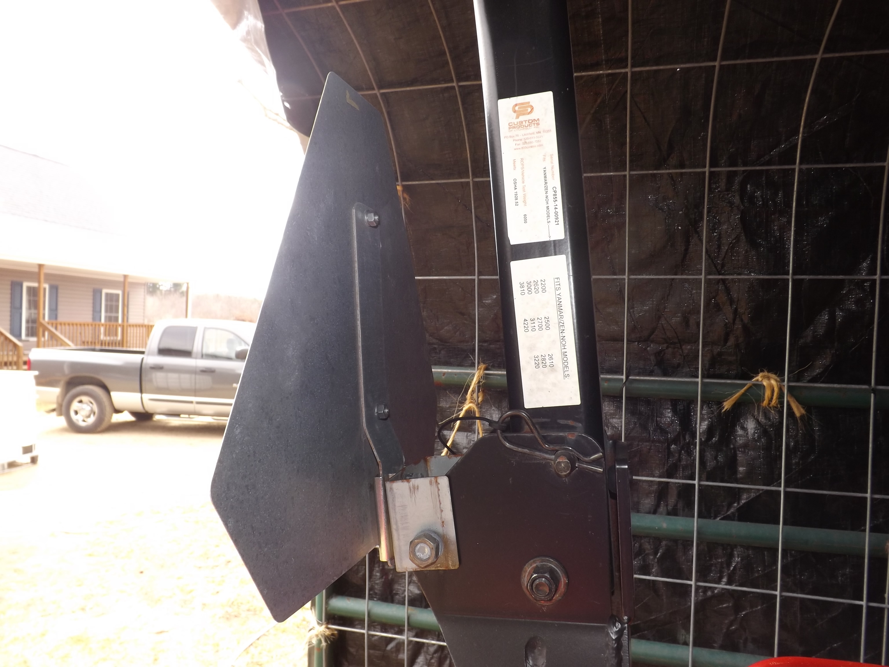

My tractor has a folding ROPS that is locked with two clevis pins, I've lost one of them. As far as I can tell they are 24mm diameter. I haven't been able to find a dealer who has a replacement. I tried using a 7/8" hitch pin, it was too small, and a 1" pin was too big. If they are 24mm then 15/16" would be 23.8mm and I think that would work. Length is about 4".
So far no luck in finding anything suitable. Any pointers?

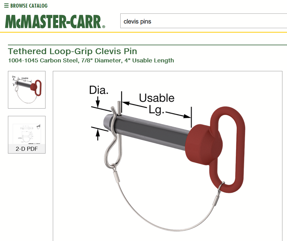

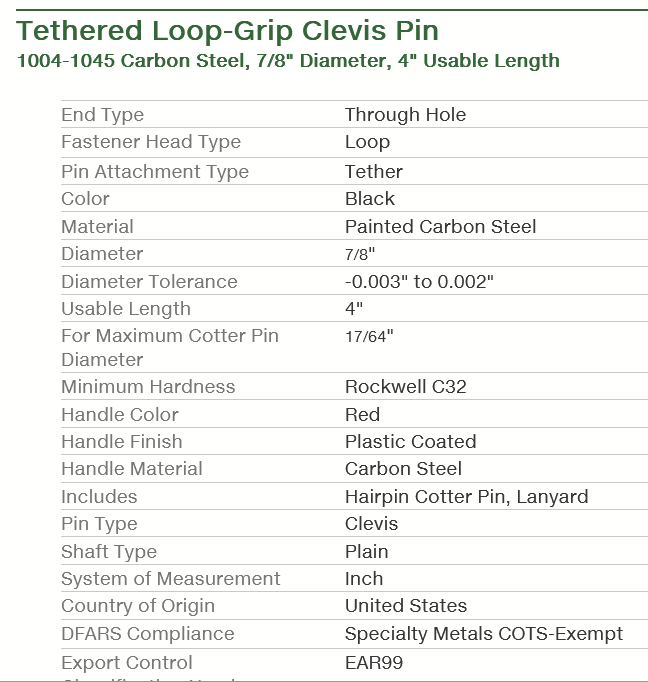

McMaster-Carr
My folding ROPS uses the same size your machine has. And it has these McMaster clevis and pin setup.
