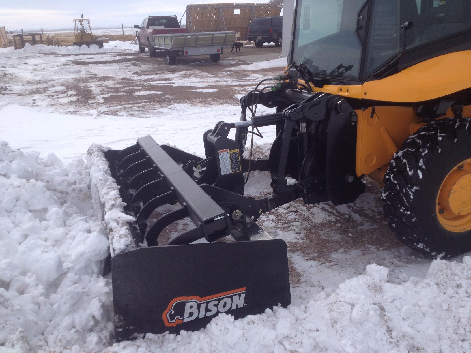

I looked at the gannon, EA, and the Bison. Calculated a price per pound and ended up with the bison.
84" Bison 3-Point Industrial Hydraulic Box Scraper Model BB21-1
