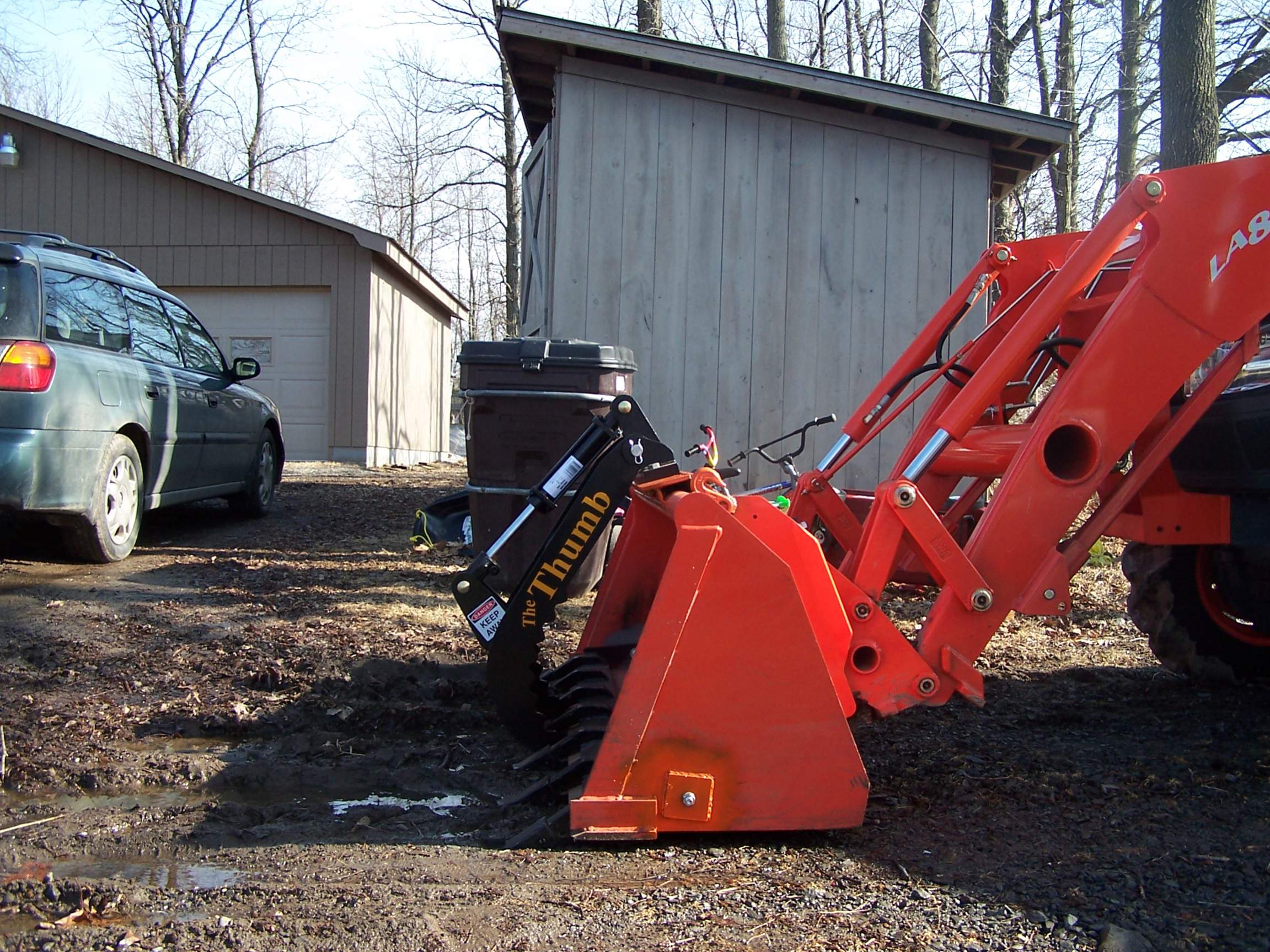

Here is a picture of mine on a Kubota.Green's Machine Thumb($400?) and a tooth-bar purchased from a dealer no longer in business but I believe Michigan Iron can help.Maybe $150 for a tooth-bar.
Mine is set-up as a bolt on,so easy removed if needed.Down fall is the opening will not be as great as a full grapple;but still very useful for brush ,logs ect.
You will need a third function,divertor valve or run off the rear remotes to operate the grapple or thumb.

You will need some sort of hydraulics to operate a thumb or grapple.A diverter lets you use the bucket curl function to close/open the grapple/thumb.A true third function($600-$800 guess) is independent of your bucket curl.If you have rear remotes;you can run hoses to the front to operate the grapple/thumb.
Roll back on your bucket has no bearing on the size of the grapple/thumb opening.
Any grapple designed for a skid steer is going to be very heavy and take away from you lifting capacity.
As far as visibility;if you can see to use the bucket you can use a thumb on your bucket.Stop and think about it;you can't see through the hood of your tractor now.
I have had my set-up for about six years;found it very handy for brush work and lifting logs ect.
