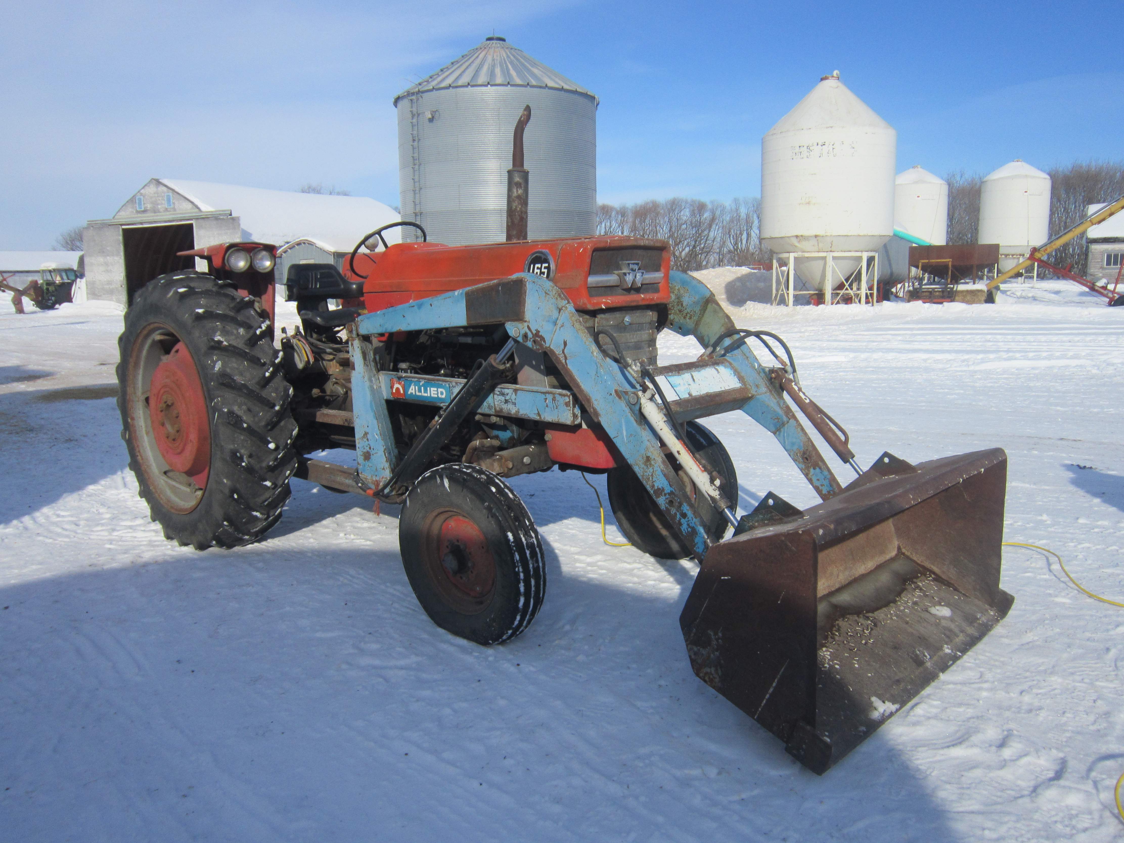

With a MF you dont "need" a front pump I have run several 200/300 series plumbed right into the remotes , depends what you expect to do with it . I load over 3000 3x3x8 big square bales a year 3 at a time with straw or 2 first cut /3 second cut alfalfa with a stock 390 plumbed with quick couplers in the rear remotes, **** my MF 165 will load 2x straw or or 1 hay at a time ?

Sold this off the 165 loader this morning , with the bucket.....$350
