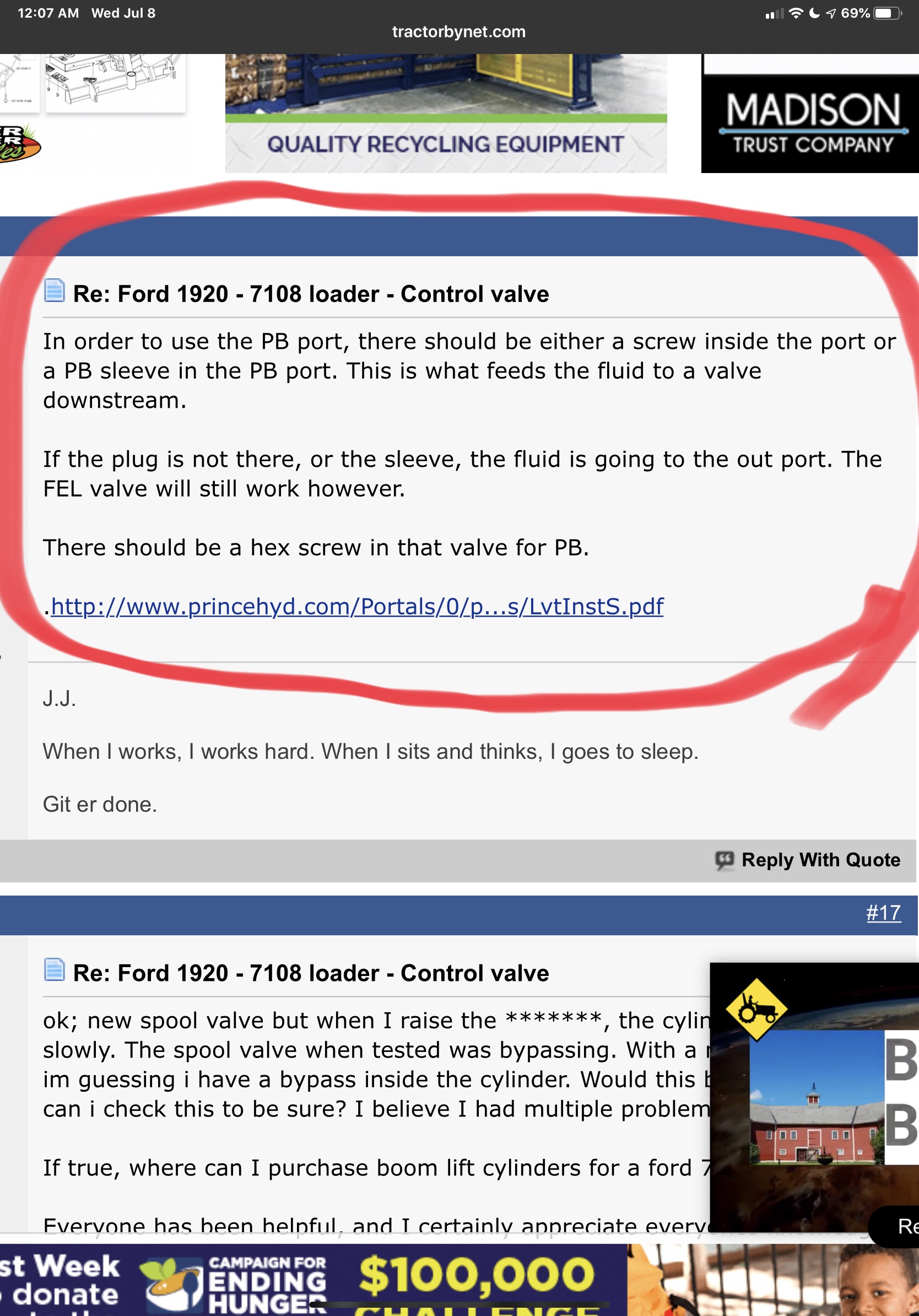

Im running a power beyond on my New Holland 2120 Tractor that has a New Holland 7308 Loader The OE rear remote kit is obsolete.
We removed the loader valve body and found a port designated with the letter N on the casting of the valve body. Research shows that is a power beyond port.
We have our plumbing in place and have flow to and from the implement, (a LS back hoe) but, no pressure.
Scouring these pages, I ran across a similar situation and a power beyond sleeve seemed to be that situations solution, but never gave info about what sleeve.
The link to the conversation (page 2):
https://www.tractorbynet.com/forums/hydraulics/227522-ford-1920-7108-loader-control-2.html Ps this guy had a snafu of issues he was chasing.
Thanks for any help. Ive contacted my New Holland dealer and he doesnt show a part# for a sleeve and I talked with Cross Manufacturing and they only sell sleeves for the valve bodies they manufacture.
Thx Dez

That particular valve does not use a sleeve as many know it. Find an open tapped port in the valve casting below a hex headed plug. It could very well be at the N port you mention. That unplugged oil galley is currently allowing power beyond flow to commingle with the return flow preventing your power beyond circuit from developing pressure. Install a pipe plug in the threaded port (1/4 npt IIRC) and life will improve.

**SOLVED**
Thank you all for your help, its greatly appreciated!
My power beyond plumbing was correct, it turned out to be a problem where the return line ran after the back hoe.
