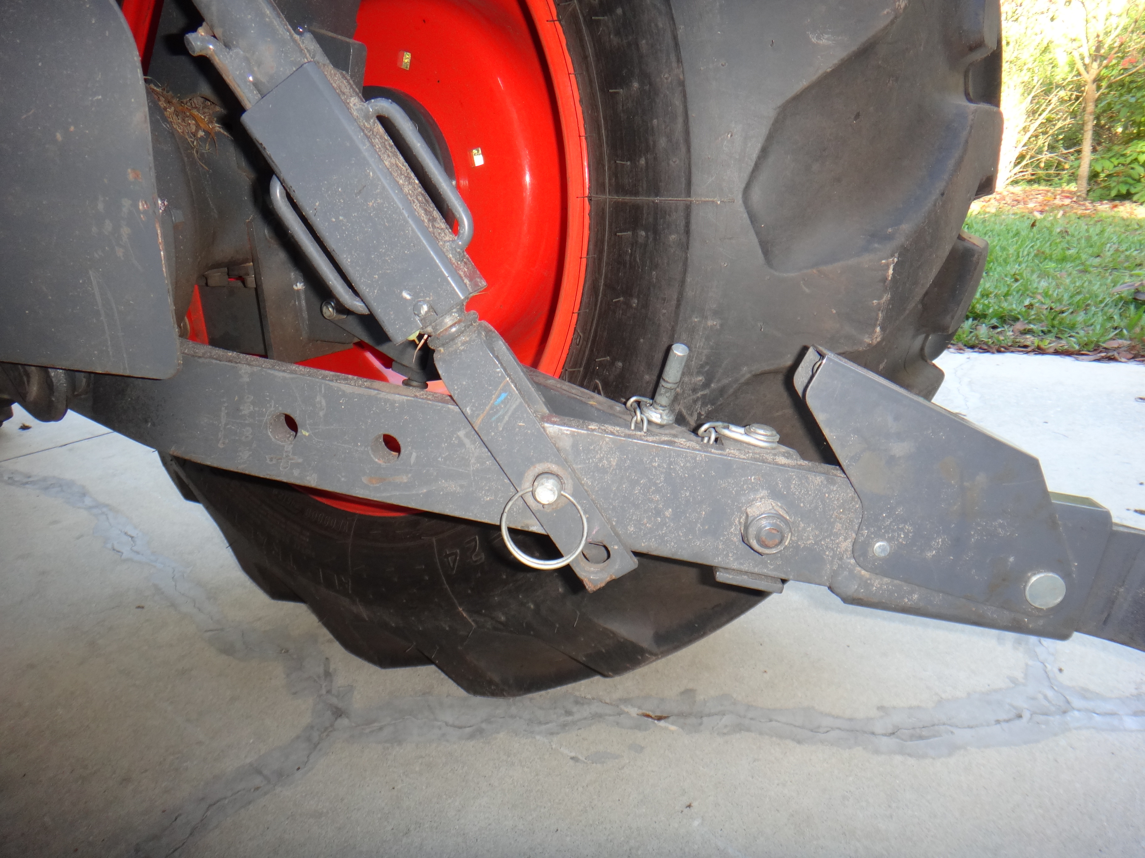

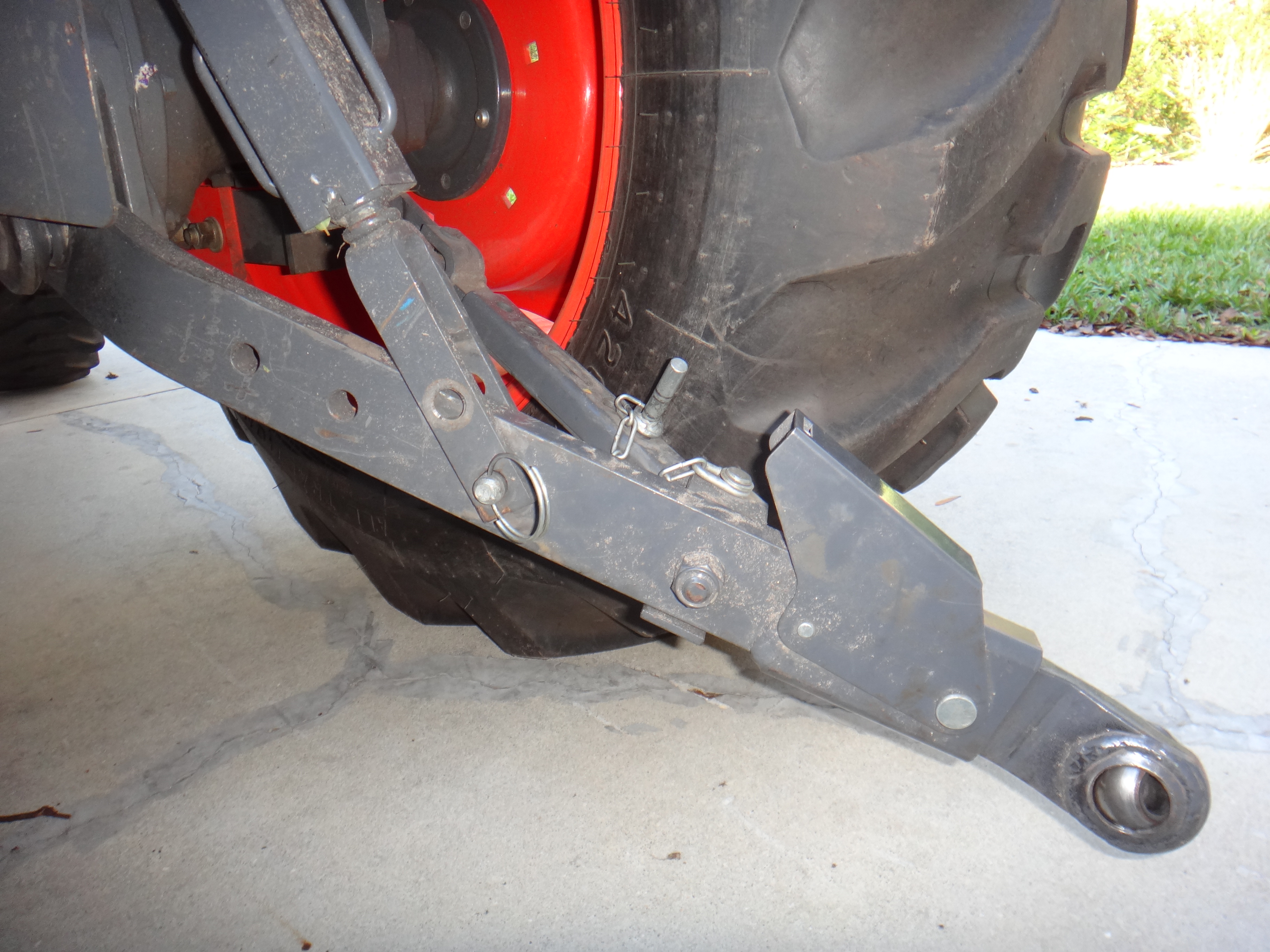

You should be looking at Subsoilers rather than Middle-Busters. Subsoilers are heavier built and designed to go deeper, though you might have to rip the same row twice to get the width you want. With your hydraulic Position Control you can set any increment of penetration depth, until you reach as low as your Three Point Hitch allows.
~~~~then:
If you have pin adjustment holes in your Lifting Rod stirrups, you can change the default upper hole pin setting to the lower hole, which will drop the bullseyes on your Lower Links about 5".
Any implement made from square stock would provide tremendous resistance to the tractor moving forward. Anything hollow (i.e.: box frame) would be breakage prone. The leading edge on the better Subsoilers is tapered, with the wider part aft.
