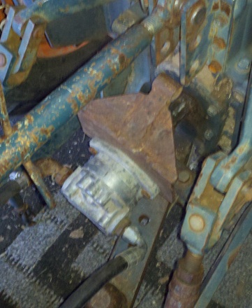

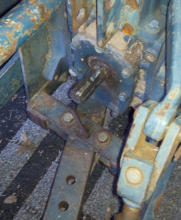

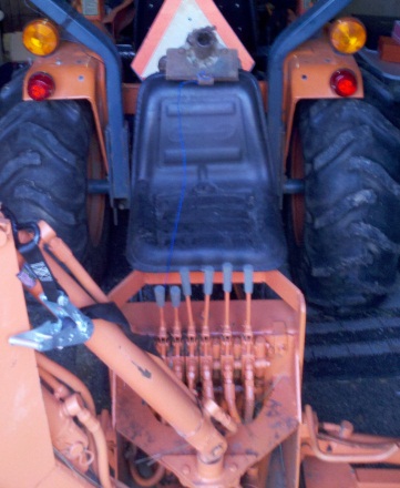

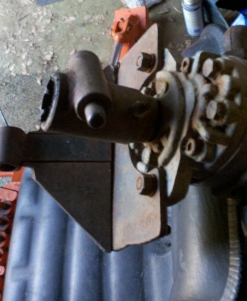

   / Looking for Advice on a Recently Aquired 3pt Backhoe - Newbie to Tractors!
Here are some pictures. You can see that the part of the PTO shaft where the locking thumb pin would seat is to long for the female receiving bolt? Picture also shows how it doesn;t mount up properly. Also, does anyone recognize this make and/or model backhoe? Thoughts on making this work with my Kubota?

I will start this by saying in no stretch of the definition am I an expert on this topic. It seems similar though to the pump I put on my PTO to pressurize my sprayer. I have a piece of angled gavanized steel with holes in it that you can buy at any hardware store. It is 6 or 8 inches long and bolted to the pump. And I have a small chain attached to it that I wrap through the holes in the draw bar to keep the pump from spinning and wrapping up the hoses when you turn the PTO on.
It looks to me like that is the purpose of the bracket that is on yours. But it sticks out so far that it probably hits the back of the tractor before the PTO mechanism locks. If that is the case I would think you could cut some of that bracket off and drill a couple of holes through it and put a chain on it as described above. At least in the case of my pump for the sprayer, it doesn't bolt to the tractor, you just don't want it to spin.

That looks like something that will work for mounting! Thanks! Any thoughts on the PTO shaft issue? Does someone sell receivers that can be swapped on the pump? BTW - The backhoe was painted orange... I don't think its a Kubota... any thoughts on what it might be? I picked it up on craigslist and don't have a manual...

I would daresay it is not meant for a mid-mount PTO. They usually run around 2000 rpm, mostly for mowers and blowers.
If it runs fine on your rear 540 PTO, then thats it....just need to fabricate a mounting bracket.

When I bought my pump, I also had to buy a couple that went onto the front of the pump and on the other end had the sleeve type mechanism that went onto the PTO. See the link. You may need to take the pump to someone that can look at it and tell you what you need.

The bracket on the pump is to prevent the pump body from turning. If you remove it the pump should slide onto the PTO shaft and lock into place. You will have to modify the bracket or make a new one. I have a WOODS backhoe with a similar pump setup and the bracket hangs below the pump and is notched to fit on either side of the fixed draw bar.
