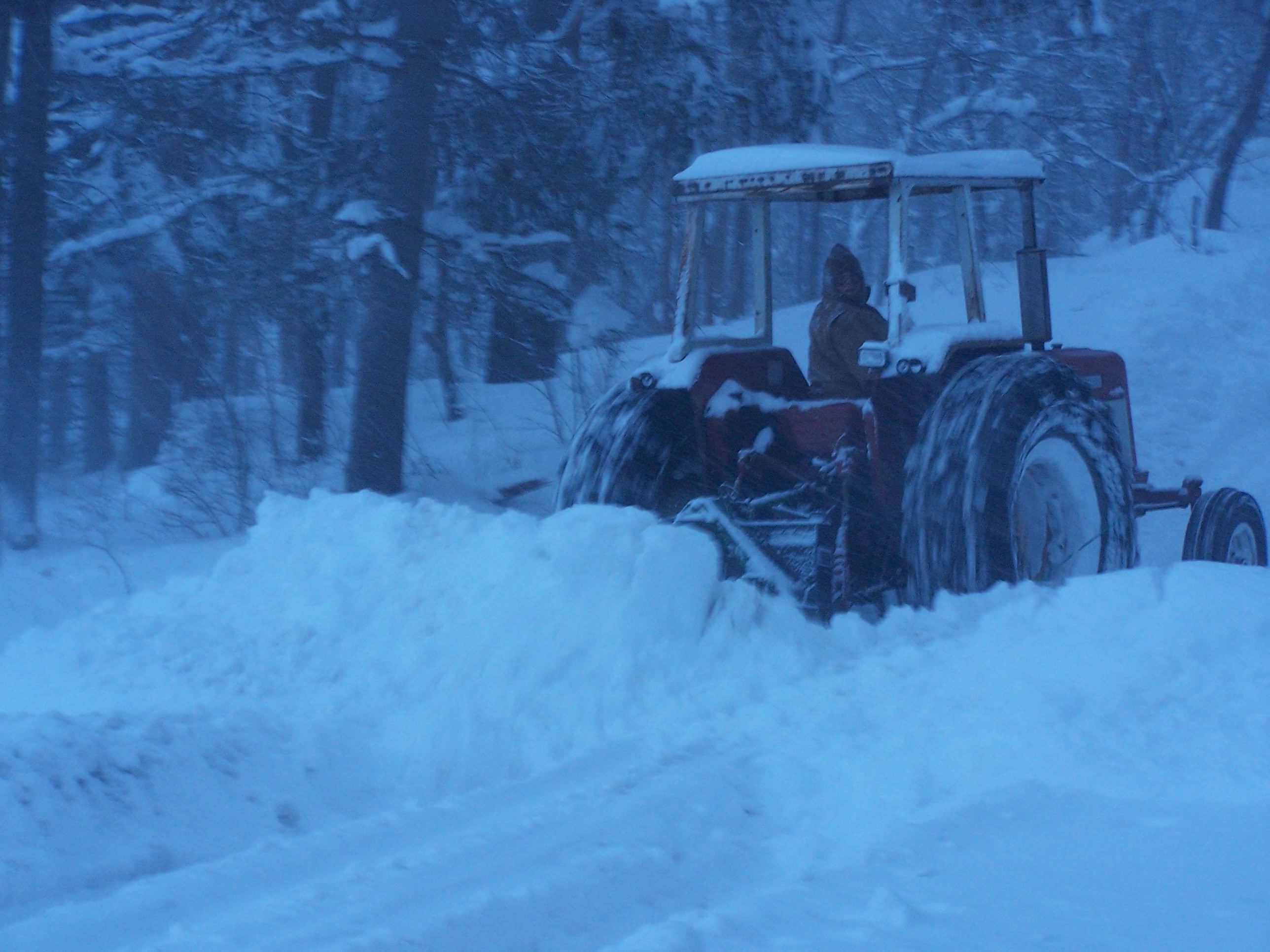

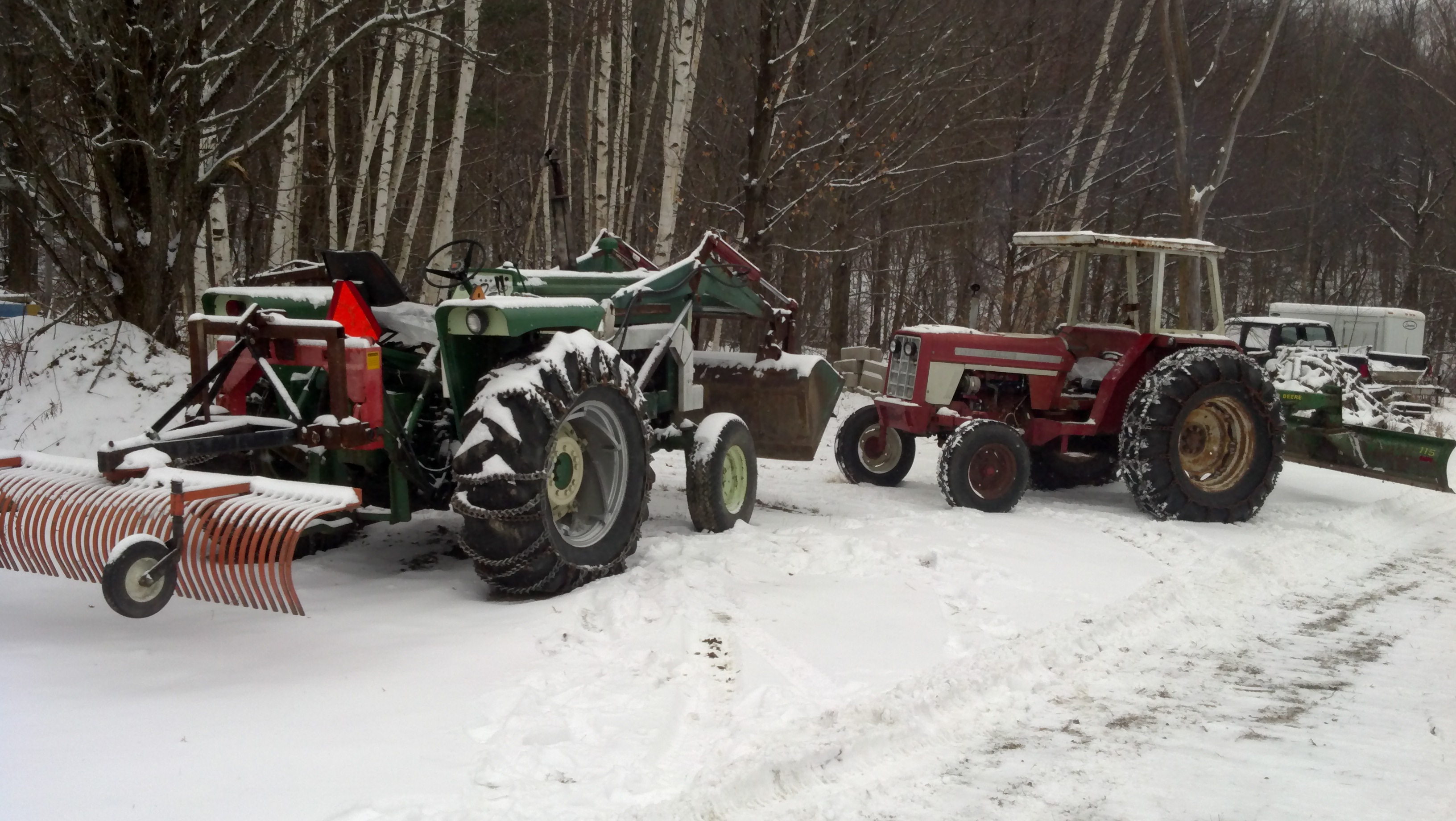

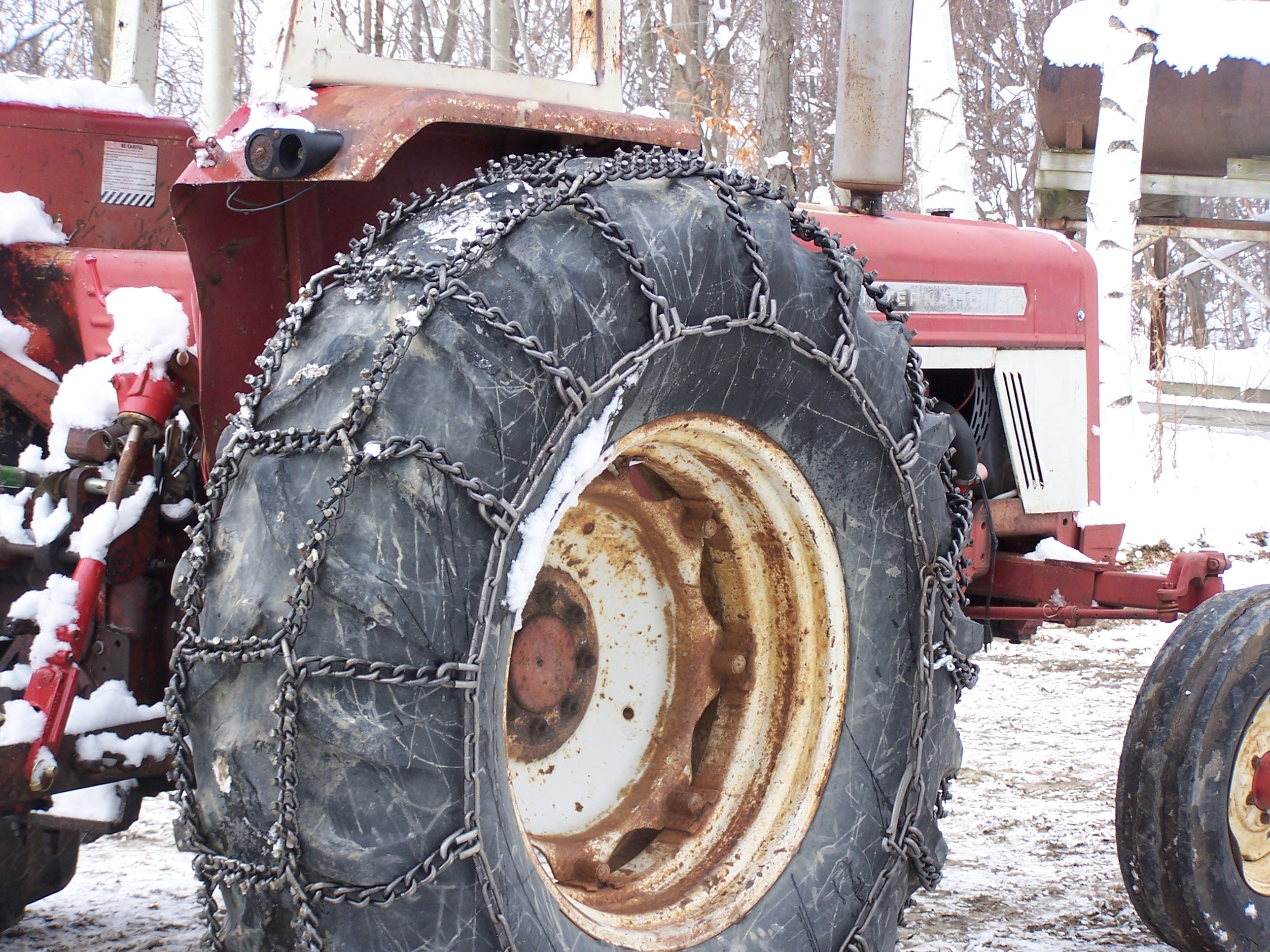

I like the old Oliver tractors, the transmission shift pattern could have used some help.
However I believe the 1365 is the Fiat tractor, parts may be a bit harder to come by for that unit.
I'd say that an IH 706 or newer or the Oliver 1600 or newer would be a decent choice.
Chained up they will do a good job.
Even the IH 574/674 will work but they are not a series I'd recommend.
