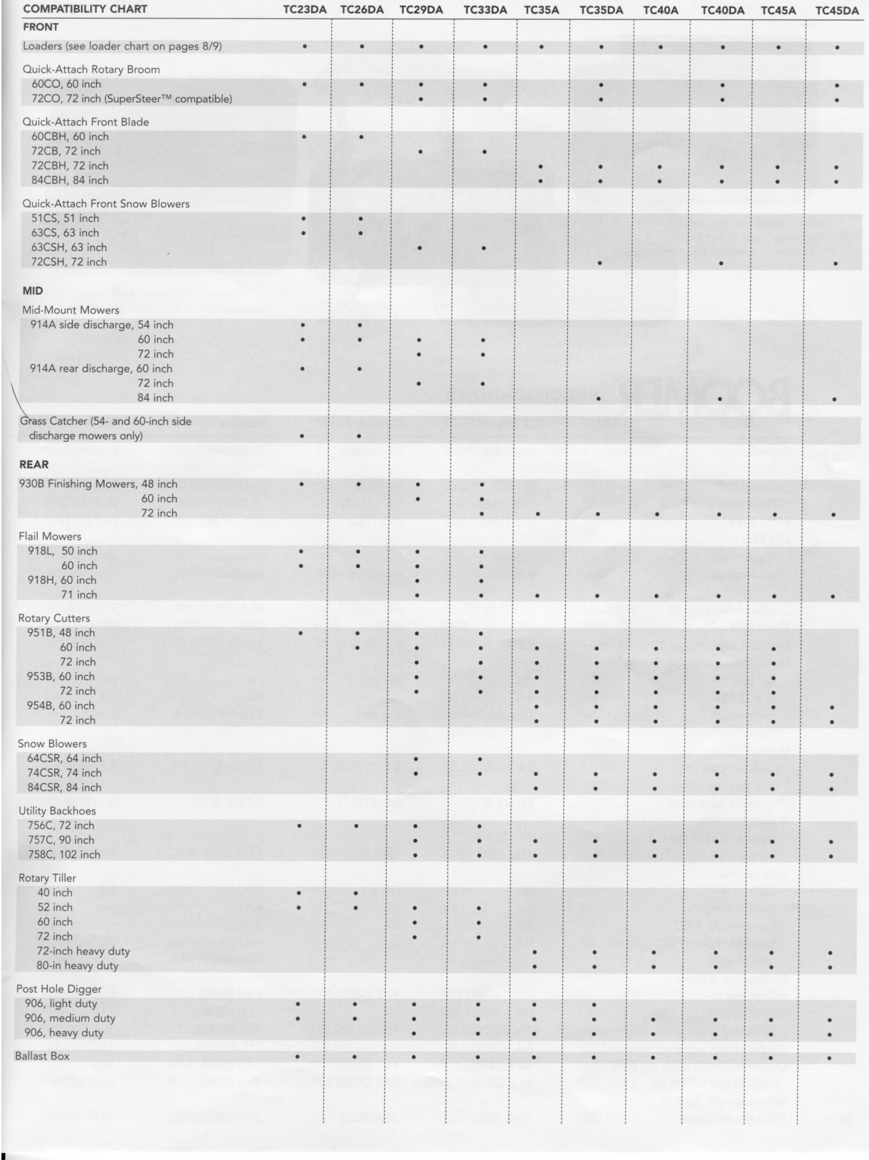

New Holland's site is hard to navigate as the information is buried beneath the Product Counselor, or whatever it is. Looking for implement sizes and such, like how big a flail mower can each one use, etc. Or a generic site that has that sort of information compared to engine and PTO horsepower.

I doubt you will find implement sizes listed for each tractor. Instead.. figure hp, DB hp, or PTO hp.. then figure out your implemnt needs based on what the implement manufacturer reccomends for their equipment.

Some of NH's Sales & Marketing (hardcopy) literature contains information about what size attachments are compatible for their different tractors. Jay

Look in the products section there is implements listed and what tractors should pull them.There is only 10 or so listed.

I scanned a page from one of the Sales & Marketing brochures I have. Hopefully this will help to some degree. Jay

Thanks, it does help a bit.

remember there is a frame size change between the TC33/34 and the TC35
