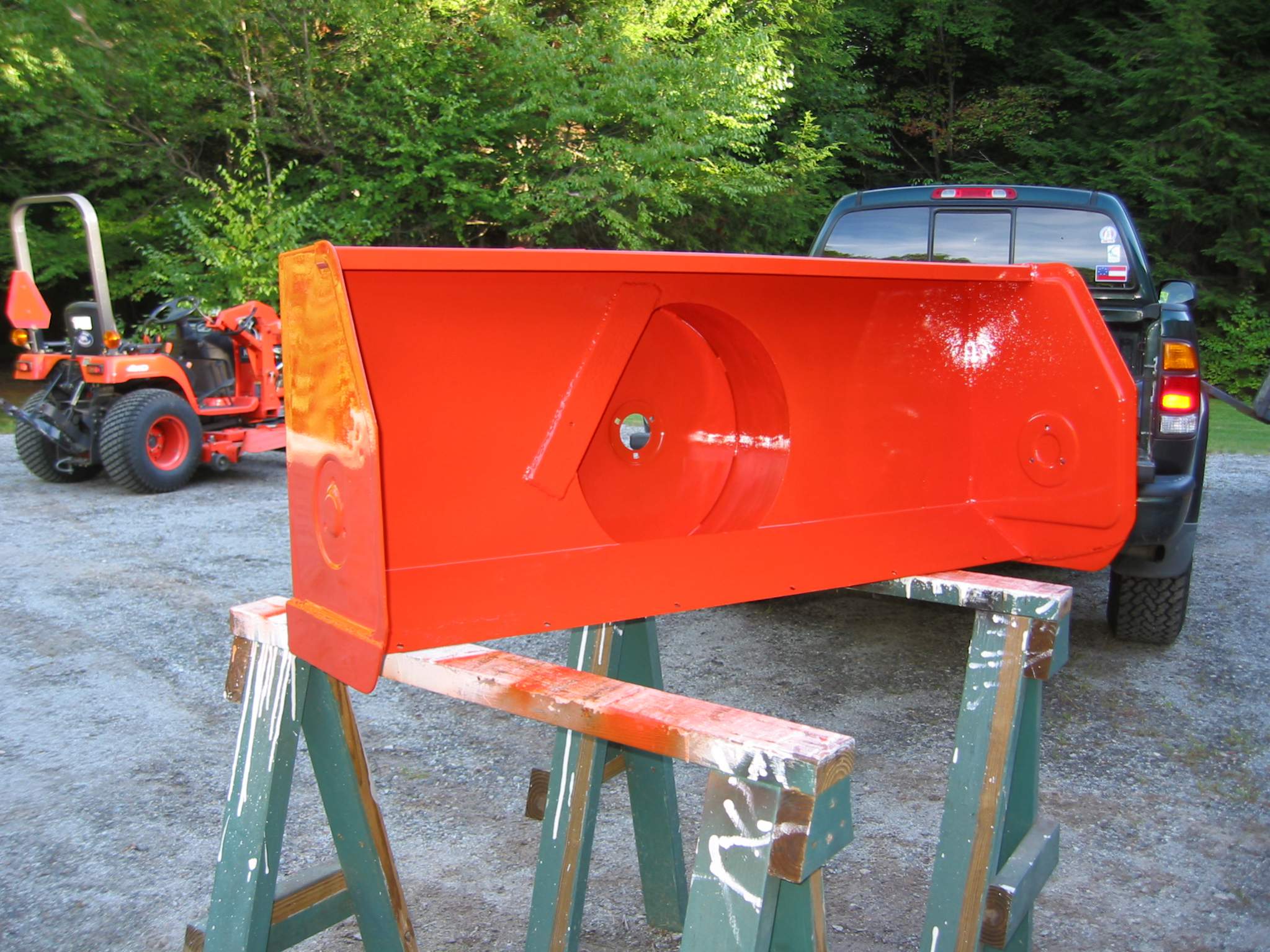

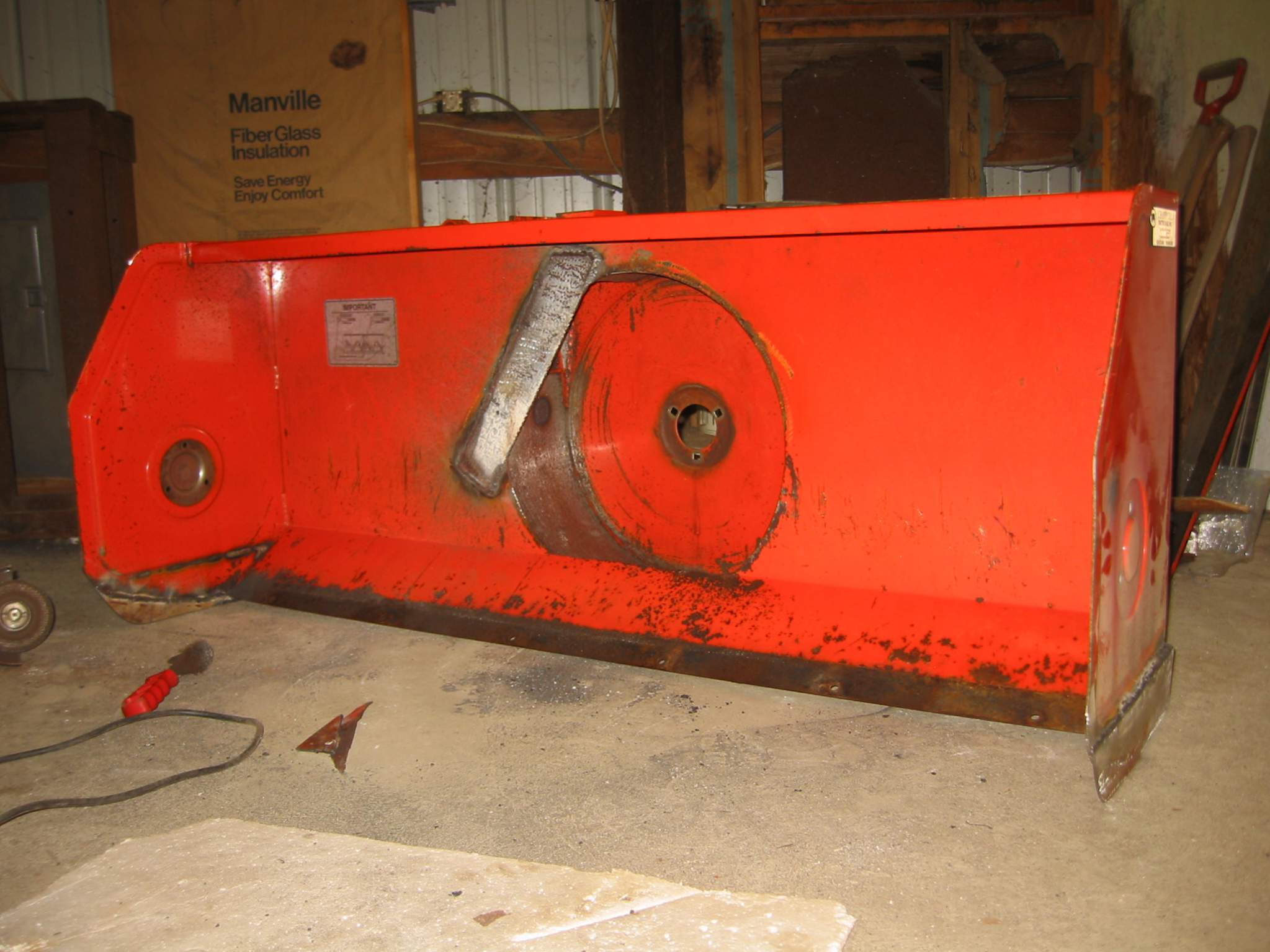

Incidentally - here's a before (during, actually) and after shot of the carcass...
