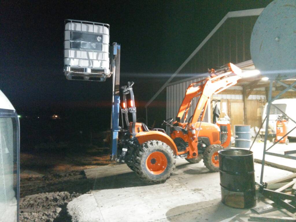

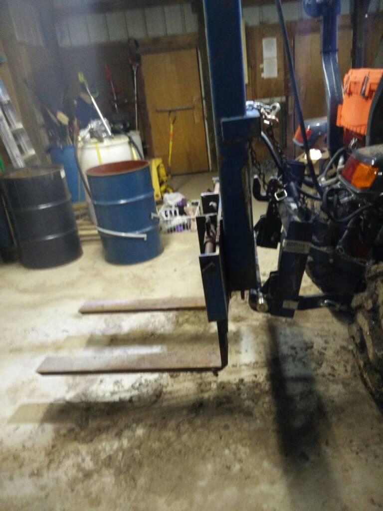

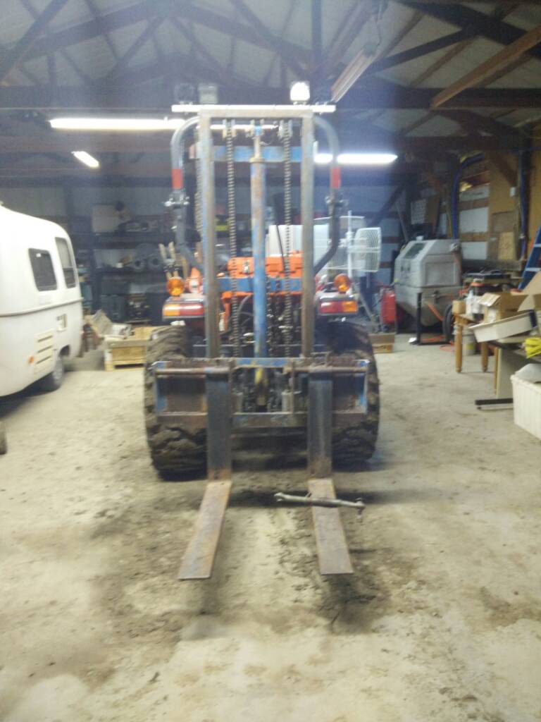

I just sold my 3pt forklift. It had a similar or better range than my loader. But with the extra weight of the forklift (500lbs maybe) my 3pt couldn't end up lifting much more than the loader & forks (IBC tote a little over 1/3 full of water). The forklift didn't even flinch lifting things, but my 3pt stopped lifting. I didn't want to push it & break something on my tractor. It lifted a ton or so & guess it might have been able to lift 2 or so, but my 3pt stopped lifting around 3/4 ton. I probably could have gained a bit taking off my quick hitch, but I'm lazy & like the ease of the quick hitch.
Bought it for $200, put new hoses on & ended up selling it for $300. Really haven't seen many on Craigslist in the past year or so. There is another for $900.

Did your forks have a mast like a forklift?
   / Looking for Combination Pallet Fork for 3PH & FEL #6
   / Looking for Combination Pallet Fork for 3PH & FEL #7
How well did that work? I have been thinking about building something similar. I have an old forklift mast laying around.
   / Looking for Combination Pallet Fork for 3PH & FEL #8
Could have origionally been off a forklift for all i know. It was chained to the quick hitch ontop because my welding for a temporary quick hitch compatible toplink bracket sucked.
