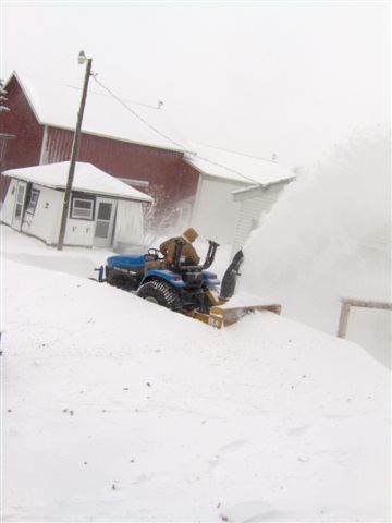

If it is enough snow to be blown, it will be too much for a 60" on your tractor. We had 3 ft of hard drifts and my TC33D worked to crawl through it with a 60" blower. It will all depend on the type of snow you plan on using it in.
