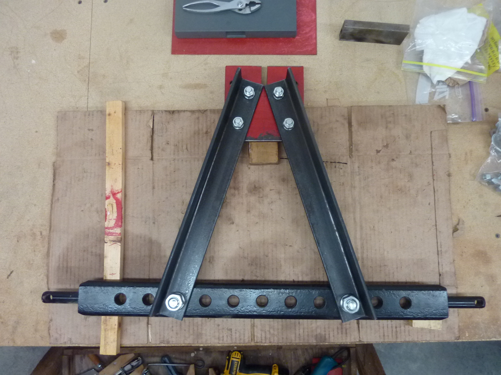

I need to fit the weights out back on the B7200 in anticipation of mounting up the front mounted snow blower for the winter season.
Last year I cobbled up a 2X4 that laid across the 3 pt lift arms, held on by all thread and baling wire.
This year, I'm making a trailer ball/ pintel hitch 3pt attachment that also carries the Kubota weights. Those things are bulk!
Looking for any ideas from those who might have done the same. (Note: a simple flat bar will not secure the Kubota weights. BTDT ;-)
I'm thinking on the lines of building off something like this
but built on a typical CAT 1 implement bar.
   / Looking for ideas on a 3pt KUBOTA 55# suitcase weight holder. #2
I don't know what a Cat 1 implement bar is but was wondering if a Cat 1 Cross Draw Bar would be useful. I used one as the cross member on this A-frame. Available at Tractor Supply.
gg
   / Looking for ideas on a 3pt KUBOTA 55# suitcase weight holder. #3
I had the same need last year with my Cub Cadet Yanmar. I bought a generic 3-pt receiver trailer hitch and added six 42lb suitcase weights as seen in the attached photo. I usually run a ratchet strap around the weights just in case. The weights are from heavyhitch.com. They shipped them to my local Fastenal industrial supply store CHEAP.
