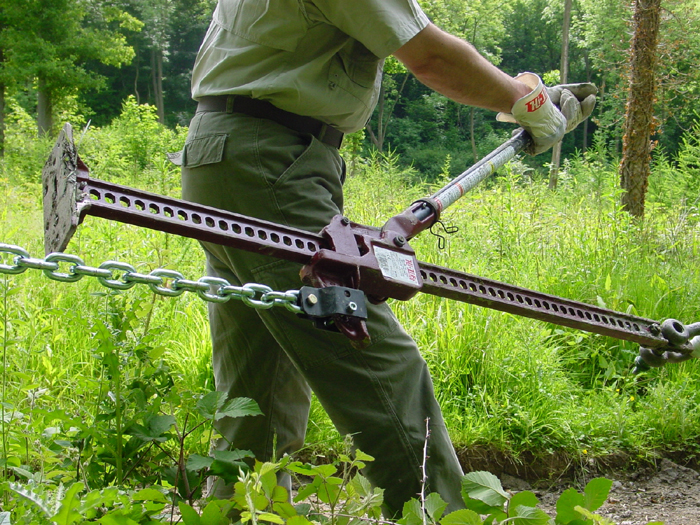

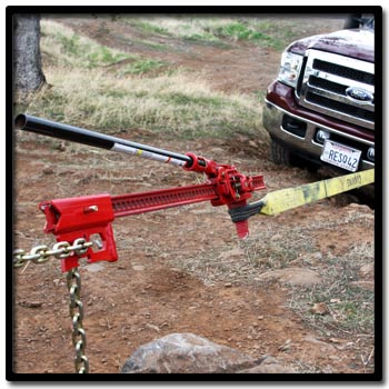

A Hy-Lift Jack and a chain will also work to get you unstuck.
   / Looking for information on a block and tackle #7
And can lift your car, truck or tractor too- if the ground is firm enough to hold it... This can be helpful at times to put materials underneath the tires to add traction.
Also it can be less of a PITA to work with than the cable puller, though it moves less each time before resetting.
Unfortunately I never think of it for that....
