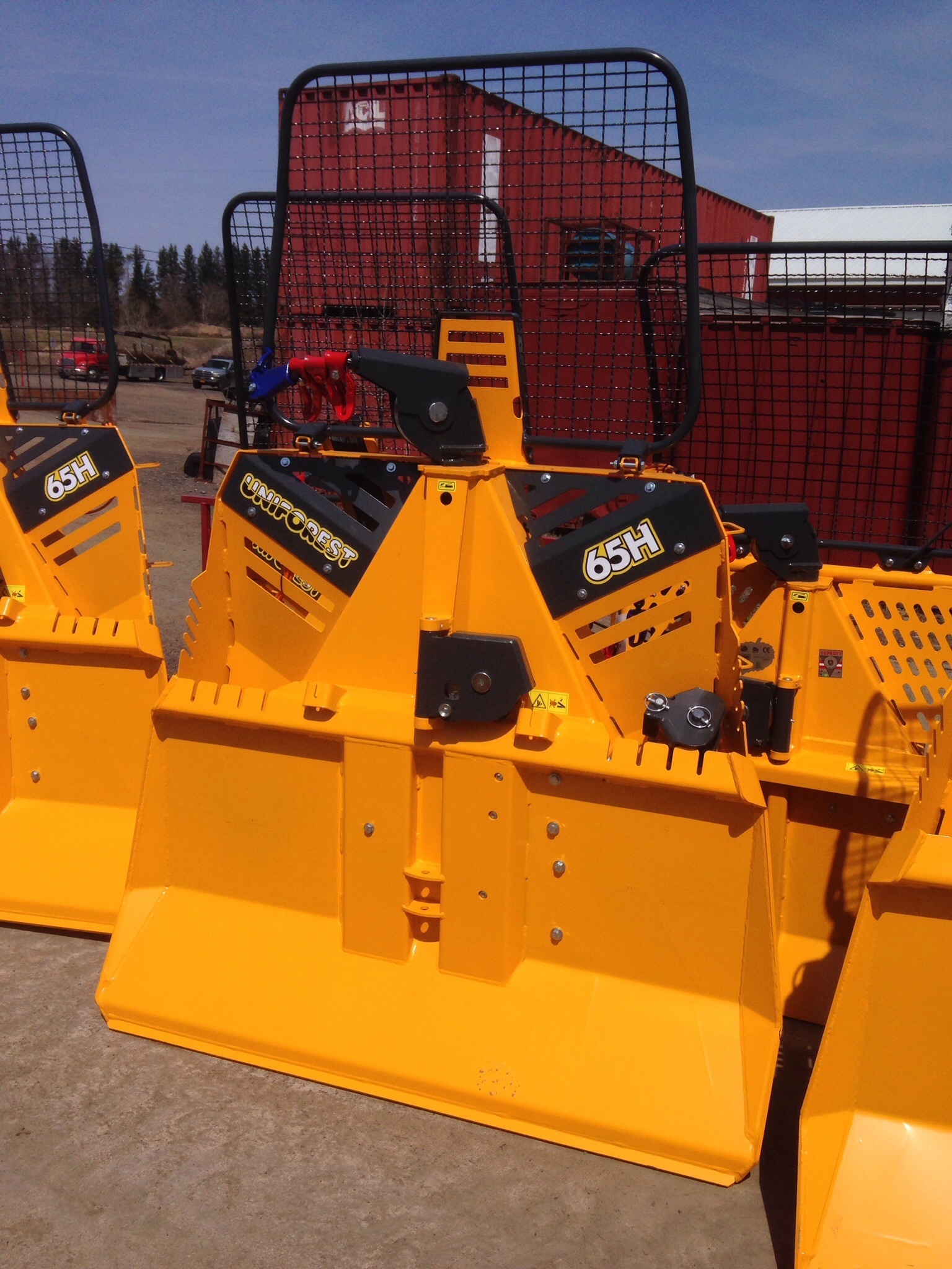

Thanks for the replies. Went to Hud-Sons today and looked at the Uniforest. Terrible place to go for an attachment junky as myself. Now I want a firewood processor, portable saw mill and a really neat swivel Uniforest grapple that fits the 3 pt and front Quick attach to start!

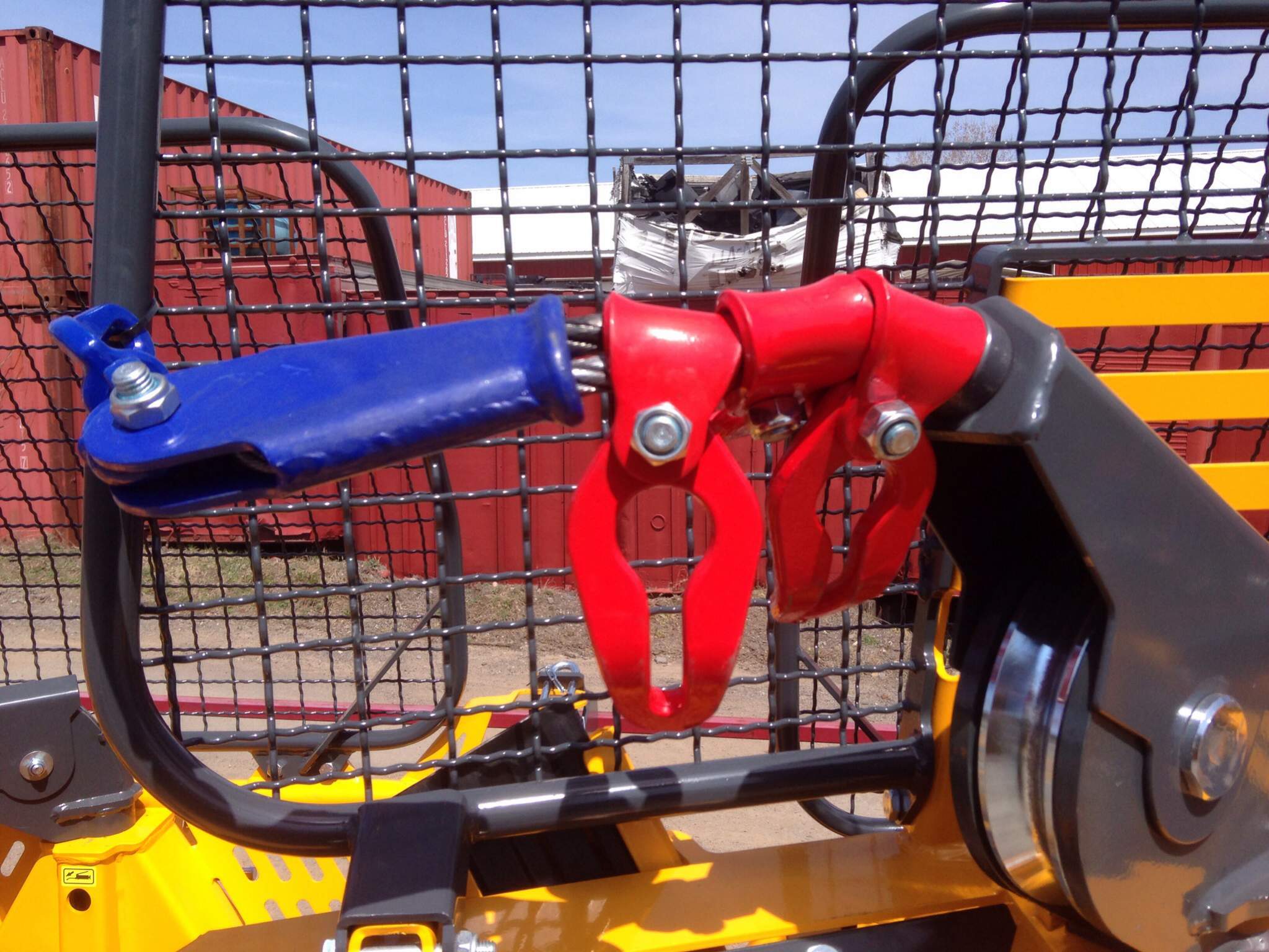

The skidding winch looked great. Comparing the 65M and 65H I really liked the H version. The Manual version was nice but the ropes to engage/disengage the clutch looked a little hokey compared to the hydraulic version controls.

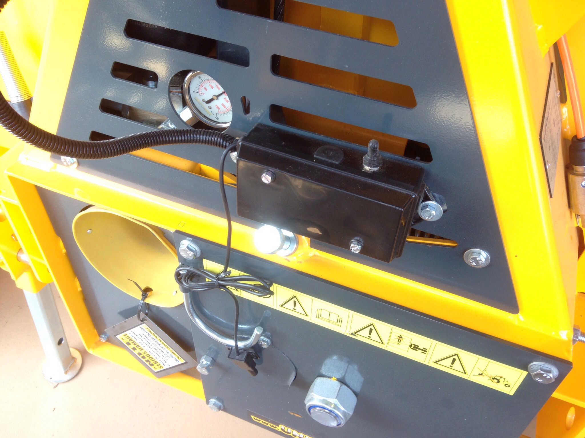

The hydraulic version comes with the wired control and a wireless remote. There was a plug in the back of the unit that the hand control plugs into or if you want to use the wireless you plug that in. I took a picture of the wireless box on a unit in the showroom, they hadn't installed them on the outside units yet.
For power there was a 7 prong plug that goes into the back of the tractor, so that was pretty slick. Also there was a chainsaw scabbard on one side and a place to hold an ax/pick on the other. All in all I was pretty impressed and I think a 65H is in my near future!
