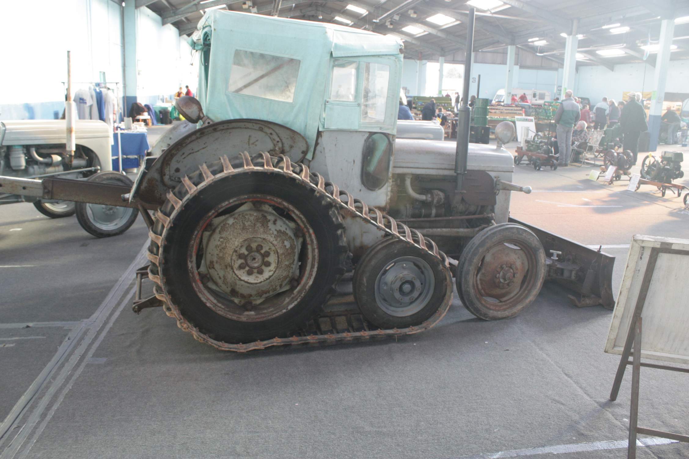

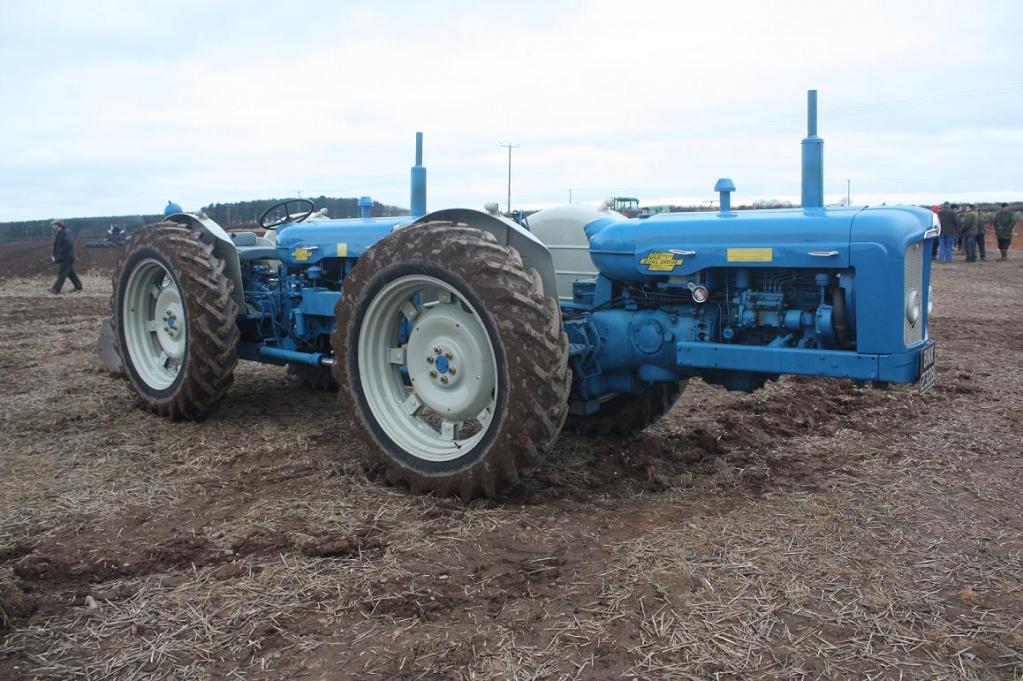

my guess traction is your desire,
back in the 50 and 60 there were a lot of inventers that were trying kits and ideas, just to do that duels were probly the easiest solution,
but some "half track" kits were made and built,
also some made a kit to tie two tractors together in an early articulated 4x4 unit,
I am sure neither is what your looking for but it is most likely a more doable option than a "4x4".
