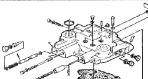

One should be able to check pto hyd pressure on trans shift cover similar to photo. Pressure should be in the 155-165 psi range. My WAG is an oil supply tube to pto clutch is leaking.

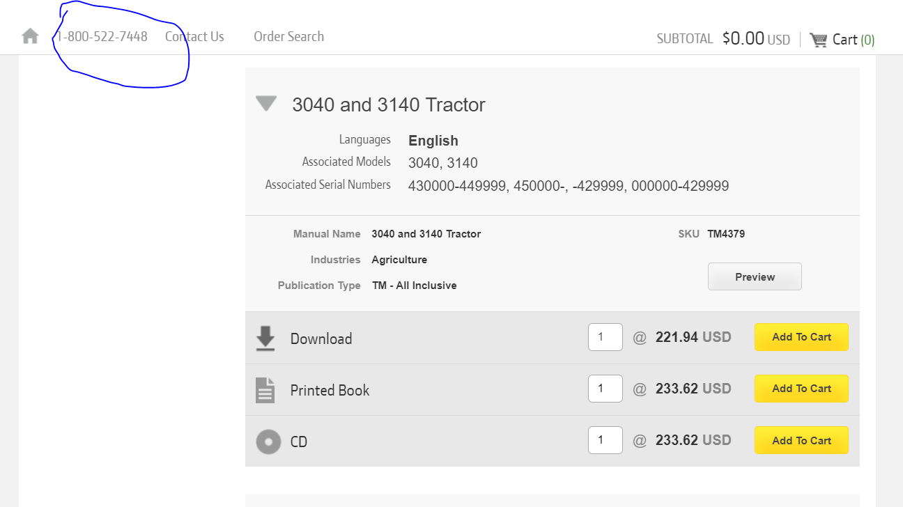

Its France. it was on the plate. We ordered the Service Manual on June 25 form England. :thumbdown: it has yet to arrive. Any suggestion on where we can by and download one online?
   / Looking for John Deer 3040 Shop Service Manual #8
You can order straight from JD & download.
