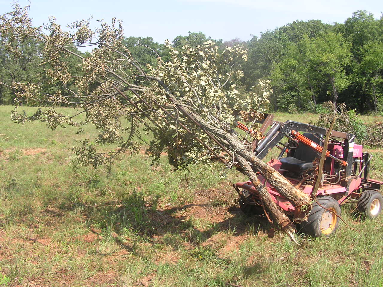

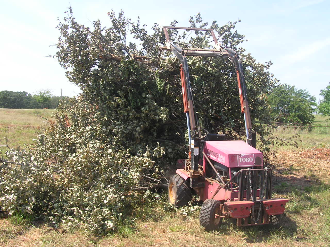

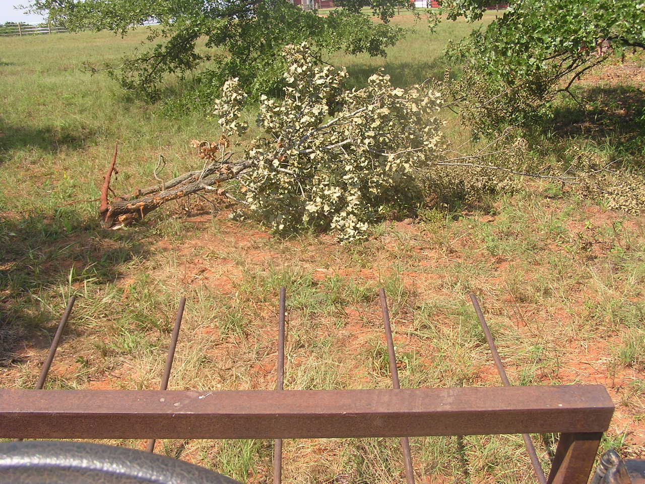

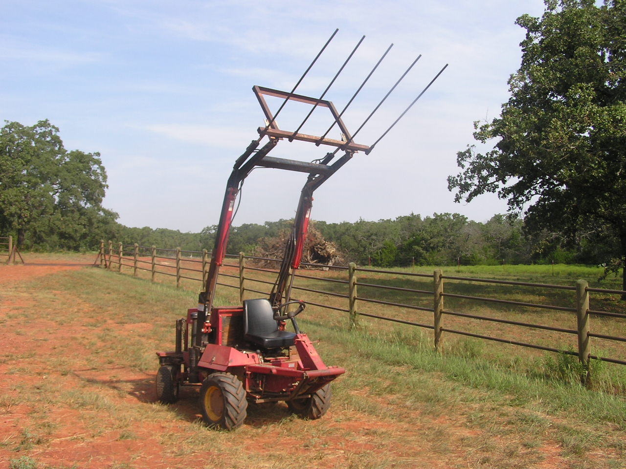

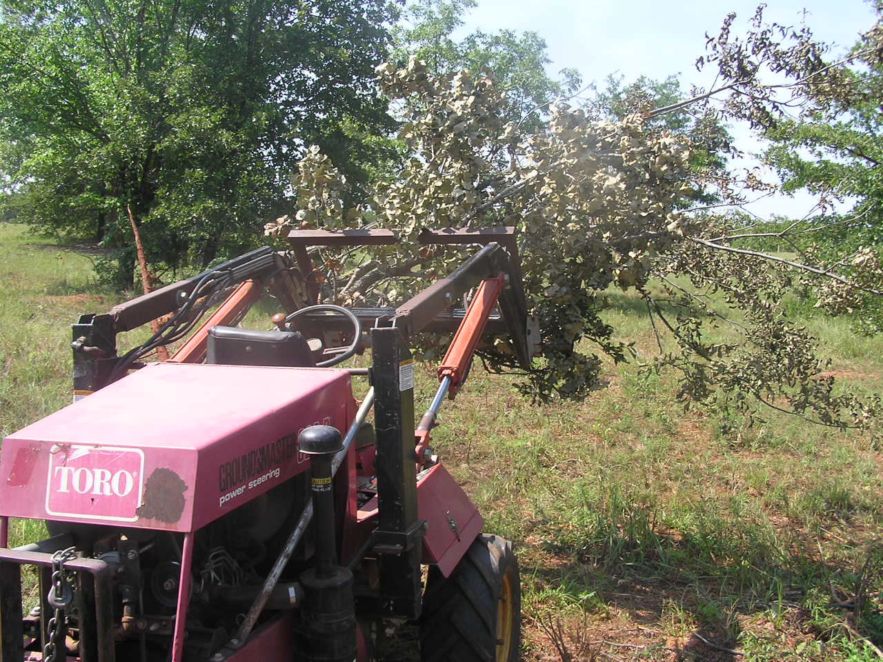

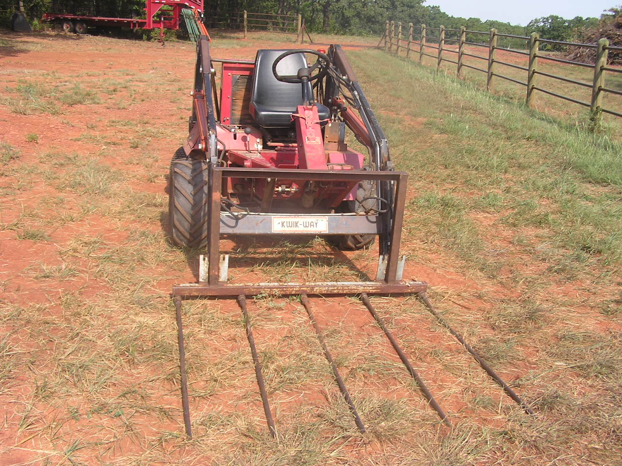

I recommend building some type of quick attach for it. I wish I would have done it when I put mine together: http://www.tractorbynet.com/forums/customization/272163-fel-toro-groundsmaster-put-together.html
Back then I didn't know that I would end up with so many attachments for it.
This brush fork is one that a use a lot.
The view from the seat.
Picked it up.
The burn pile.
Let us know what you come up with, since there are a lot of guys wanting to do the same thing. :thumbsup:
