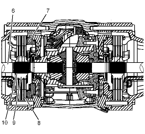

looking for rear brake bleeder for 420E cat backhoe location please help
   / looking for rear brake bleeder for 420E cat backhoe location please help #1
goodybrain2001
Sep 26, 2012
1
Ottawa Canada
2008 420E cat backhoe
Looking for rear bleeder location for a 420E cat backhoe.
   / looking for rear brake bleeder for 420E cat backhoe location please help #2
If you are referring to the air purge screws they are on top of the rear axle on each side of the differential. If I have uploaded this correctly, it is a cross section of your axle. Item 7 is the brake piston. The air purge screw should be on the top side of the axle housing, one on each side.
