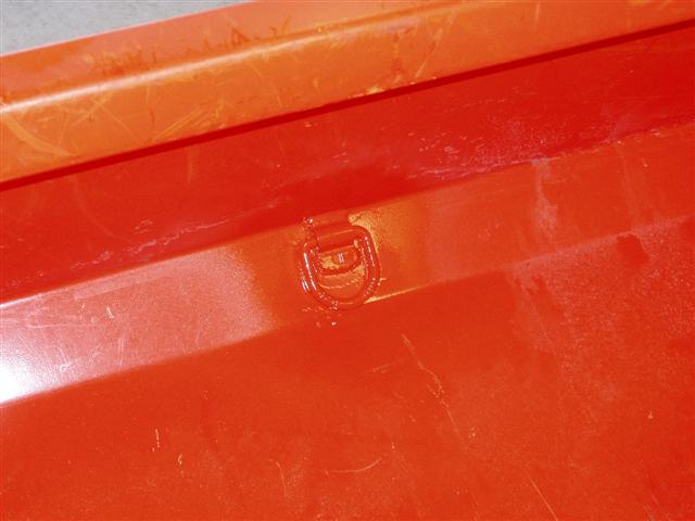

I don't have a hook on my bucket but I do have a ring welded inside that I can hook a chain to. This arrangement allows me to lift heavy objects very near to the loader arms for maximum lift capacity when the bucket is curled down. I can also lift things more forward when the bucket is curled back. I got the ring at a truck equipment shop. They are normally used as tie down rings on truck and trailer beds. The location that I have it welded to is very strong since it is at the bends in the back side of the bucket. I don't expect to ever damage the bucket this way. One of these days I also plan to weld some chain hooks on the top lip in the location on the loader arms. A simple peice of 1/4" angle iron about three inches wide welded to the lip and the back edge of the bucket should be enough reinforcement to keep the lip from bending. Others have done that as well as welding a piece of angle iron along the entire top lip of the bucket and then welded 3 or more hooks along the top. Lot's of ways it can be done. It is very helpful to have a place to connect a chain to your bucket as it sounds like you have found out. Good luck.

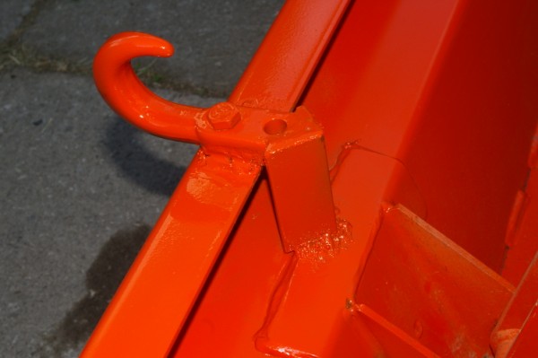

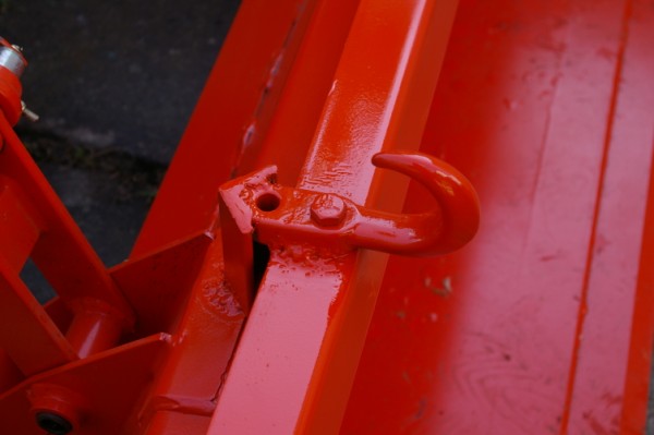

This is what I've got. The first pic shows the center hook the dealer mounted on angle iron. I like the angle but dislike the style and position of the hook and plan on changing it. The outside two I just put on. They're good for up to 3/8" chain and with the loop on the back, good for small rope or s-hooks. They are just generic grab hooks from a Ace Hardware. I ground a small flat on the back and tacked them on. My welding skills are still amateur-ish but I enjoy the practice.

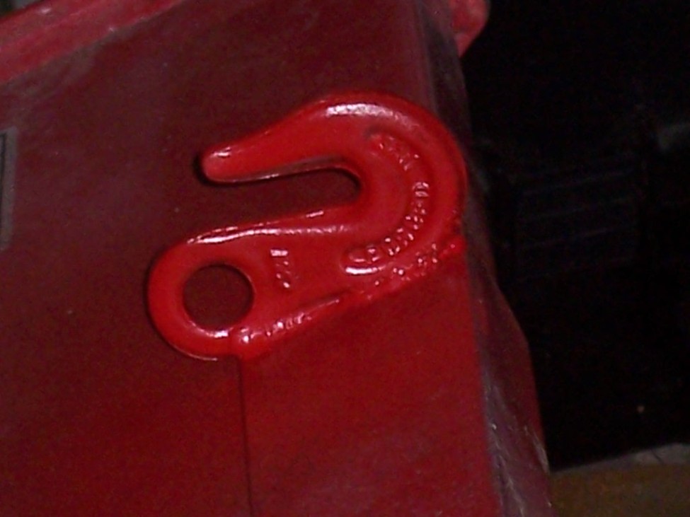

I welded a couple hooks on and used angle for reinforcement in a different way. Works for me...
