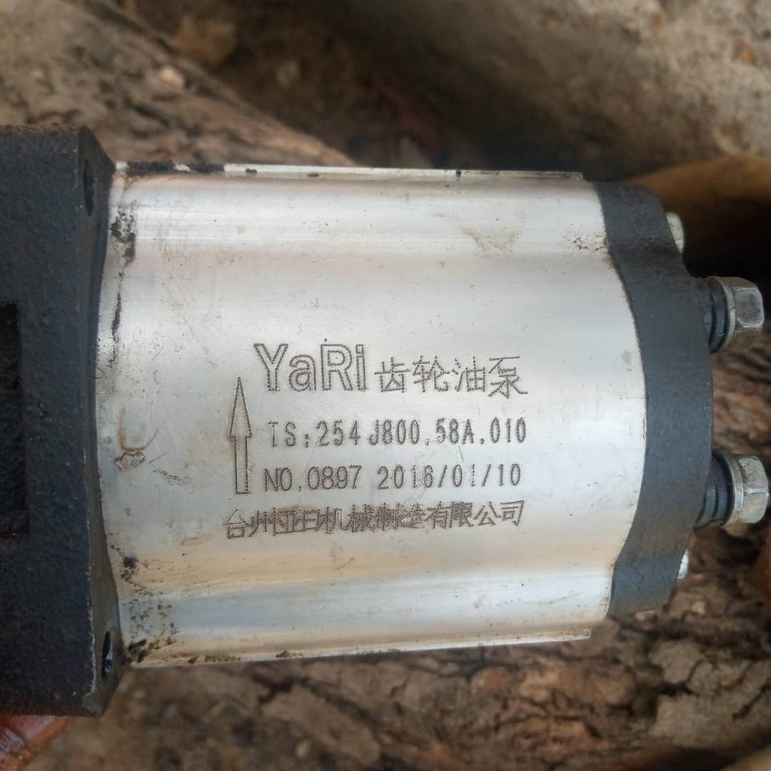

I have a Taishan tractor. The only writing on it is TS 804. The lifter hydraulic pump has been overheating, and my mechanics are not sure if it is the pump or the distributor. I have decided to change the two one by one but can't find this pump on made in china or aliexpress sites. Any help or any other tractor hydraulic pump that can replace it?

A picture of the pump could possibly solve the issue.
Is the drive keyed, tang, or splined? Is it two or four bolt mounted? Is the pilot internal or external?

Do you have a loader? Reason I ask is one Chinese tractor importer I did business with got the plumbing for the power beyond valve wrong and we had this happen 3 times before my mechanic called them on it. I couldn't tell you the exact layout now but everything "worked" just produced excess heat and slow failure.

HOW ABOUT A GOOD PICTURE OF THE PUMP?
   / Looking for Taishan tractor hydraulic pump YaRi TS254 J800 58A 010
The pump is spline, 6 bolts as well

I use a plough. I don't know about pilot
