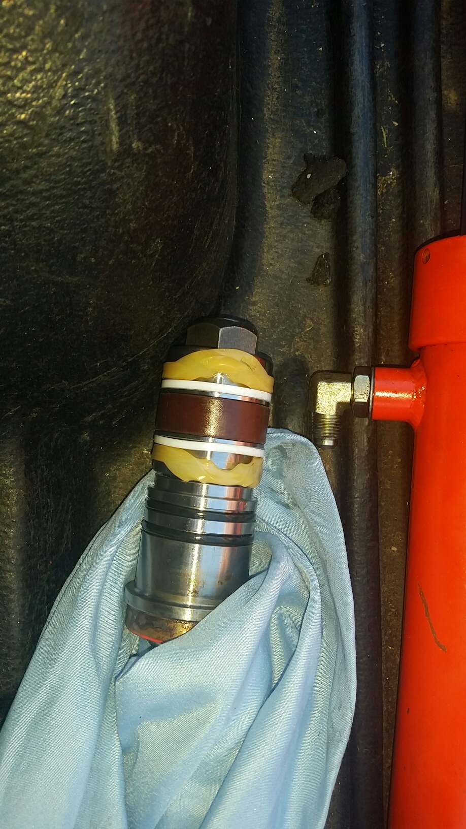

I am in the middle of repairing my 2005 Kioti CK25 KL130 loader 635 hours. I posted in the Kioti operating forum, "how a mouse nest turned into a can of worms", while installing the hydraulics for a grapple, I found cracks in the torque tube of the loader, since I had it all apart, I figured what the **** i will look at the cylinders as well.
So I found the seals in 3 out of 4 cylinders are trash. See photo. What I am looking for is any information on the torque spec on the nut at the end of the rod.
Thanks

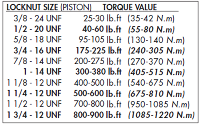

Torque specs are found in many places on the www. Some are very comprehensive in defining what is being torqued and under what kind of conditions...like fastner "grade-marking", wet-dry, new-rusted, fine-course thread........
   / Looking for torque spec #3
Here is torque chart from a Hydraulic Cylinder repair guide that I have (use at your own risk!:)

Thank you for the information, very handy. A copy is now pinned to my shop wall!
