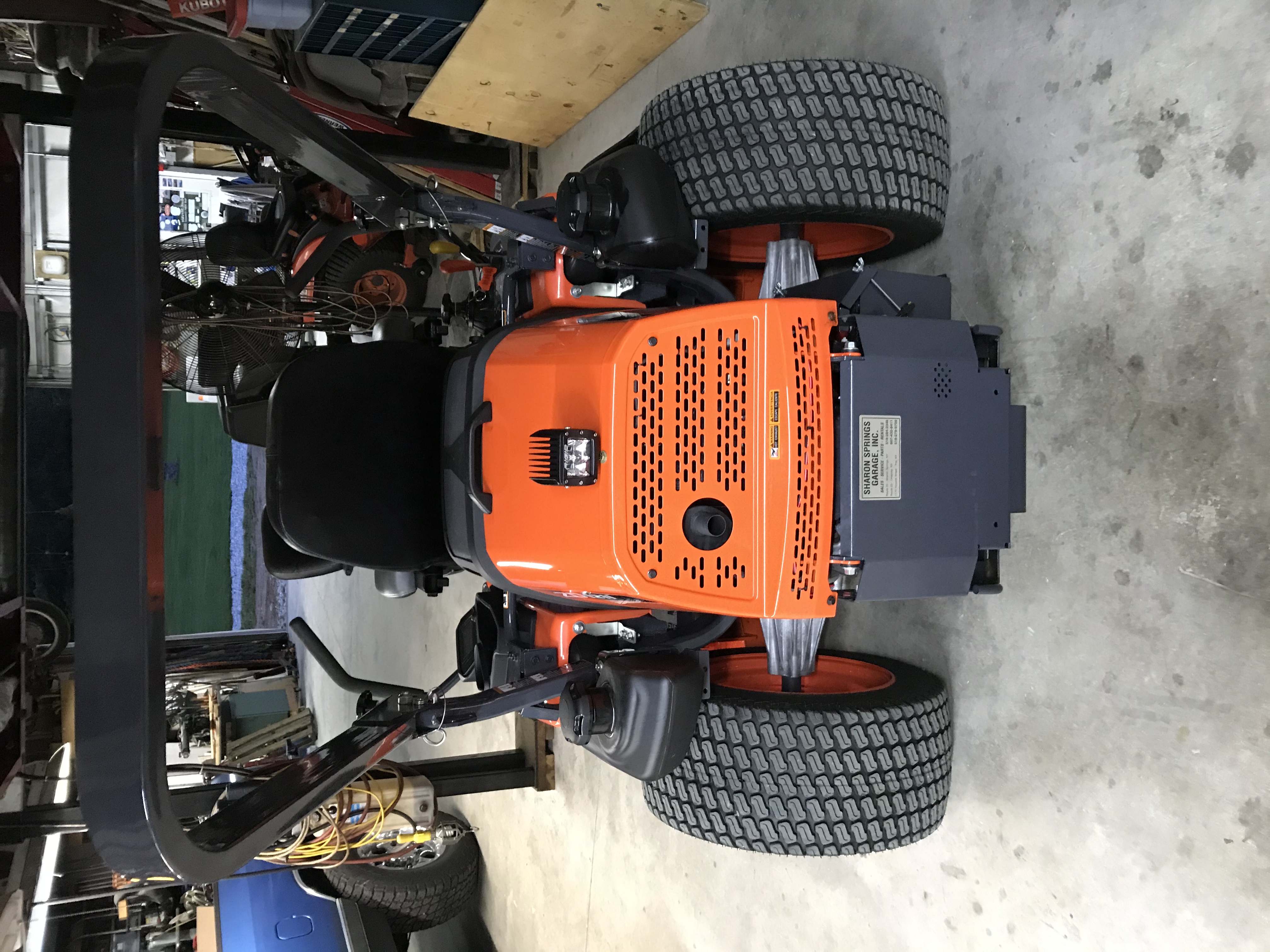

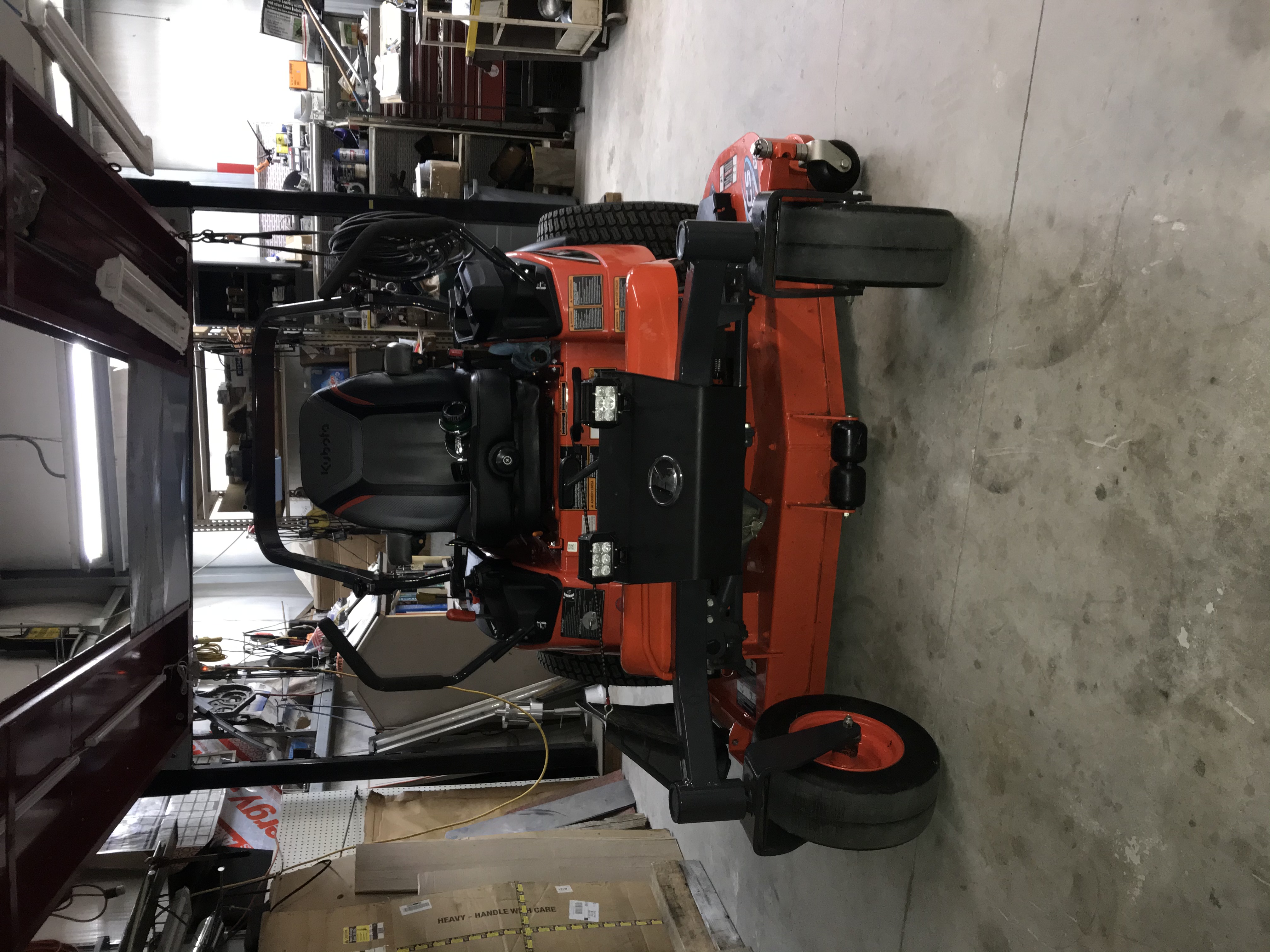

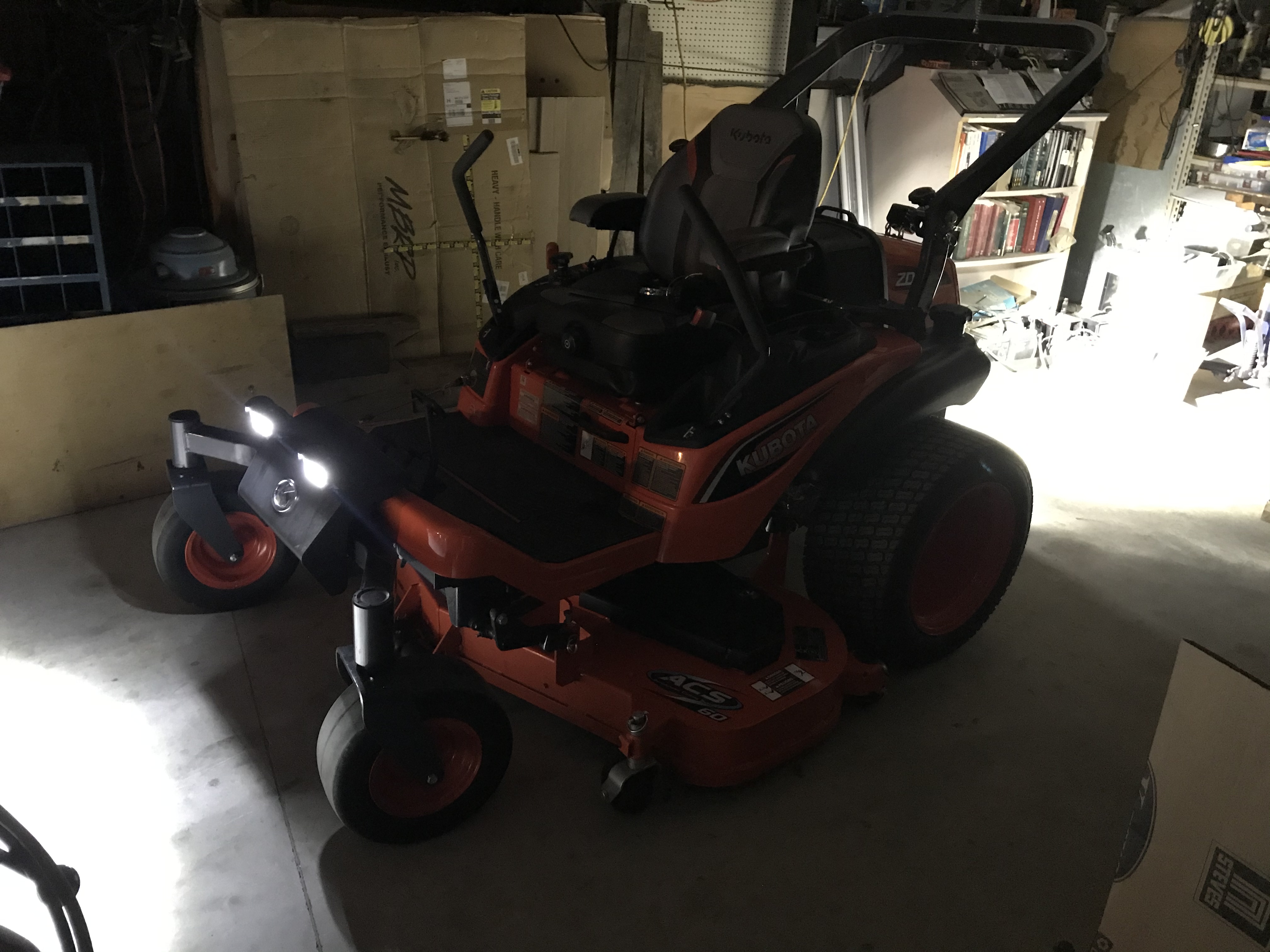

As mentioned I found the power for auxiliary lights and I finished the installation of two LEDs in the front and one in the rear.
I have not used them outside yet but they throw decent light in the garage.
The charging system capacity is only 15 amps so I check the current draw which was 5 amps.
Looking forward to mowing in the evening.
