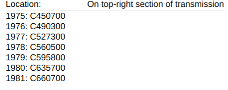

I just acquired a Ford 4600 tractor. I'm trying to determine the year but some of the serial/model numbers are illegible. Numbers I have:
6k18B
G70k22
DSNN6015G
D5-NN-7006 H
C5 or G5 22287
B(unreadable)214c
   / Looking for year of tractor #2
Here is the serial # info from TractorData.com Ford 46 tractor information.
It looks like you are missing one of the serial # digits.
Steve
   / Looking for year of tractor #3
If the first # you list is unit code 6 is for 1976 year model. K is the month which is November. 18 denotes the day of production. B is the 2nd shift.
