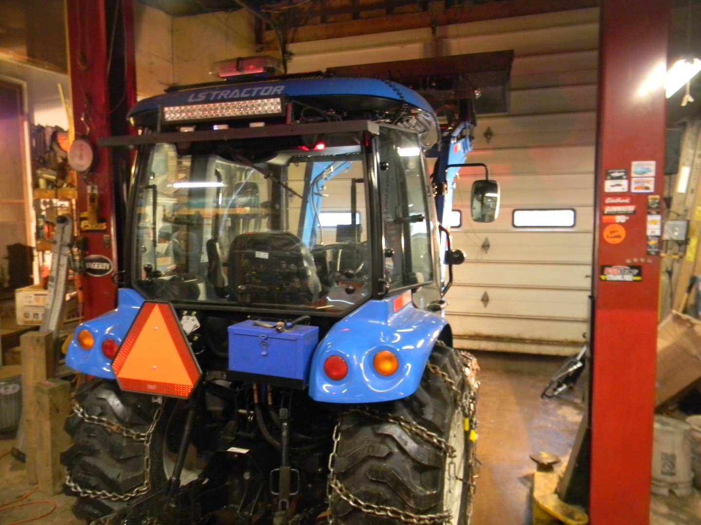

There is at least one XR3037HC owner on here that bought the front mount blower. I couldn't justify the price of a front blower so I built my own QA power angle plow and have a pusher blade. Been using the bucket lately to move back the snow banks.
We also have had lots of snow this year and I'm glad for the heated cab. Many below zero days out plowing and had to take off my coat in the cab it gets so warm.
I think you are out of luck finding a cab tractor that will fit under your 84 1/2" door. My 3037 is about 95" tall due to my addition of an LED flashing strobe.
