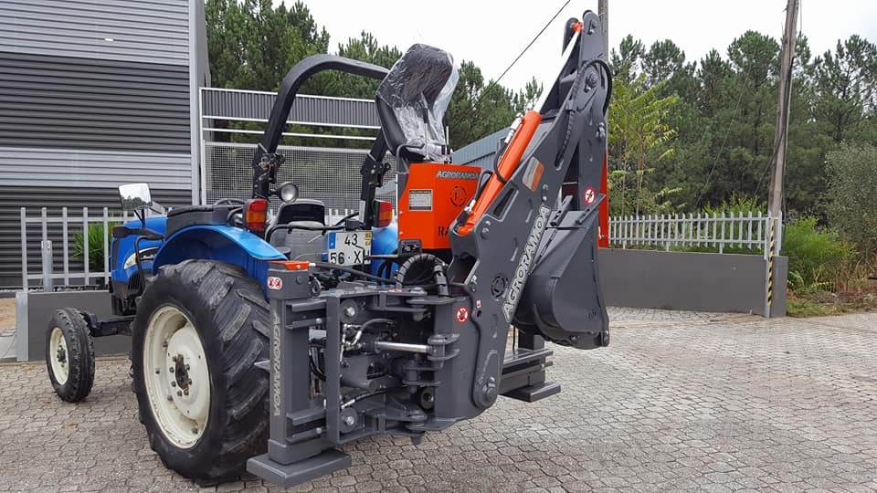

I am now searching for a small backhoe. NH has One that i fell on love with it but for some reason i cannot find its price anywhere and i dont know if it fits the Boomer 25:
Looking at the operator no wander you fell in love... looks really tempting, go for it, forget the backhoe ;)

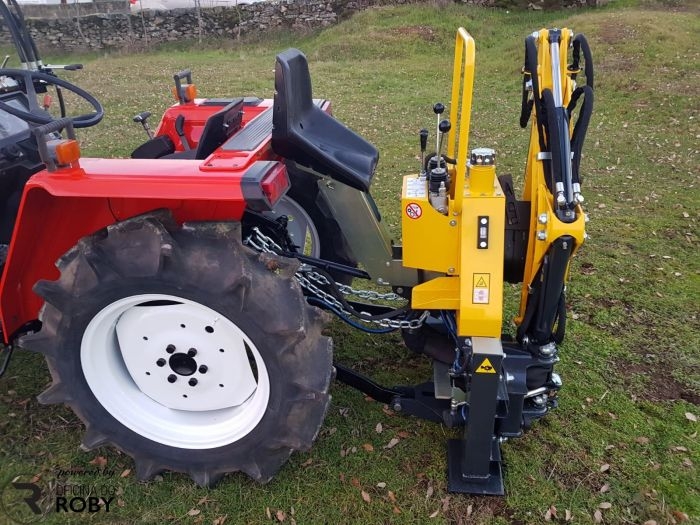

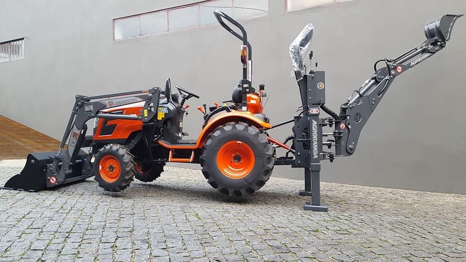

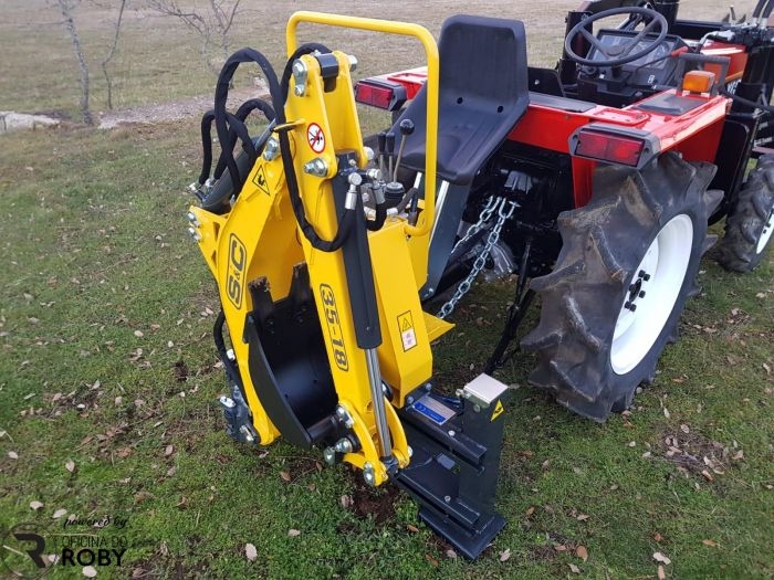

Congrats on the new tractor. It's made by LS but you can get parts both ways, either New Holland or LS if you end up needing.
For the backhoe, you won't be able to find that model "in this side of the pond" and it's only meant for the US market. You'll find something very similar though, just different brand and paint.
If you can, I suggest that you get one with sideshift on the boom if you can find it for that size of tractor. This is a great feature because you can then often the arm one way or the other so you don't have to dig with the arm right in front of you, blocking the view. It also allows you to dig close to a wall. Plus, you can ofset it to one sid and fold the arm all the way, making for very compact setup.
Either way, you'll need counterweights for the front of the tractor.
Some examples for mini tractors:
View attachment 826856View attachment 826857
Some sources:
Those backhoes with side-shifting stabilizer legs look to be even more useful than the type with centered swinging stabilizer legs we usually see here in the USA.
Perhaps sideshifters they are available here as 3pt attachments, but I've not seen an example for sale.
I do see them on commercial hoes and I believe that some hoes can be ordered as side-shifters - but for some reason they just did not catch on.
On our acreage for the past 40 years, we did most of our backhoe work - including putting in a pond, septic, and several foundations - with a 3pt tractor the size of that little Boomer and a 3pt hoe. Eventually we figured out that there were just too many advantages to dedicated backhoes. So after renting for awhile we bought real Tractor/Loader/Backhoes (TLBs) - a JD310 and a Kubota M59.
So.... 3pt hoes are useful, but are more or less defined by their limitations. They dig better than they lift - so are not real good for booming. Depending on the tractor they are mounted one, they can be dangerous And operators need to be conservative with them because a 3pt hitch not really designed for the forces that even a small 3pt hoe develops. Treated gently, a 3pt hoe they will save a lot of work. Treated roughly a 3pt hoe will destroy the 3pt connections to the tractor.
Still, it sounds like the OP is going to go that route, so my advice would be to get the side shifter and also look for a hoe that has a PTO powered hydraulic pump and reservoir of its own that is separate from the tractor's hydraulics. Both of those raise the cost, but are worth it in use and should be in resale too.

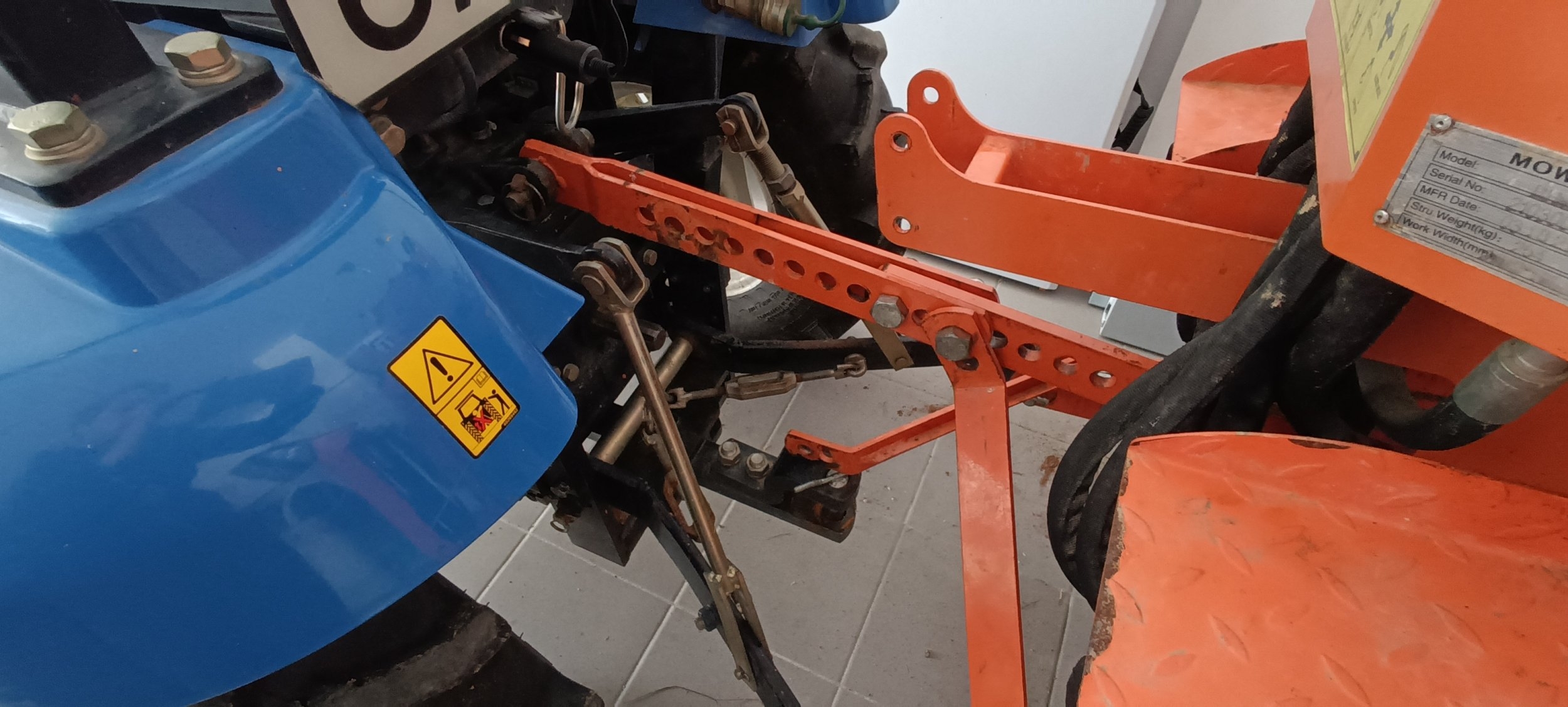

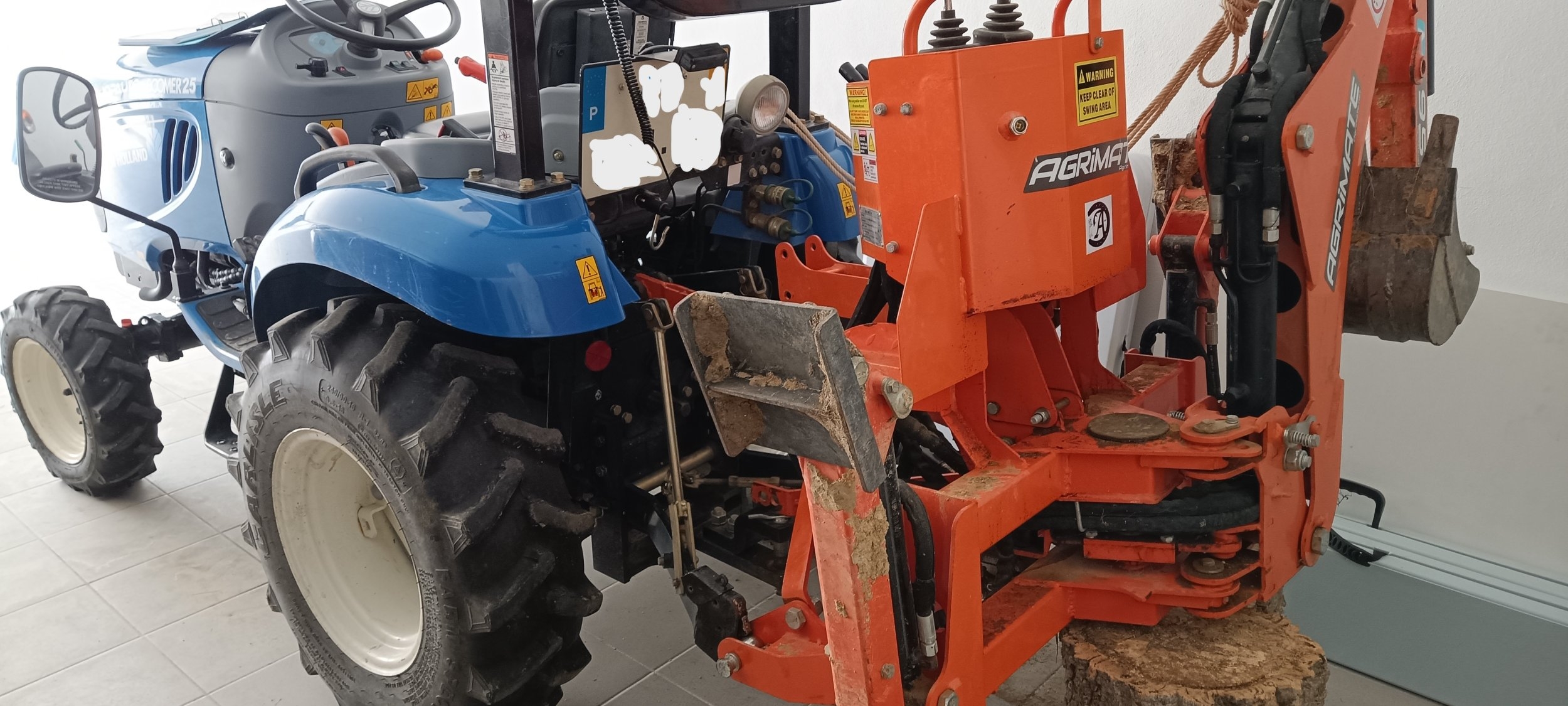

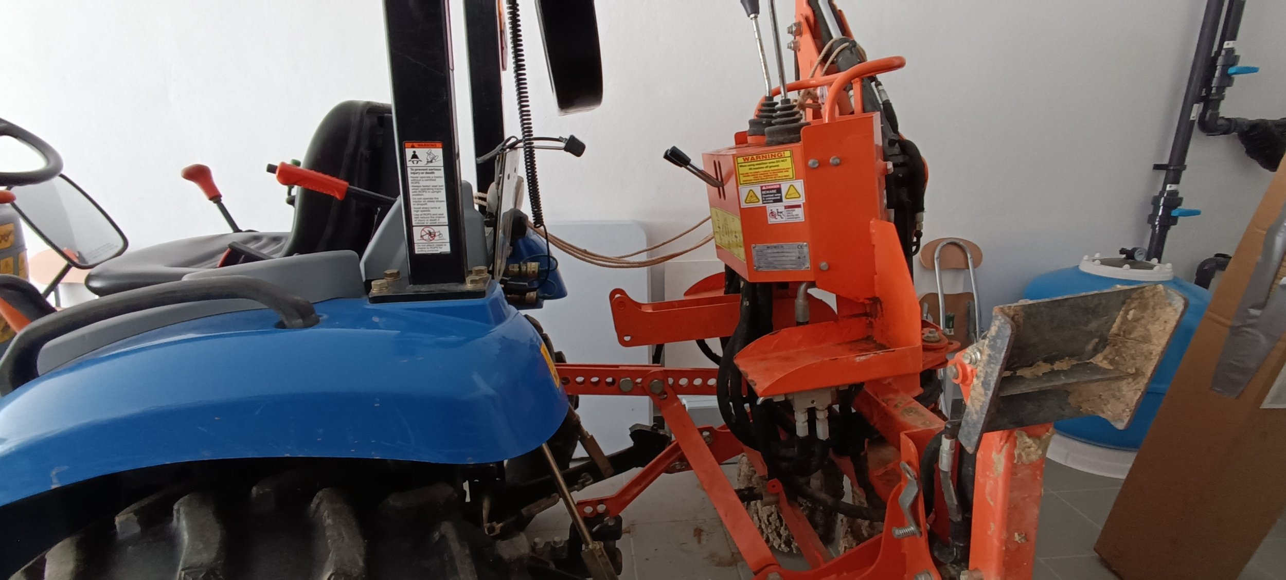

Hi everyone! Sorry not providing more updates, but the winter has been unusually rainy (even in this inner part of Portugal that doesn't get that much rain), so i've ended up not doing much with my tractor. In the meantime i had an oil leak in the steering system, which was found to be the rubber sealants in the near the front wheel knee.caps.
Now going to the news: i've bought a backhoe for my NH Boomer 25! 🄳
I've managed to get a "like new" one with about 6 hours of use, at a 40% discount price comparing to a new one.
This how it looks:
It is a chinese "white label" BH M95 model, for 15-25 bhp tractors. Small, but enough for my needs.
I am having a problem though: i cannot get it leveled. As you can see it is tilting towards the tractor:
Having analyzed everything, the culprit is this kind of "y-bar", connected to the 3rd point. It is too small, it should be like 7 or 8 inches longer so it will decrease tilt angle towards zero:
The thing is, i don't know how what is the name of this part and if there are longer bars. Do you know how it is called?

We would call that a top link. Did the tractor come with one? It appears what you have now came with the backhoe?
I opted for a hydraulic top link, so I can adjust it from the operator seat. But in your case a manual one would be fine.
I had a BH much like that years ago. Very handy. I bet you will like it.
Does your NH Boomer 25 have draft control? If so, don't forget disable it. Very dangerous...I nearly got squashed by mine one day when I put down pressure on the BH bucket and that activated the the tractor's 3pt automatic draft control.
Same problem with the top link. I found there was a longer adjustable top link in the scrap pile. It came off an old JD, I think. Much better part.
That's a nice deal on that backhoe. How does the tractor behave with it attached? Does the front get too light?
As far as the top bar, you kinda need that setup in place, since the two diagonal bars will prevent the backhoe from just pushing the 3 pt up. You may need to find a shop that can make a longer top bar or just extend the current one so the backhoe sits level again.
Yes, mine came with a top link, but it is too long (although adjustable, but still too long). It is clearly to connect with the plow implements and other "normal" implements. I tried with the backhoe, does not work properly.

Glad to know that this wasn't "my problem". I was thinking that maybe it was my fault on not getting this right. I guess the chinese were thinking on even smaller tractors when designing this backhoe. I'll try to see i can get an adequate top link!
It definitely gets the front much lighter. I have 60KG at the front and i think that may be not enough.
How can i figure out if it is pushing only the 3rd point? I have a quick hitch "ball" system in the lower points, it seems are very tight fit.

A short update on my last post about the top link to the backhoe: I've ordered a custom one, longer and a bit stronger:
