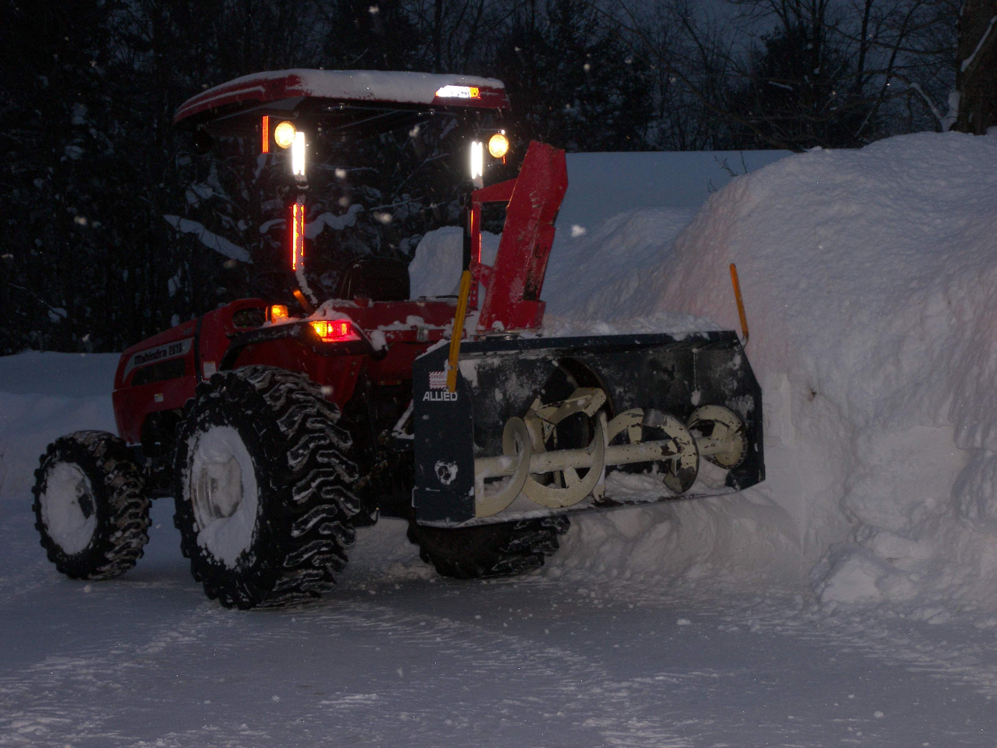

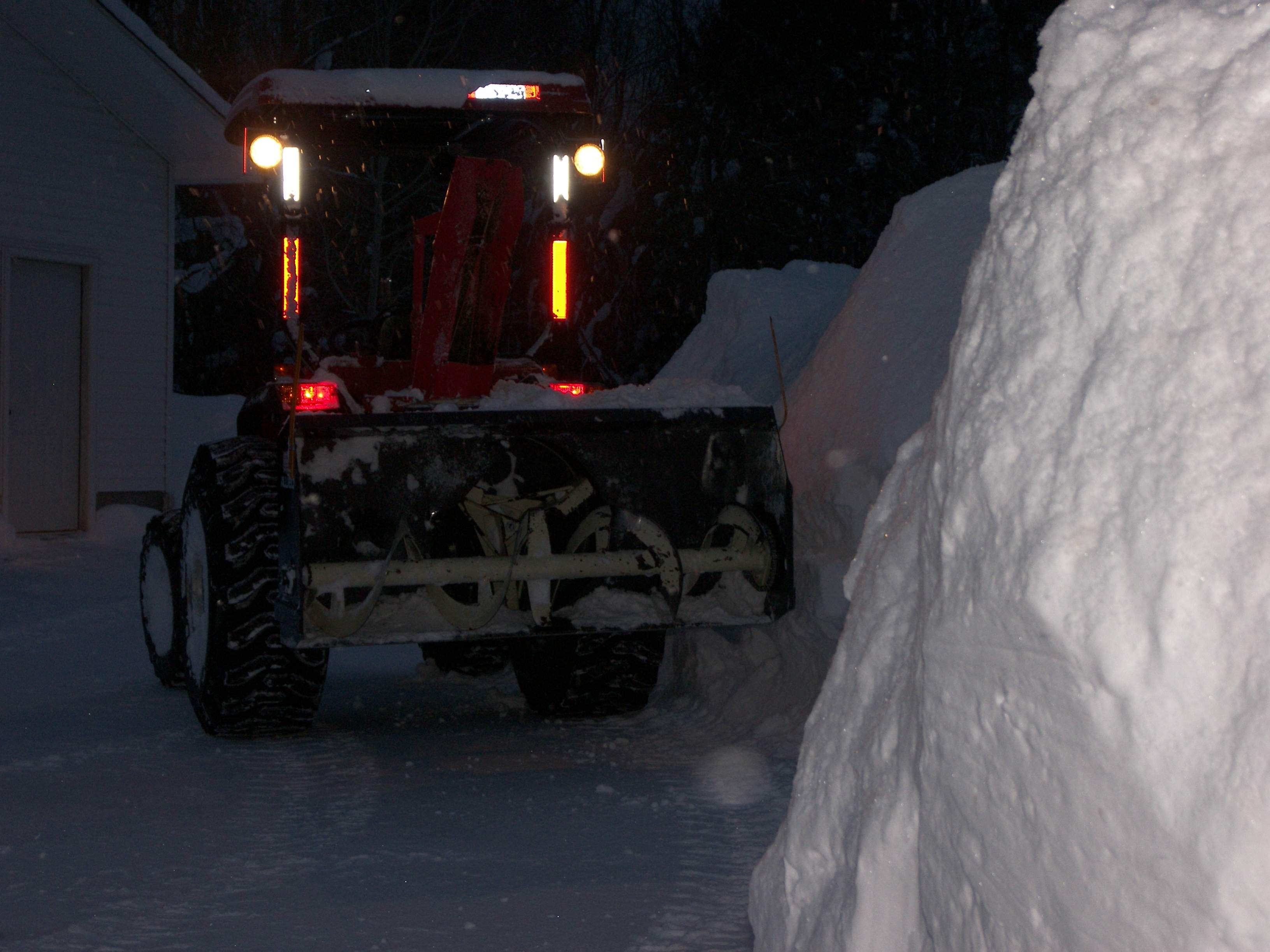

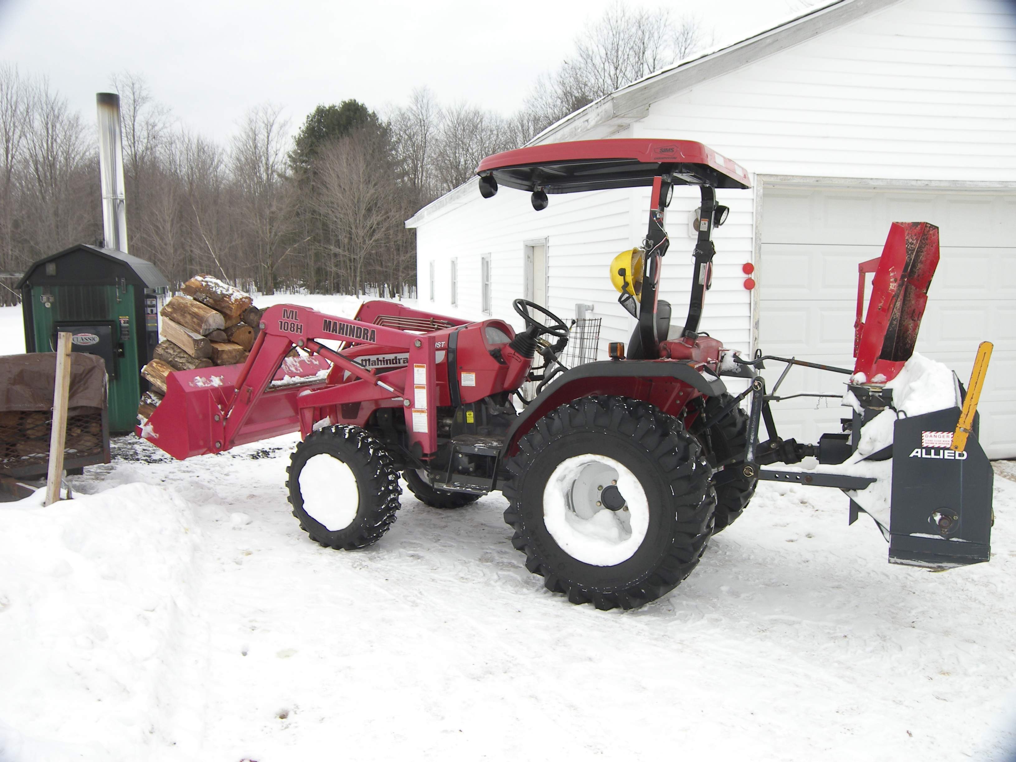

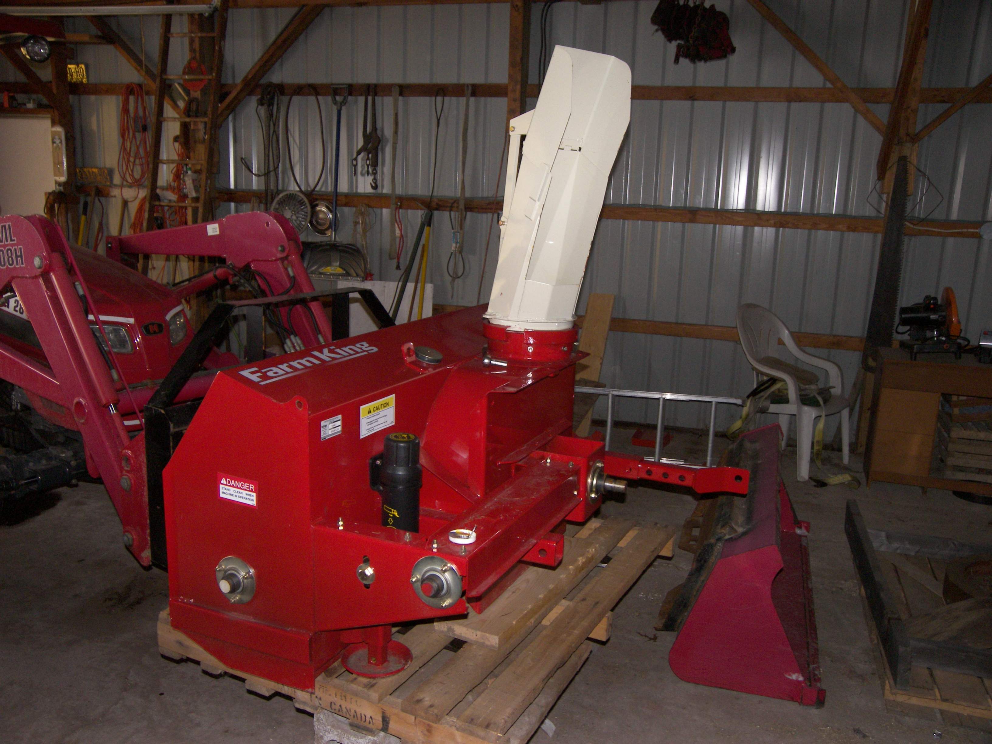

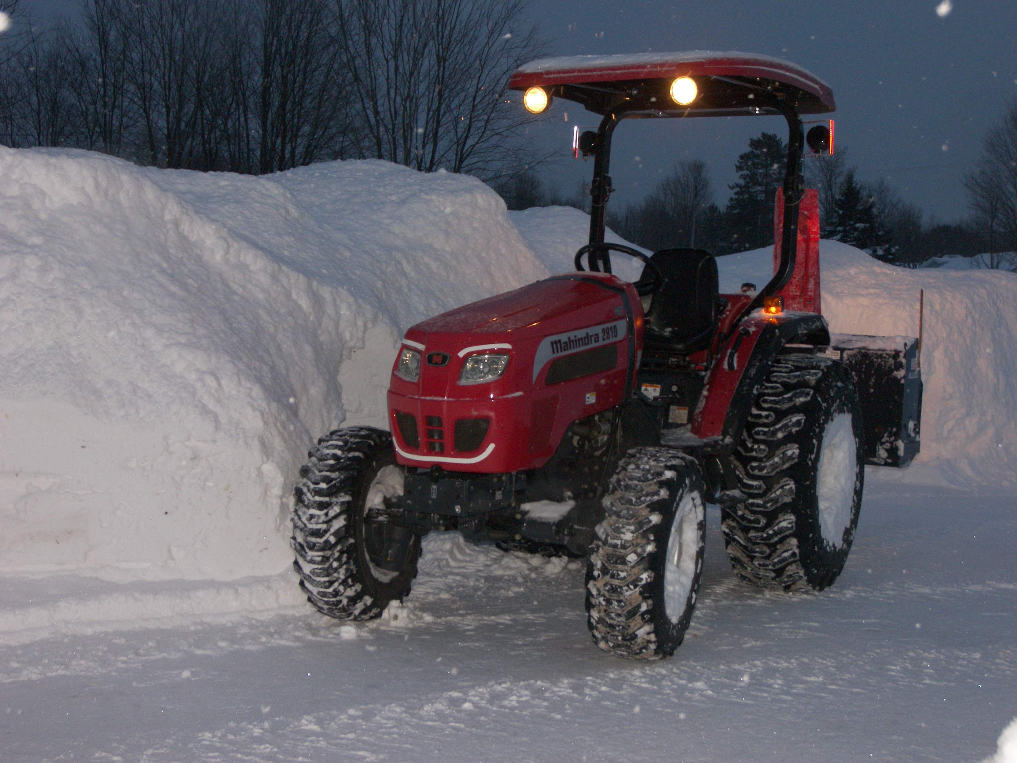

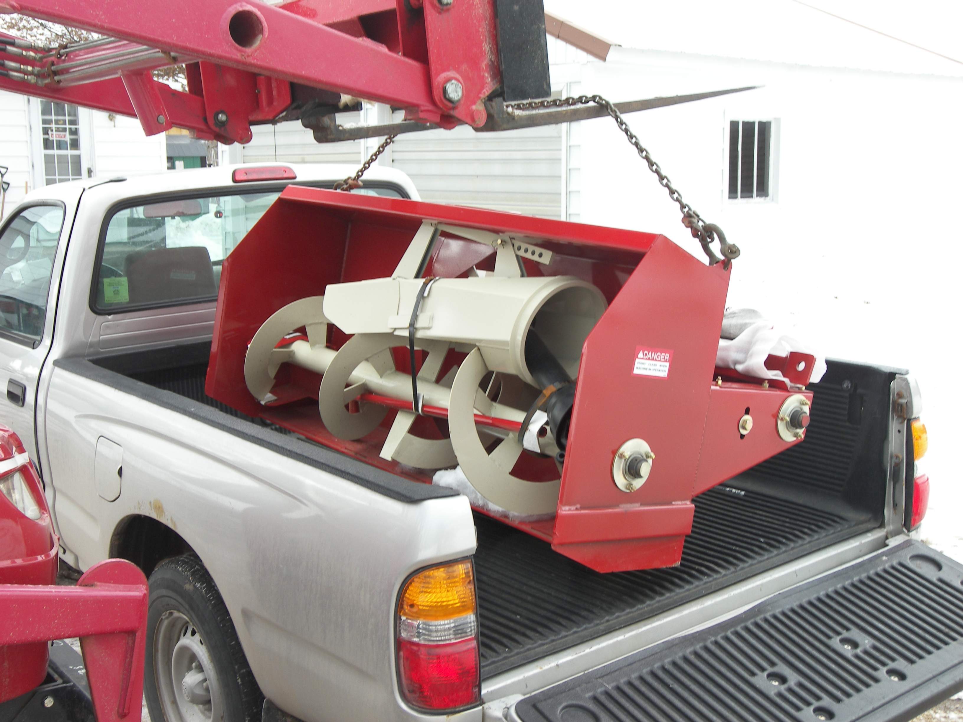

For the past 20 years i have had Buhler/Farm king blowers. I am on my second one now, wore the first on out after 18 years of abuse.I rebuilt the first one 2 times last rebuild the parts were going to cost more than a new machine. Dont be scared by this statement because i was doing 6 driveways at least 2 times a day that were 1500 - 2000 feet long. For normal use this machine will last a life time. Farm King/ Buhler is a good machine with good parts availability and reasonably priced. Heres some pice of mine and the new one. . . . .John
