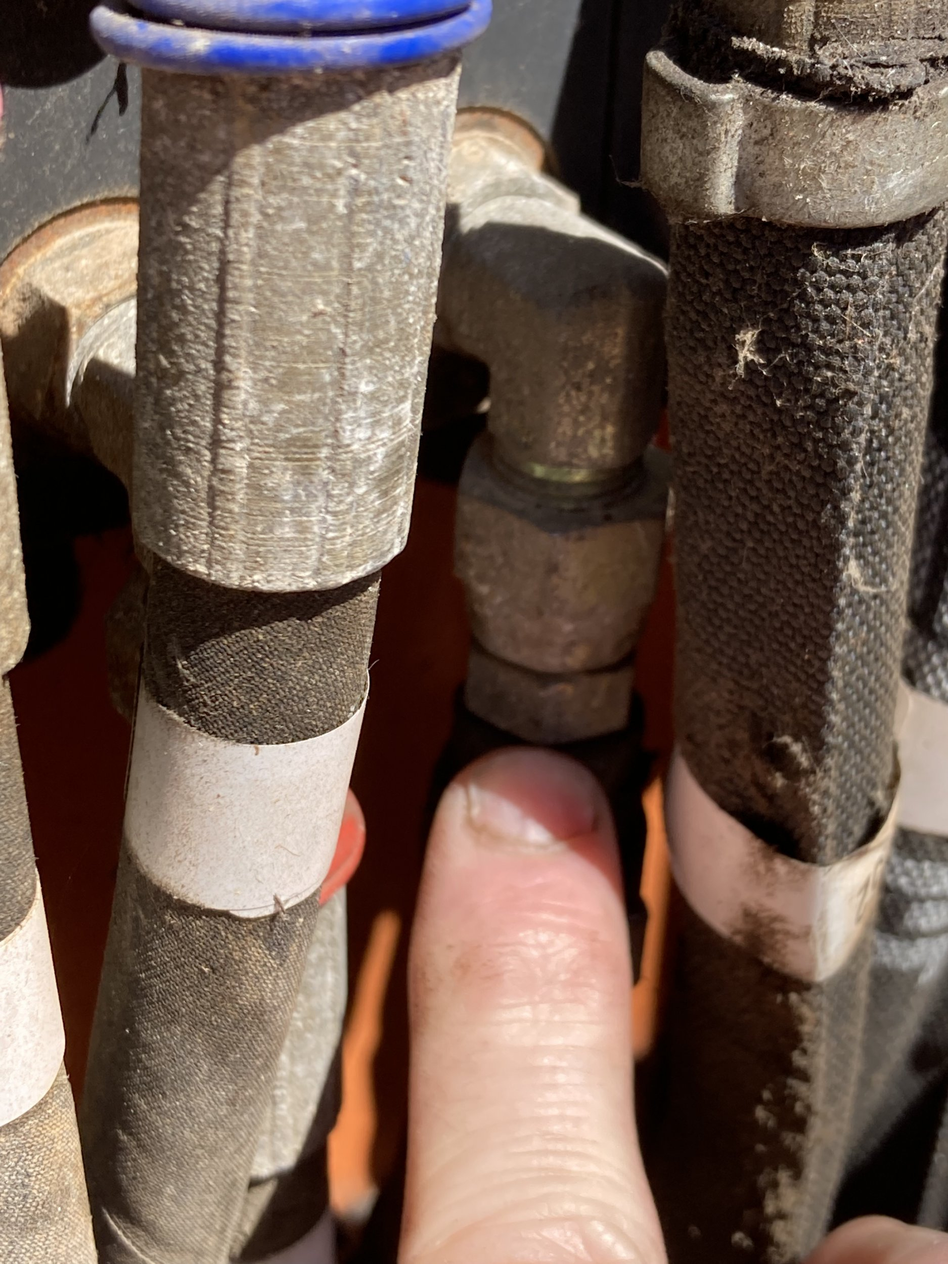

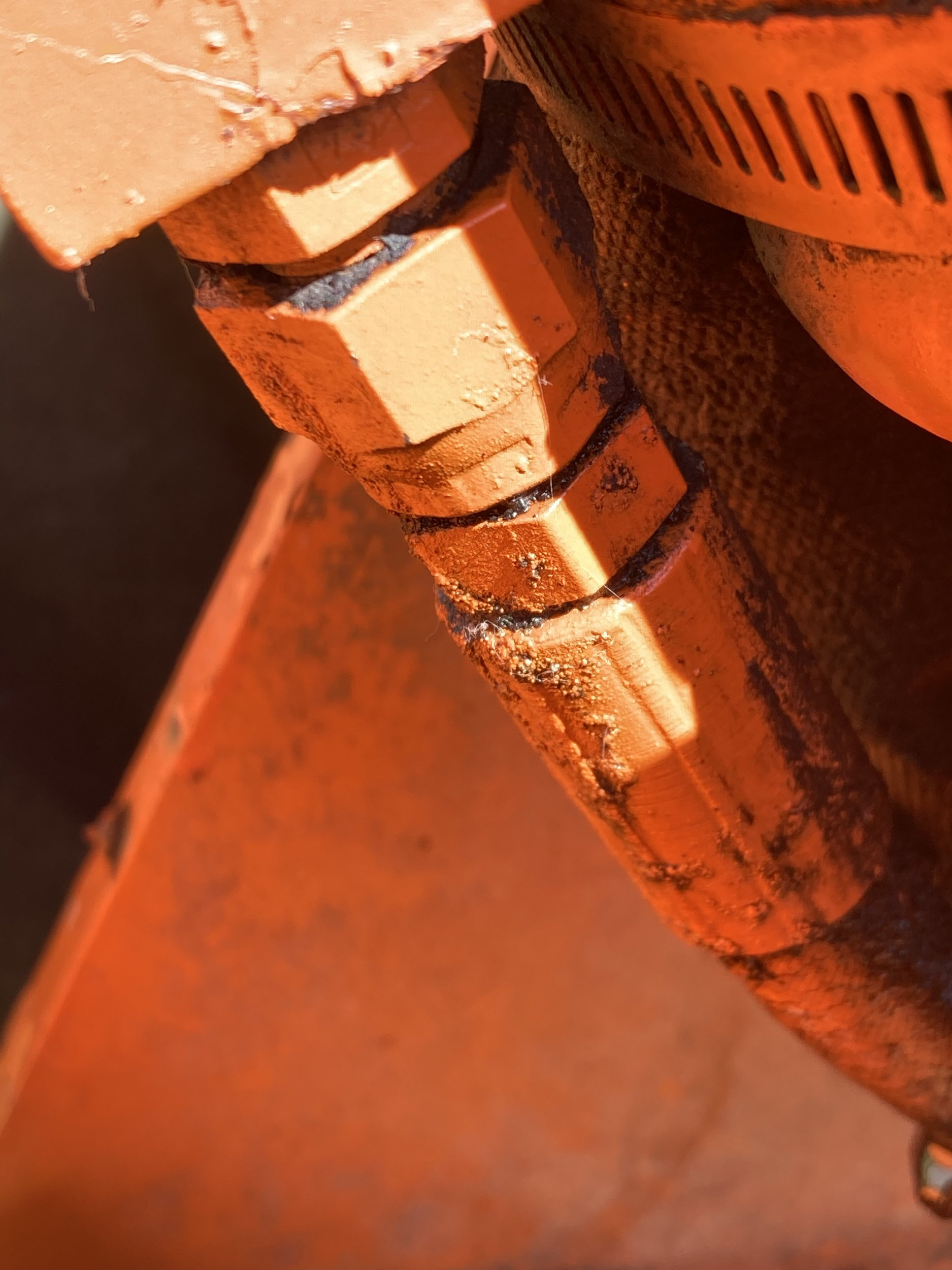

Hello, I have an Allmand 425 and need to replace a leaking left side stabilizer hose. it measures 30” from end to end of the bolts with the flair, and has an outer diameter of about 19/32”.
They are 3/4 “ wide bolts, and there sides are 11/16” long. The metal jacket along the ends is 1-3/8” long. Any assistance is appreciated .
thanks,
Andrew

Your going to have to take it off to determine if it’s npt or jic fittings. Just remove it and take it to a hydraulic shop or anywhere that make hydraulic hoses, it looks like standard fittings probably 3/8 jic as a guess.

Agree with setxjefff above - most large truck shops have a full size hydraulics shop that can make you a new hose if you don't have a tractor repair shop near you.

Ok thanks I’ll take it off in a few and post pics because I have to order it
   / Looking to identify what hose I need to get
Ok so it appears to me it’s a bi hose - female to female straight crimped jic 37 degree sae 3000 psi I plan on putting the protector over it - the right way this time- the original didn’t hit the right point.
anything else I need to know?
one think if I kook into the fitting in the hose direction where it is crimped, it looks like it’s 1/4 “ I assume that’s normal.
