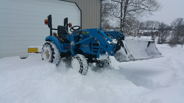

If you really think a SCUT is all you will EVER need, I would seriously consider one of these also as a compromise:
J2030H « LS Tractor USA
Mahindra Max This also has a comparison chart that compares your first choices, it looks like.

Highly recommend the LS. It will have significantly better specs and capabilities for less money than a SCUT.
