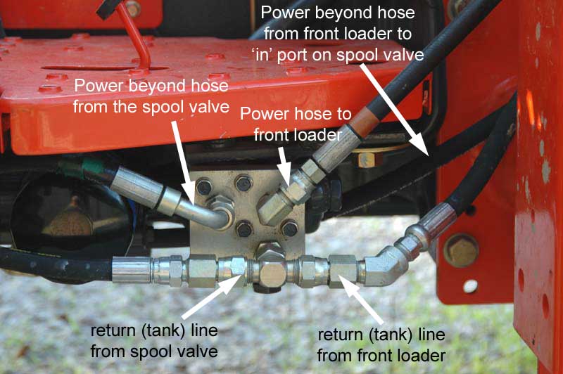

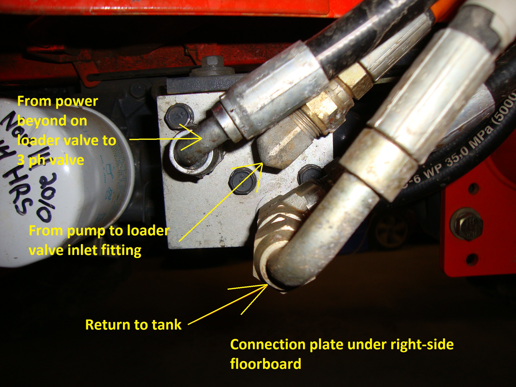

Okay, I just received the parts you recommended J_J. I cannot tell or find which is the in and out on the loader block. (Cant find a schematic anywhere, it's a LA853 with a YW240 loader block. There is also another block directly underneath that seems to split everything up, I.e, to the Hoe Attachment, 3pt etc... Your help is appreciated!
   / Looking to put a third function on my FEL as well as my BH92. #7
I am looking at a PDF from Messicks Kubota and it shows which line goes where.
So, go to to Kubota Parts | Full Service online retailer, enter your loader number and in about 10 sec, they will send you a PDF of the loader.
It may look like this.
so I am attaching from whats marked 3ph valve to my my solenoid block and returning from my solenoid block to the hose going to the 3ph correct?
#9
Not to be a PIA, is it an option to put in series with the backhoe circuit? the reason I ask is that I have a lot of room to mount the new solenoid block back there?
   / Looking to put a third function on my FEL as well as my BH92. #10
Yes to post #8.
You can put the 3rd function valve anywhere.
