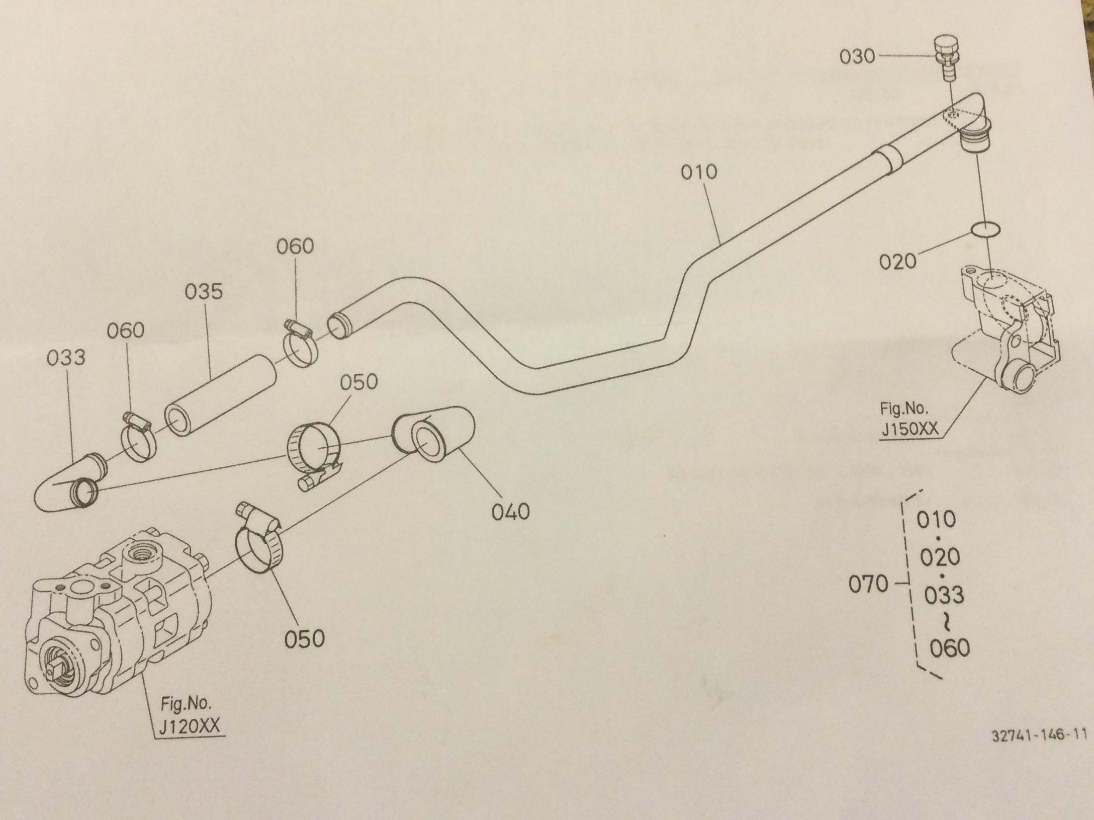

From memory there is a new improved suction line.
Suction line problems tend to aerate the fluid resulting in fluctuating oil levels and changes in sound.
Look at post #5 in the thread linked below.

I suspect cracks in the suction line line elbow. The link above details the replacement and new and improved line assembly. Achilles’s heel of an otherwise tough machine. Might consider changing the hst filter if replacing the suction line.

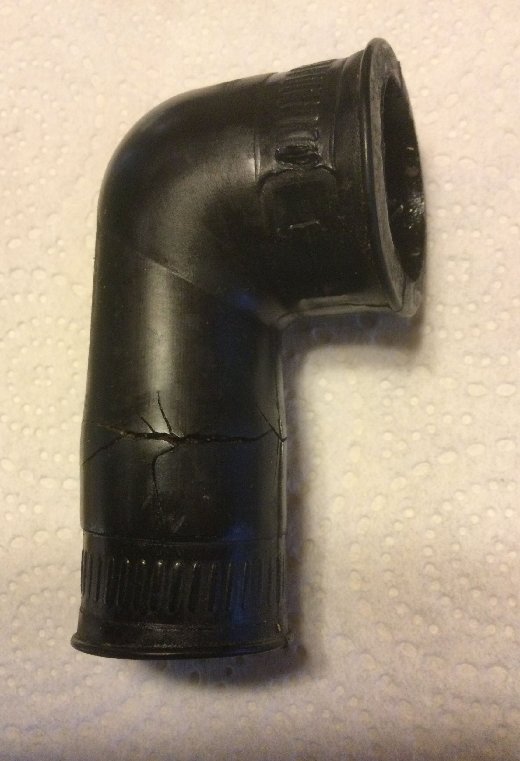

Update. Just finished replacing the suction line with kit from Kubota. I thought I was buying just the elbow (as did the parts guy) but got the whole kit which went from one long convoluted metal line with an elbow at the pump to a shorter metal line, a short section of hose, a metal 90 bend, the rubber elbow to the pump, and a bunch of band clamps. Turns out the old rubber elbow did have multiple cracks on the engine side that were not visible. Clearly Kubota knows they have a vibration stress issue with the old design as the price for the kit was less than $40 - about what I paid for just the elbow several years ago.

Started it with everything cool (not cold) sounded the same. Let it sit and run a bit first to send any trapped suction line air back to the tank, HST and all actuators worked fine. Below you can see the cracks in the old elbow and where they added (#35) a new rubber hose section in the kit. Besides added vibration dampening, the added hose gives you an opportunity to get everything aligned to relieve any mismatch from the old factory pipe and pump. Still need to give it a workout and make sure the pump wasn't also a contributor but otherwise all good.
