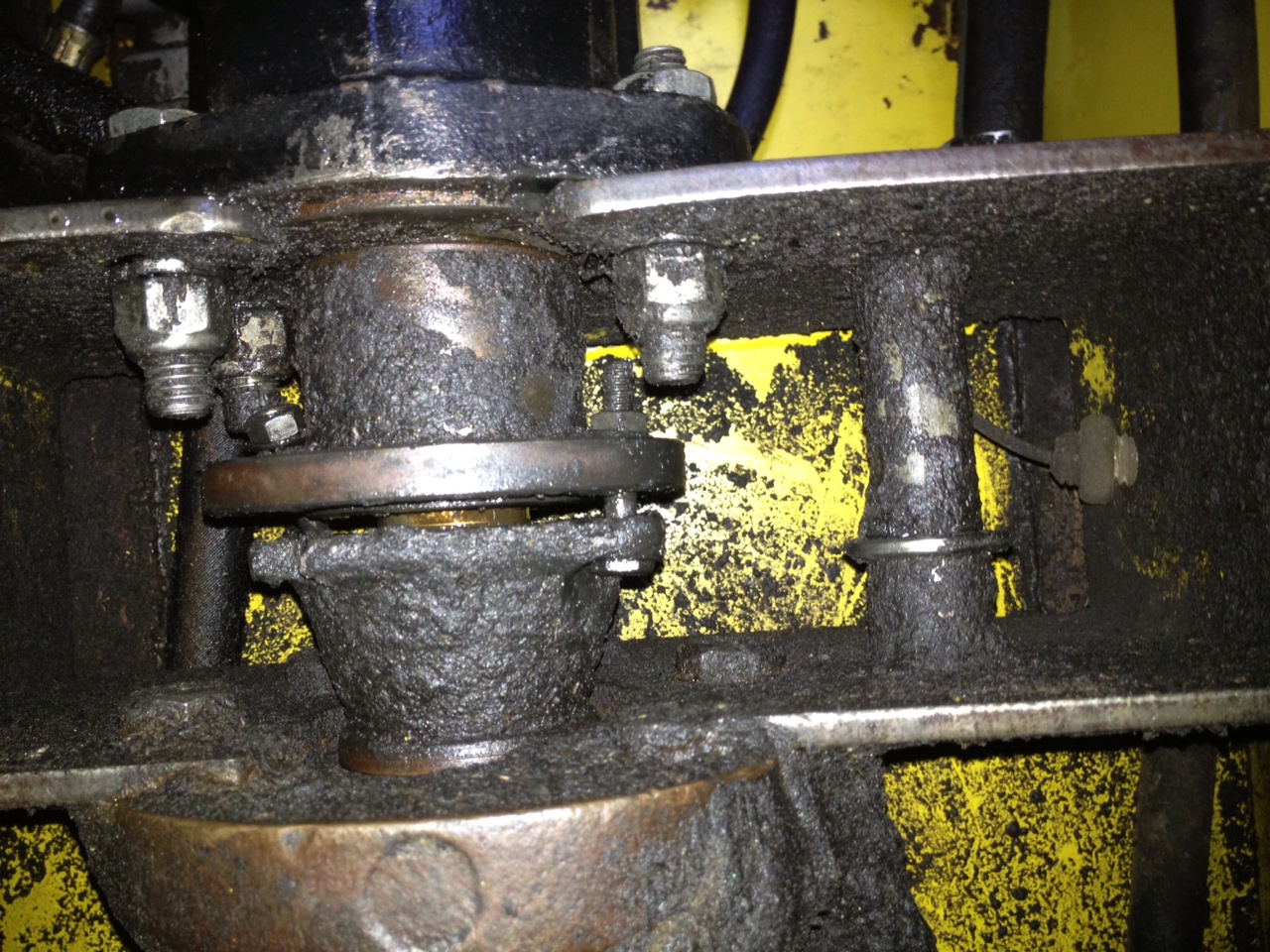

The companion flange is a Dana/spicer part. 2-1-1881x is the assembly, but you can buy the parts 2-1-1871 and the add the other piece is called a slinger- spicer part number 15099 to make the assembly. Pretty sure this is a Dana 44 rear axle- maybe someone can confirm this. If you do replace the flange make sure you use loctite on the bolts. Sounds like they have a tendency to work their way loose.
I have placed an order for the 1871 and the slinger 15099.....shipped to my door for $205. It is pricey, but my land is 25 miles from my house, it would be a big deal to break down and having to work on it down there.
   / Loss of power steering T5C
I am wondering if we are looking at the same thing. Are the Dana parts bolted right to the Torque motor? The ears that are broken on mine are the cast iron ones right on the torque motor. I am assuming you mean parts that interface between the Dana rear and the Ross torque motor? Although, I hope I am wrong because I would be tempted to repair this properly for $200.
Please take pic when you get the parts and start tearing into it. I will try to get pics of where mine are broken next time I work on it.
   / Loss of power steering T5C #8
danacompanionflangepicture.jpgHere is a shot from under the tractor. You can see the two parts have seperated and the bolts are loose. Bottom of the picture is the dana rear end. Note no brakes at all. Another piece that will need to be taken care of.
Too dirty to get a good shot.....got to get it pressure washed this weekend. You can tell the po had several leaks and did not take the time to fix them. I will slowly get them done.
