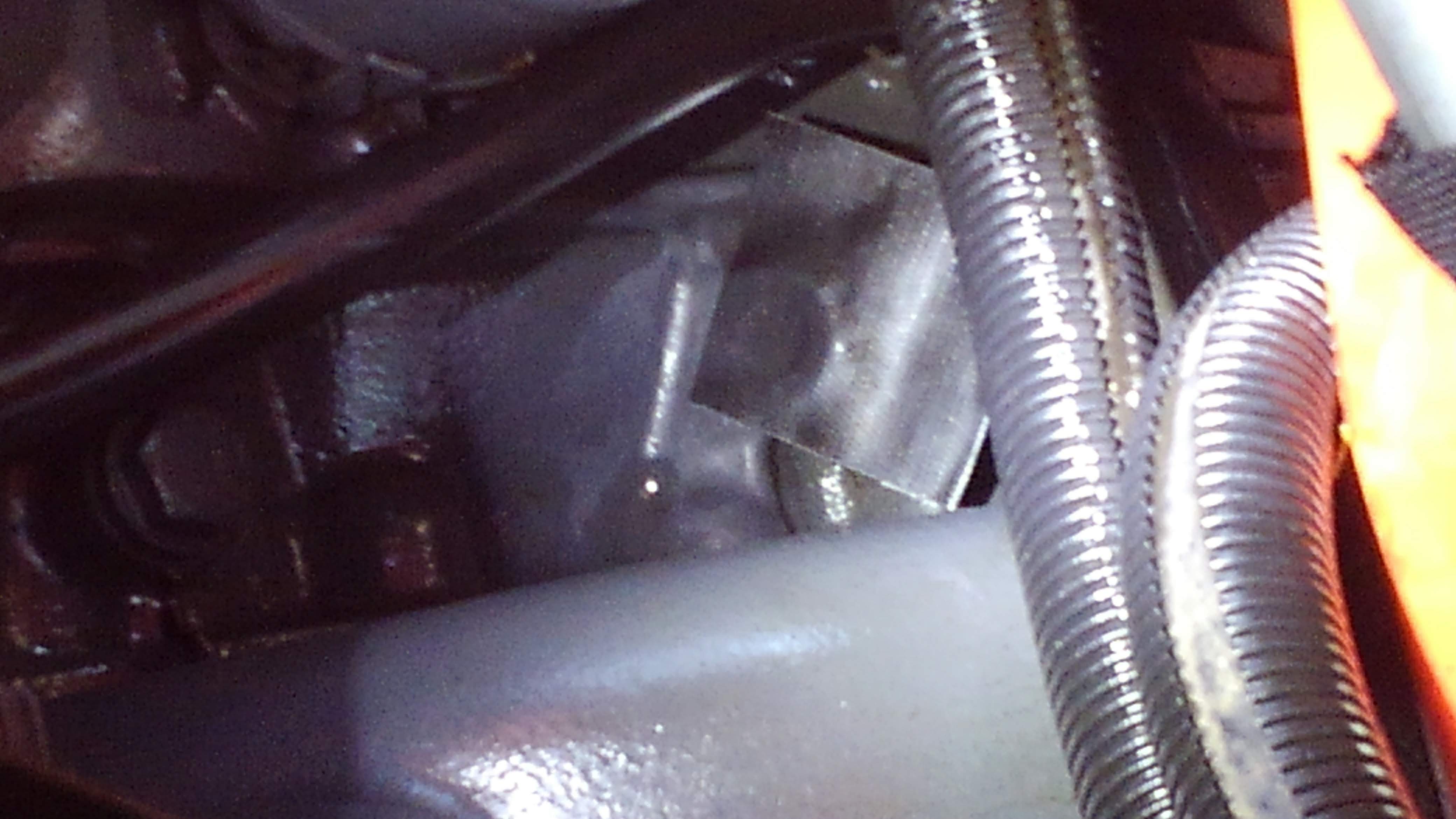

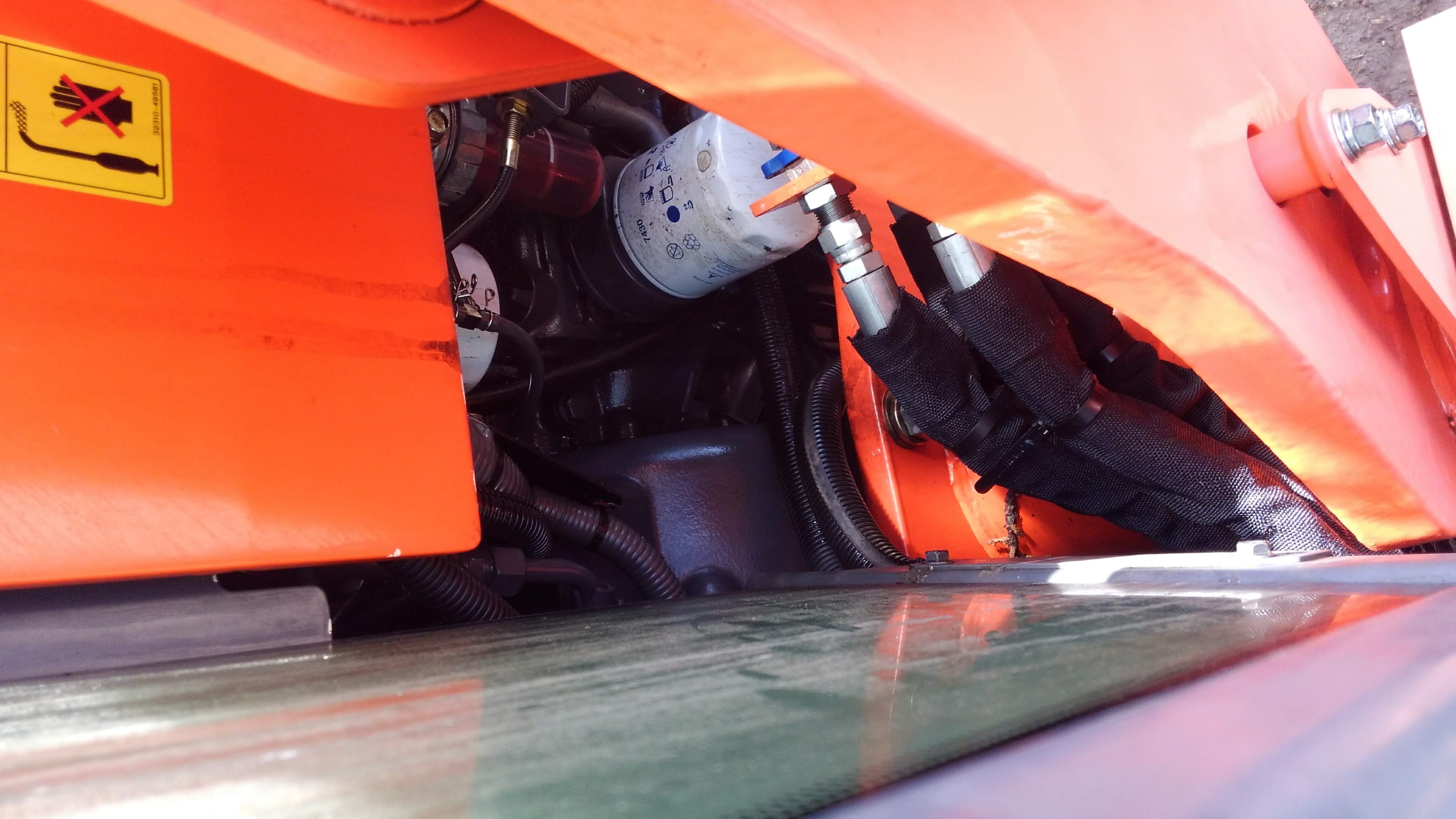

I got a couple of pictures just now, one is the area & the other is a close up shot of the hole with duct tape over it. Sorry for the tape, it decided to rain. KIMG0310.jpgKIMG0312.jpg

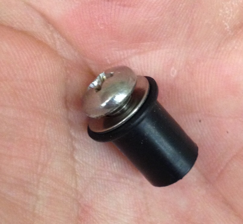

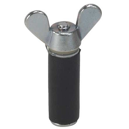

Go to the local hardware store or such, like Menards or Lowe’s even, Get a expandable rubber plug or well nut. Use a drill bit or such to get a rough hole size measurement to give you a idea of the plug size.IMG_0336.JPGIMG_0337.JPGIMG_0338.JPG
   / Lost dipstick plug #6
A tight fitting well nut would make a decent permanent repair, IMO.

Thanks for all the input.
I didn't lose the dipstick, this is an alternate location.
While I like the well nut idea, the hole is approximately 1/2 in. At that size and location I'm worried about the shaft on the well nut breaking and dropping into the oil.
I don't know how it got away, I do know there is normal crankcase presser and the engine has 1200 hrs. on it.
I have decided to insert a snug fitting bolt into the hole and JB Weld it in. I will first rough up the hole, then clean it. I think this is the best way to make a permanent fix without tapping the hole.
Any thoughts on this ?
