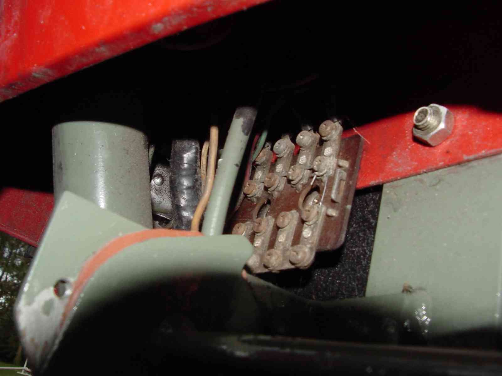

I've got a red Yanmar 1500 and today I noticed the bulb in the bliner on the fender had fallen out of the socket - I put it back in and checked it - no go.. wiggled the wire going into the plug and got a little spark.
Now I've got no blinkers, lights or horn. How does this circuit work? I looked at the electic panel and didn't see any fuses but I'm probably missing something.

You have fuses. The fuse panel is under the dash, and to the left of the steering column. Weird little wire fuses. But if you have spark then the fuses should be good?!?!

If you saw a spark when wiggling the wire that means you were connecting 12V directly to ground which then probably blew the fuse. The fuses are just small wires between screw terminals like Brent was describing. I replaced one of mine with 30 gauge wire-wrap wire. It was sufficient to power the head lights yet is small enough to provide the protection needed for the tractor wiring harness. You can get this wire-wrap wire at Radio Shack or any electronics hobby supply store.

I see the power panel and there is set of screws on the top which have lots of wires connected and a bank of screws on the bottom. There is only one small wire connecting the two banks which comes down from the one furthest on the right top to the right bottom. That wire is broken in the middle so I'll guess that's the 30 guage wire wrap wire you spoke of.
I'll replace that after I repair the blinker socket and cross my fingers.

Thanks - the rear light is the the holiday project.. I did replace the wire (fuse) and everything is back to functioning. Cut about 4 acres tonight with the lights - sure could have used the rear light.. It's rained so much here that it's growing so quick that the bahaia grass has gone to seed by the time I get back to the starting gate. Thanks again for all the help.

Just as an FYI - here's a picture of the fuse block in my 1500.
