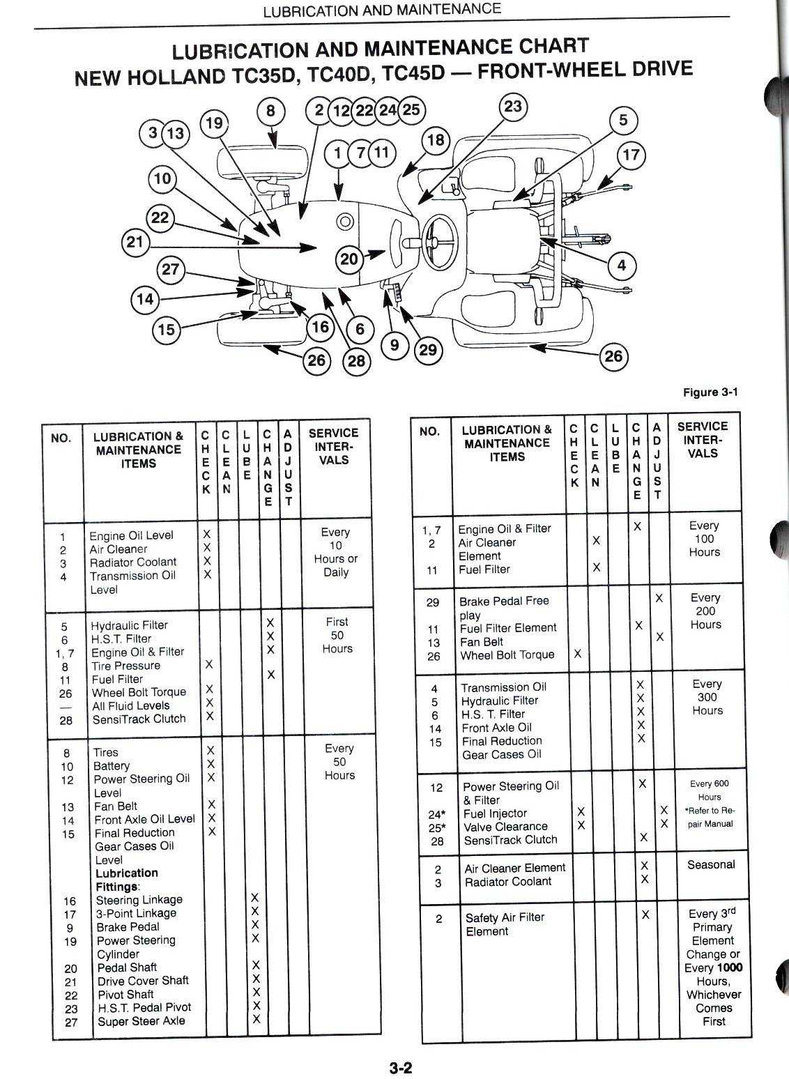

Good evening Tractor Buds, Can anyone look up the 300hr routine maintence requirements for my TC35? Filters?What Fluids?etc.
Have misplace my owner's manual for second time. Purchased replacement manual for $35 a few months ago. Misplaced. Please forward info on 300hr maintence points. Maybe I will find my manual in time for the 400hr check up. Many thanks in advance. Not eager to purchase a third owners manual.
   / Lost My NH TC35 Owner's Manual #2
Cary, I would be happy to look up the chart, but you have an identical one to the manual on the bottom side of your tractor's hood. Just raise the hood and look at the Lube and Maintenance Chart.
EDIT: I'm adding the maintenance interval chart out of my owner's manual, but it is for a HST tractor. Don't worry, the intervals are the same except you don't have a HST filter and don't have HST pedals to lube. Your clutch pedal may also have a zerk fitting somewhere. Otherwise, you should find them very close, just some few things in different spots.

thank you Jim and Terry for helping hand. I failed to mention that my TC35 is an HST. Looks like its time to replace all hydraulic and tranny fluid and filters. Is the rear reduction gears regular gear 90w oil?
   / Lost My NH TC35 Owner's Manual #5
NO! NO! NO! Use New Holland Multi-G 134C fluid only or its equivalent. There is no 90W oil used anywhere in your tractor. There is only one fluid and one filler cap behind your fuel tank and above the 3PH rockshaft (the cap is yellow and the dipstick is beside it.) The Multi-G 134 fluid is also used in your front axle and drop boxes as well as power steering fluid.
