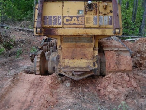

I have a Case 1550 dozer that I use for clearing brush, knocking over trees and moving dirt. It's about as much fun as you can have. While moving some dirt, building a road, I lost a track.

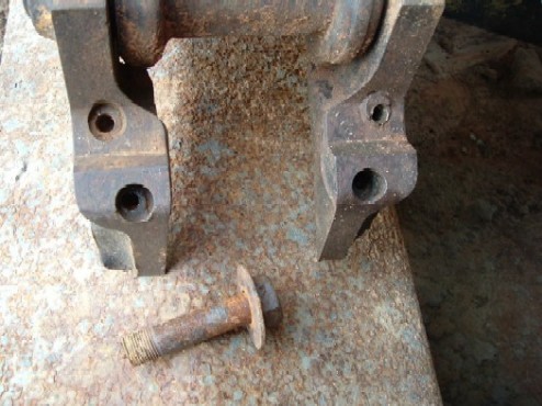

It looks like my master link had two bolts that had already broke off and I never noticed. The remaining two never had a chance. They are grad 8 three quarter fine thread torqed down to 400 pounds.
I used one cobalt bit per bolt to drill them out for an easy out. I spent two weeks trying to turn them with three diferent typs of break free oils. Either I'm just not strong enough, or they are just plain stuck

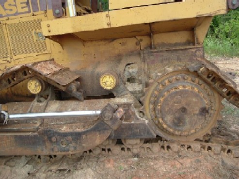

I tried to heat it up with a torch and after getting it all nice and red hot, nothing. I'm just not strong enough or I'm doing something wrong.
Screw it, off comes the track. I have no idea how I'm getting it back on, but I gotta get this thing fixed.

   / Lost my track
Notice anything missing?
Aint it sad, she sure looks naked.

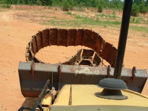

   / Lost my track
I couldn't just drop the track into my trailer. So I laid it out on the ground.

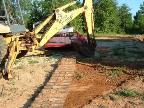

   / Lost my track
I couldnt just pick it up and put it in my trailer, it's just too heavy. I hooked a chain to the end and used my backhoe to drag it into the trailer. Took three repositions to get it in and a little luck.

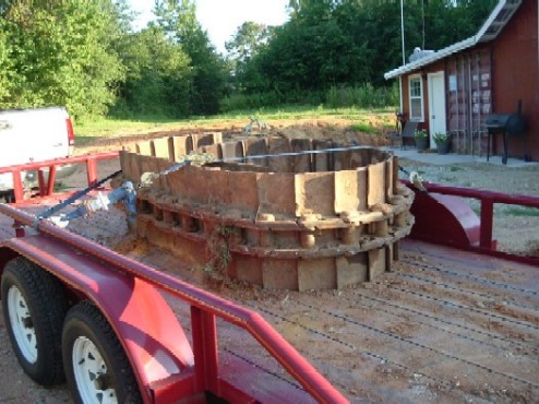

   / Lost my track
Its in and ready for a trip to the experts. I'm heading to a place called Cypress Equipment in Pitsburg TX, who specializes in track work. They have all the presses for replacing the bushings and rails along with what I need done.

   / Lost my track #10
I believe you need some attention to your drive sprockets too. The teeth look rounded off from the picture. Might be a good time to rebuild the clutches too. I don't know if I should ask, but how are your idlers?
