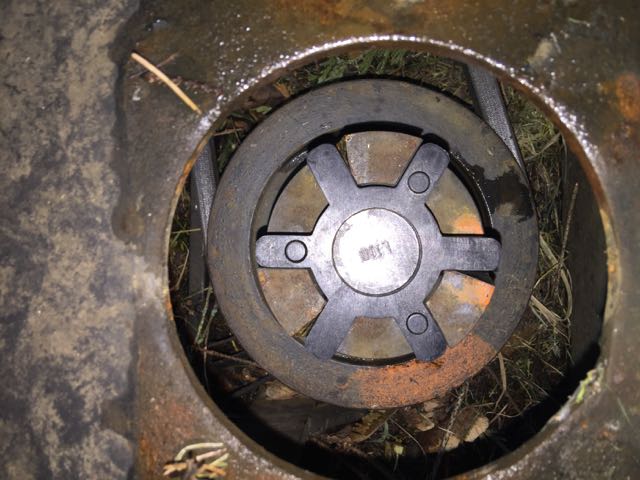

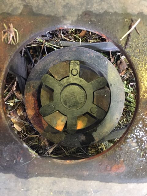

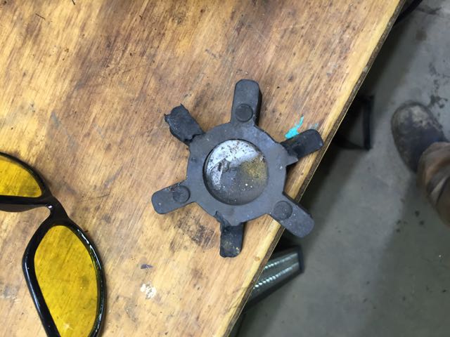

Well, so this has been going on for a while. A few years ago I was gone all summer and the neighbor kid got the fun filled job of mowing our 40 acres. But he did not no the quirks of the PT and missed the loose and vibrating mower motor.. I came back, saw it loose, noticed the rubber was shot on the lovejoy and didn't think anyting of it. Replaced the rubber and put the motor back on. 2 years later, lovejoy rubber has failed. Replace but do not inspect.
One year later (now) lovejoy rubber has failed, looked at it hard... Well @#)(W*%^)(* ! Just ordered two new lovejoys (cause you know they have different shaft sizes thank you PT).

Most lovejoy couplings fail due to misalignment or loose mounting bolts.
   / Lovejoy wear on my mower #4
And when JJ says misalignment, he means microns. You need to get out there with your dial gauge and check, and check, and check again.
If they aren't aligned, they'll get chewed up pretty darn quick.

Yeah, I straightedge when I mount, but damage was done a while ago. just never caught it.
