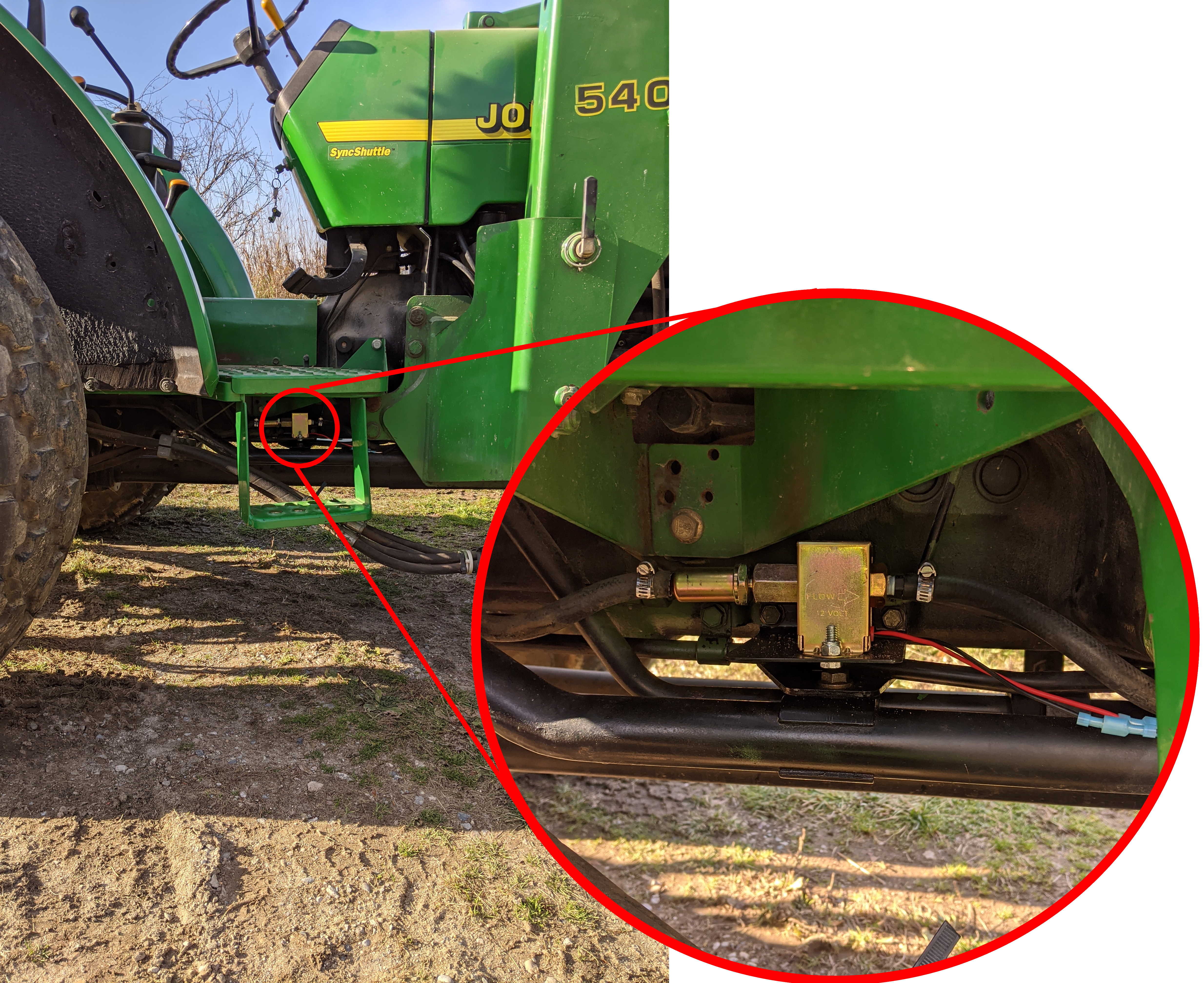

This post explains how I fixed my fuel delivery and priming issues on my 5410.
This solution may have faults and issues. Use at your own risk.
Problem - If my 5410 tractor was not used for a month or more (with less than half a tank) after starting it would stall out after about 10 seconds. Then I couldn't get it re-started. This was due to losing fuel prime. In addition while operating the tractor if fuel level got below 1/2 tank, it would lose power and may even stall. The issue is the fuel tank sits too low so the tractor needs a fuel lift pump.

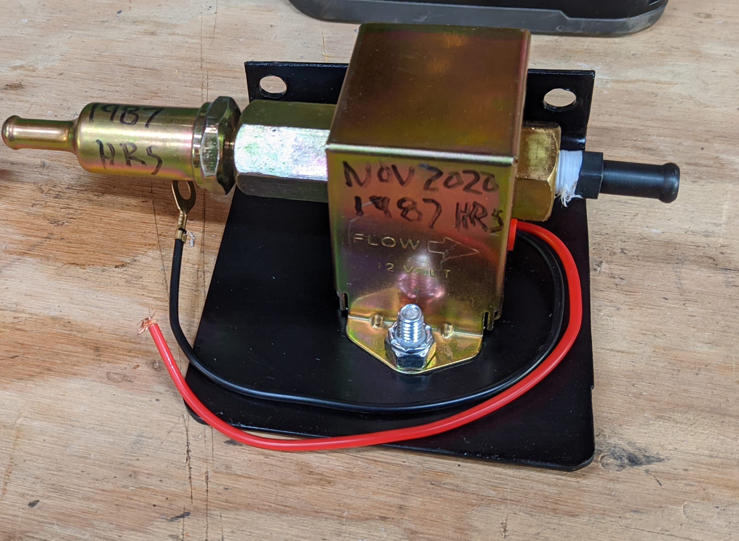

1. Uses a low pressure fuel lift pump. The fuel pump is about $15 from Ebay or Amazon. It's important that it is low pressure (4 psi max.). Just enough to deliver fuel to fuel filter but not too much as to damage fuel filter or injector pump seals This also makes it possible to eliminate the return fuel line from the fuel filter shown in Deere solution. The fuel pump used was from Ebay and it includes a inline fuel filter
Electric Fuel Pump 12v 2.5-4 psi Universal Standard Self Priming Heavy Duty Gas Diesel In-Line In-Tank
12V Volt 2.5-4PSI Universal Fuel Pump Electric Inline Low Pressure Gas Diesel US | eBay

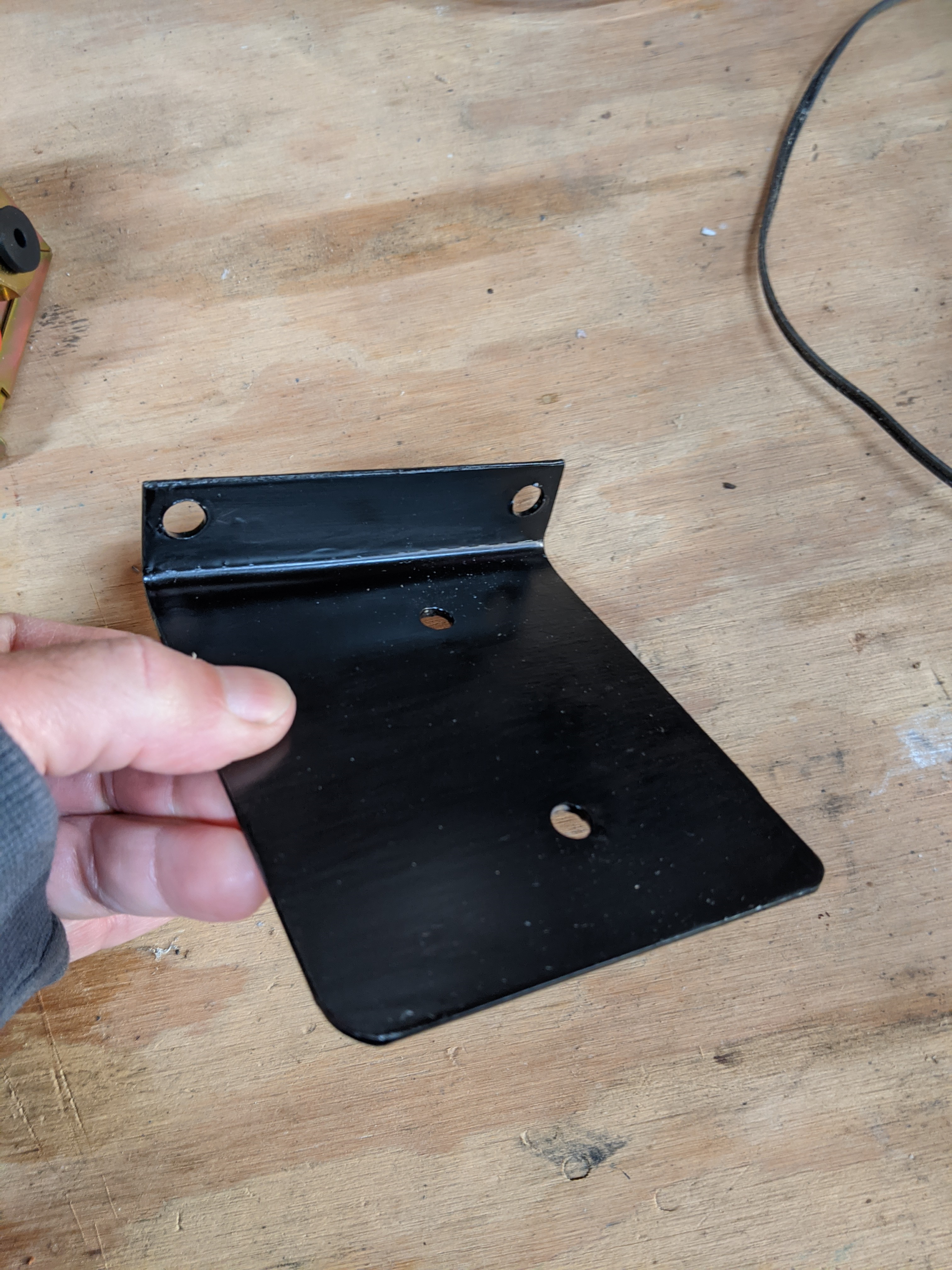

2. A small "L" bracket was made to hold the pump. It's attached to a tractor using 2 existing bolts just below the right foot pad. The fuel line runs through this area making it easy to splice it into the pump.

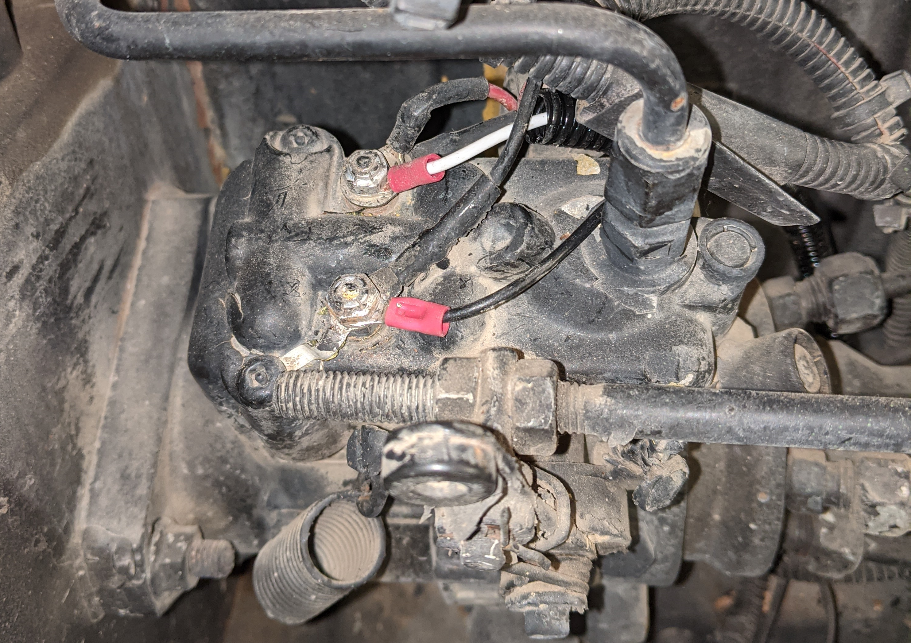

3. A relay is not needed to power the fuel lift pump (as in John Deere solution). This pump only requires 2amps maximum (mine measured at 1.1amps) so it can be wired to switched power without relay. The switched power connections come from the fuel shutoff solenoid on the injector pump.
I have been using this solution for only a short time but it seems to have solved my startup and stalling issues.

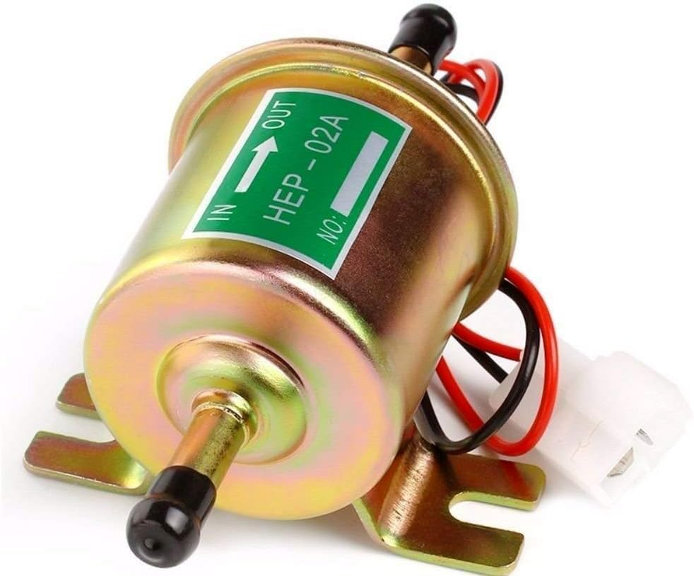

Amazon $9.99
Electric Fuel Pump 12v Electric Transfer Universal Low Pressure Gas Diesel Fuel Pump 2.5-4psi HEP-02A​
