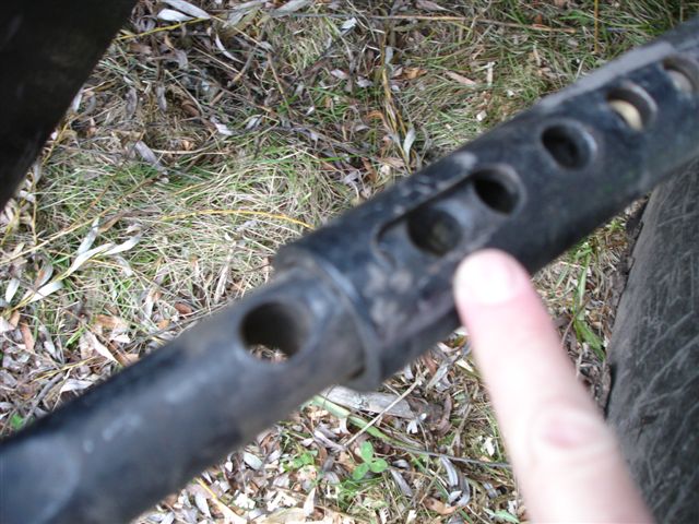

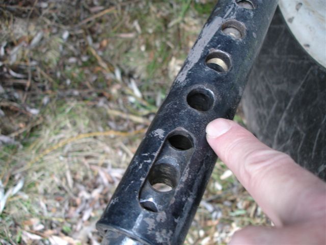

Until recently, I never really thought about where I should place the pins on my lower control arms. Then, one day, I mounted a new implement (snow blower) on the lower control arms, inserted the lower control arm pins in the holes that have no "wiggle". Drove around, operated the snow blower, checked balance and generally had a great time. Then the trouble started. When I tried to get the lower control arms off, the pins were so tight, they would not come out. Stuck!! Pinched so tight I could not get them to slide free to allow the control arms to spread wide and come off the lower control arms supports and release the implement. After an hour, I finally got them off and was able to release the implement. Now, this is my question.
Should I use the holes on the lower control arms that are long and oblong? These holes allow some movement side to side of the implement. Is this bad thing? Implement specific?
Bob
Here I am pointing to the oblong hole that has some "wiggle".
Here I am pointing to the hole that has no wiggle.

Bob I almost always use one with no movement on one side and the "sliding" one on the other side. That way the implement has no slack, yet you can get the pins out when you loosen the tensionsers.

It doesn't matter. Use either one, but when you hook up, you should "rock" the implement side to side. There should be a little slack. If the implement will not move any at all, the sway adjustment is too tight.
