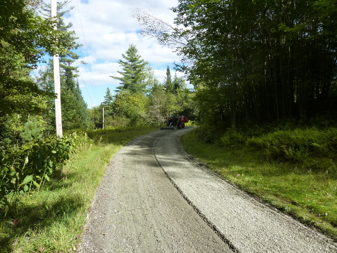

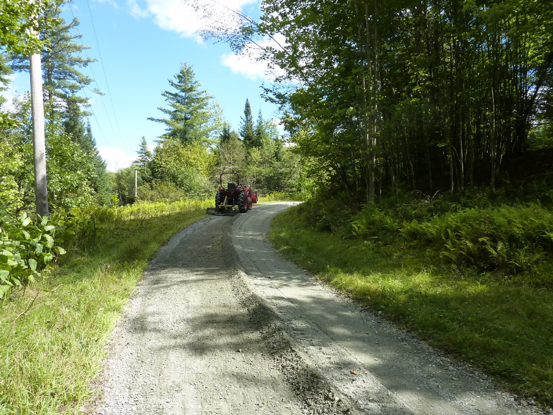

Any chance that you would have any pictures of what you have to work with. Pictures can really help with any assessment that would actually help you out.
Just my :2cents:, good luck. ;)

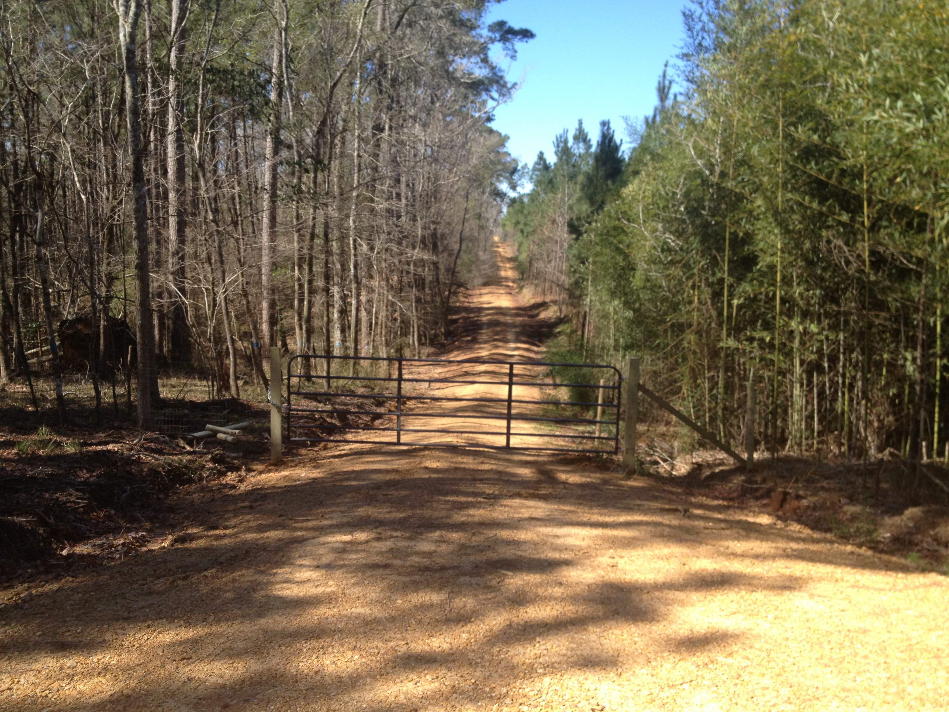

I don't have any current pictures of my problem areas where the gravel is starting to wash, but here is a picture of the road taken last year that gives you an idea of the terrain and layout of the road
/ LPGS setup #10
Based on the picture and what you currently have available to you, I would borrow your neighbors LPGS, hook up, set level and go to it and see what happens. It's not like you are going to ruin anything.:eek:
I personally have a 7' roll over box blade @ 980lbs, a 9' hydraulic rear blade, @ 1140lbs, a 7' LPGS @ 1400lbs and am reworking my 8' landscape rake that should end up at about 800lbs. All of these implements could be used on your road at one time or another for specific chores. My point being that it is very handy to not rely on a single or even 2 implements when you have as much and varying of road as what you have.
Also remember that most of the time when grading, weight is your friend and the heavier the better-easier it is to do the work. ;)
I lived in Baton Rouge as a kid years ago and remember the heavy rains there. Looking at your road makes me think you need it to be heavily crowned since the water will flow down the steepest part of the road. To work right the crown needs to be steeper than the roadway if you want it to run off in the shortest path. That can be impractical though if the road is too steep and you may want to put in some swales to force the water to the sides.
You can fix up the crown and keep working it when it rains but without some well planned fixes it will require a lot of maintenance.
