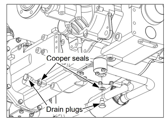

Could not finds a search box just for LS Tractors so sorry if I am duplicative but where is the Hydro oil drain plug. No diagram in manual.

I'm going to assume G3033 the items labled #7 should be the plugs.
You can go Parts - LS Tractor USA then click on "Look Up Your Part" , use the menu to select your tractor and area of interest.
   / LS 3033H #5
They don't show them in a G3033 book but they show them in a MT225E book. Same transmission. Copper drain plug seals are called "cooper" seals. Lots of typos in the book.
