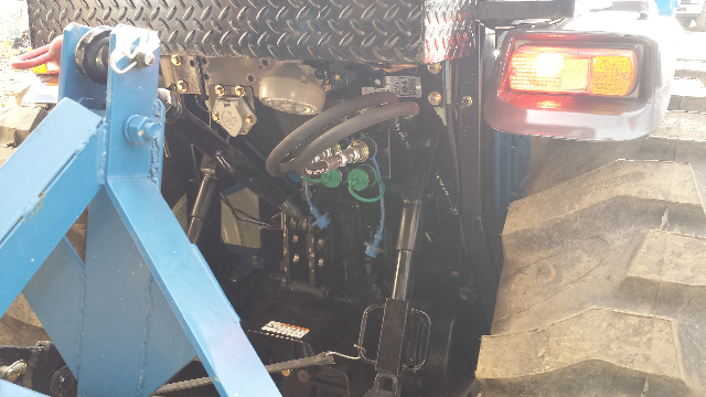

Now, I want to get the remotes to run a grapple bucket up front. I need suggestions on how to run the lines to keep them protected. I plan to lay everything out with an old used water hose, but suggestions are welcome. I'm clearing six acres of land with two daughters and a wife and lazy friends. So as you can see I will be doing most of the heavy stuff by myself while the girls complain about dirty socks and underwear.

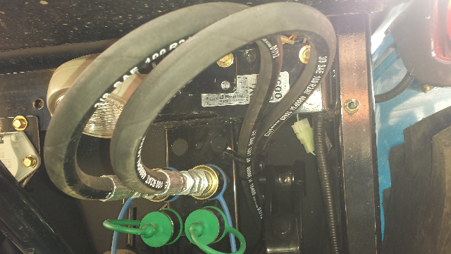

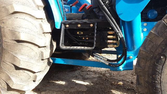

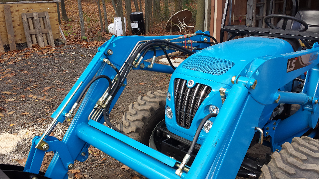

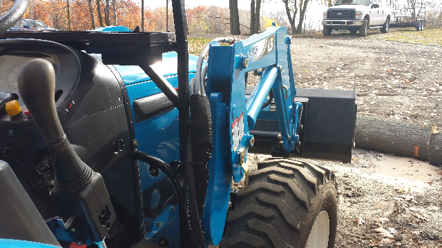

Here's what I did:
I left slack at the bottom because I still need to add quick connects at that connection for if/when I take the loader off. I also still need to add a mounting plate at the loader front cross member, so the ends are better secured.
