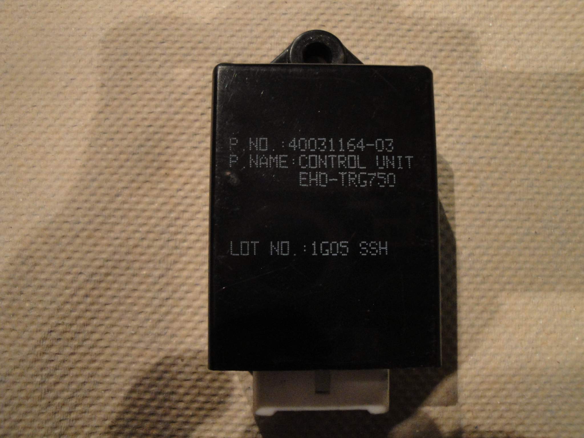

I thought that it would be nice to share an issue I had with my differential lock. Last winter when I needed to use my differential lock I had to keep the switch pushed in for it to work. As soon as I let go of the switch the differential lock would not engage. So a month ago I thought I would report it to my LS dealer here in New Brunswick Canada (Patterson's). My 7010 is a 2012 with just over 600 hours on it and the management team at Patterson's were very good. They quickly sent me a module that is located just under the steering wheel that fixed the problem. It probably took me about 10 minutes to replace the device. If anyone has a problem, this is a picture of the device they replaced.

Sounds like you have a great dealer.
Also sounds and looks like you have an electronic diff lock control that uses that control module.
Glad it was an easy fix.
