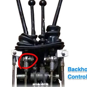

Probably dropped a ball joint under the black rubber cover. This is off a bigger machine, but its similar to the red circled part.

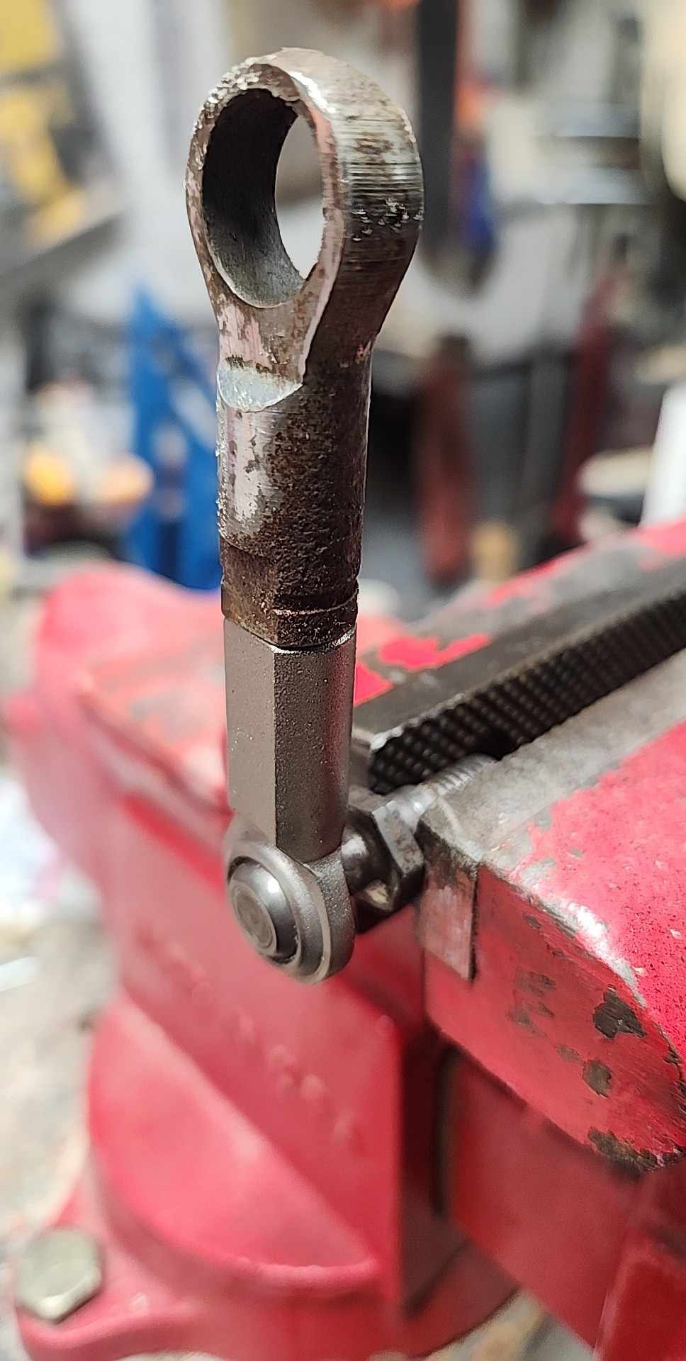

I found a fix to this. You'll need to order the part in my pictures along with possibly a new bolt for the standard thread and not metric. My original threaded in no problem Anyway here we go...
Here is the part you'll need.

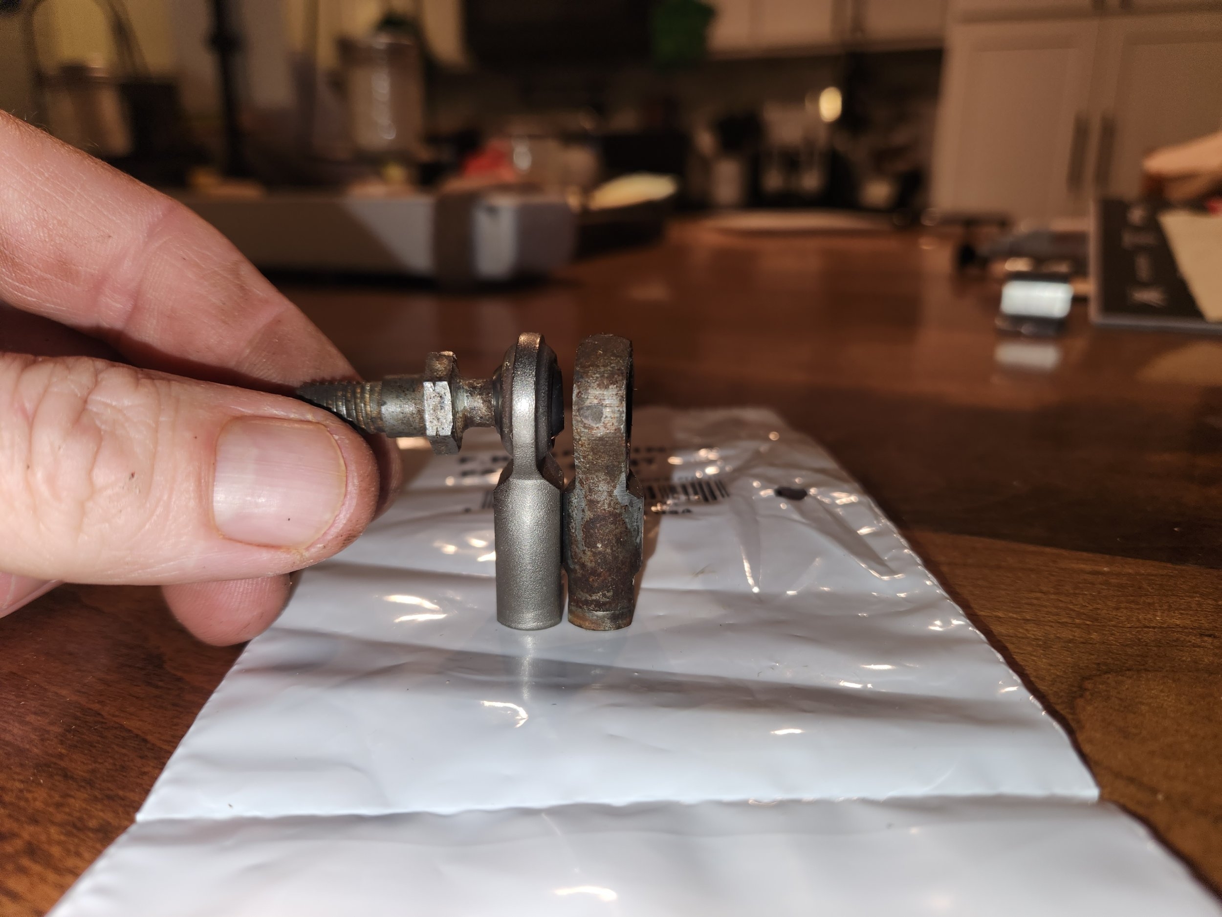

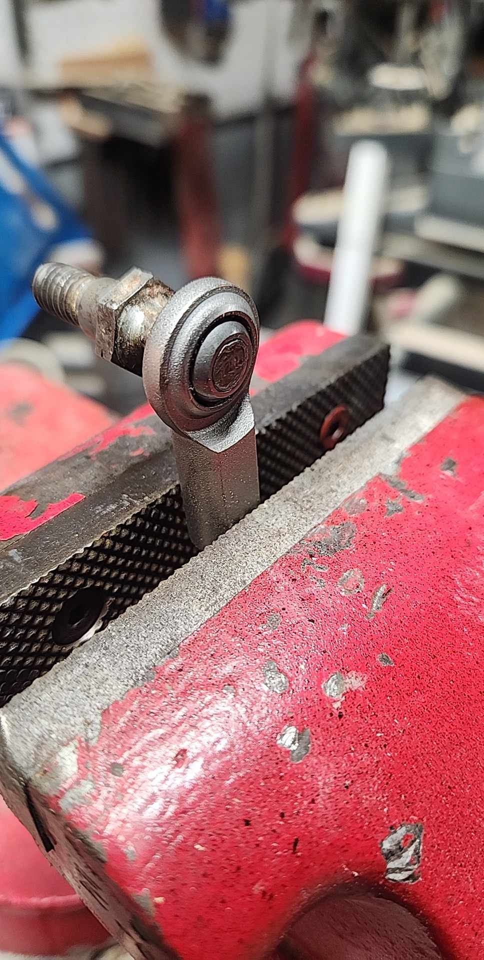

Next you'll need to grind off the peened end of the threaded stud. Once you drive the stud out of the little ball socket install the stud into the new end. Mine fit perfectly and i ground as little as possible. You might be able to just drive it out without grinding but mine wouldn't budge even with heat. My picture shows the stud installed into the new end but you can see where i peened it back over.
You can see here where the new and old match up perfectly.
And here it is installed.
