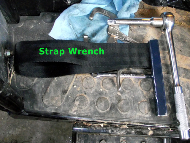

  1. As all the filters are simple screw-on canister filters, a simple strap wrench will do the job.

  4. Use strap wrench to unscrew filter. Ponder how there is nary a drop of oil in the filter.

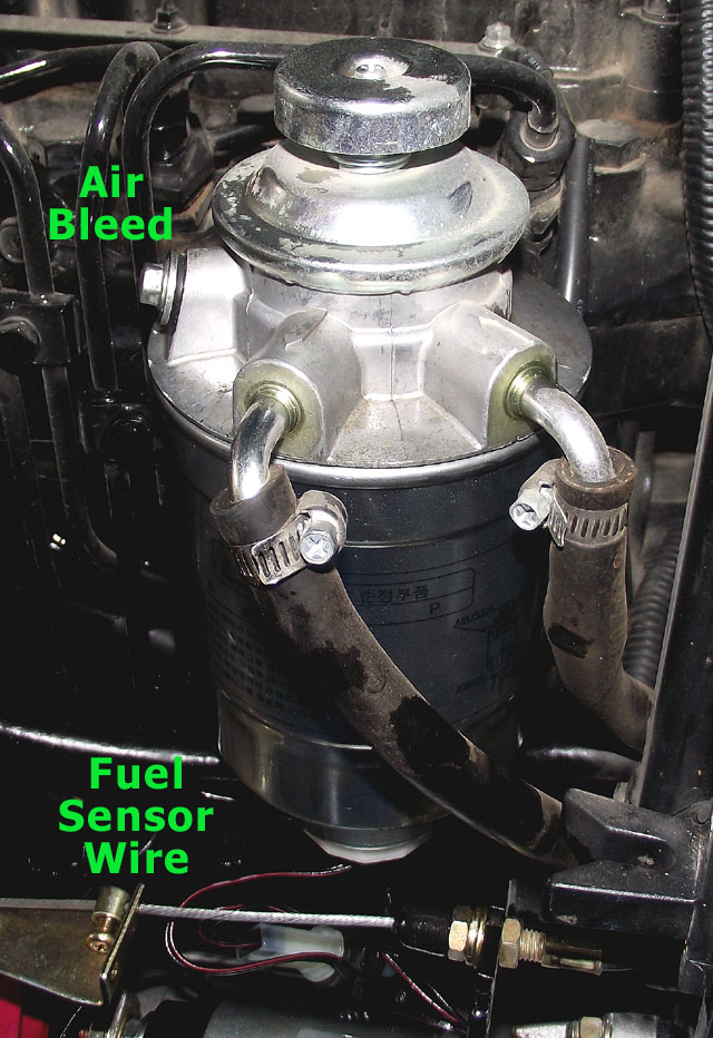

  6. Proceed to other side of tractor to remove fuel filter.
  7. Note sensor wire and drain attached to bottom of fuel filter. Disconnect same to prevent snapping them off while unscrewing filter. Run the strap wrench high on the filter to prevent snapping off the plastic nipple for the drain.
  8. Filter might be tight. Use sufficient force to break the seal on filter.

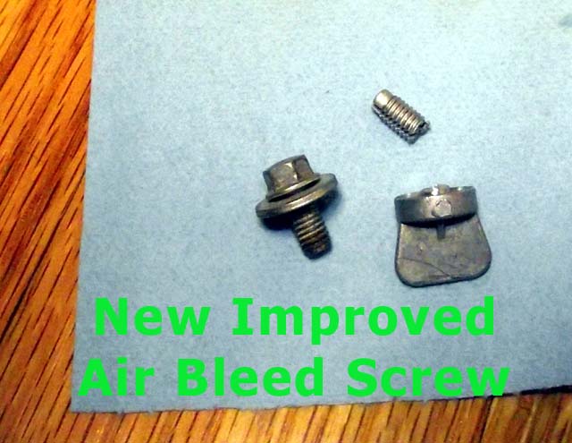

  9. Note as the strap wrench rotates it scrubs off the head of the air bleed screw. Name seems to be a misnomer as fuel is now bleeding copiously out of the air bleed.

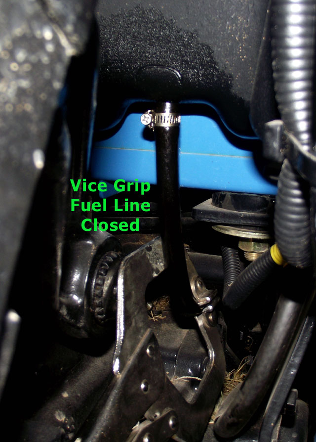

  13. As the drain pain still has a few inches before it overflows, hobble over to welding cart for vice grips.
  14. At rear of tractor, clamp off the fuel line as it leaves the tank. Note how the factory barely tightened the hose clamp and fuel has been seeping out for the last several months.
  15. In the interests of brevity, I will not cover how clamping off the return line at front of tank on right side of seat, and the resulting troubleshooting, has no positive effect.
  16. Return to left side of tractor and complete fuel filter removal. Note that filter is brimming full. Dump into drain pan while enjoying the satisfaction that you used the big one this time.
  17. At work bench, unscrew sensor/drain from old filter and attach to new filter, using the only wrench large enough for the fitting -- a bench vise.
  18. Rummage though old motorcycle bolt pile for replacement air bleed screw. Back at tractor, fiddle the broken bit of the air bleed out. Spend as much time as necessary poking around the motor to retrieve the head of the broken air screw to reuse rubber washer.
  19. Installation is simply the reverse of disassembly.

  27. At this point, the majority of work is complete. Remove superfluous vice grips from fuel return line. Remove vice grips from fuel tank outlet. Tighten 1/4" hose clamp on fuel line and note what a great rust preventive diesel might be.

  29. Remove new bolt from air bleed on fuel filter and wait until fuel is again spurting out of the hole -- no pumping required. Tighten bolt. Start tractor and check for leaks.
