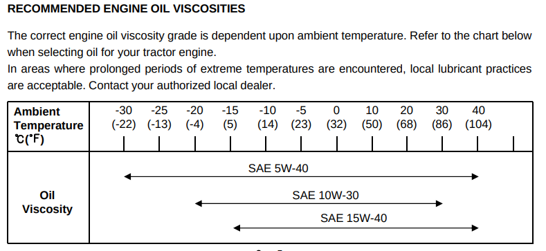

Dealer recommends and uses 15w40 in this area.
From the manual:
I would definitely try switching to Rotella T6 which is 5-40 just to see if anything changes, 5-40 definitely fits very nicely in your temperature range. But because of supply issues it might be hard to buy in your area. Walmart has free shipping to your local Walmart but unfortunately it currently shows out of stock.
