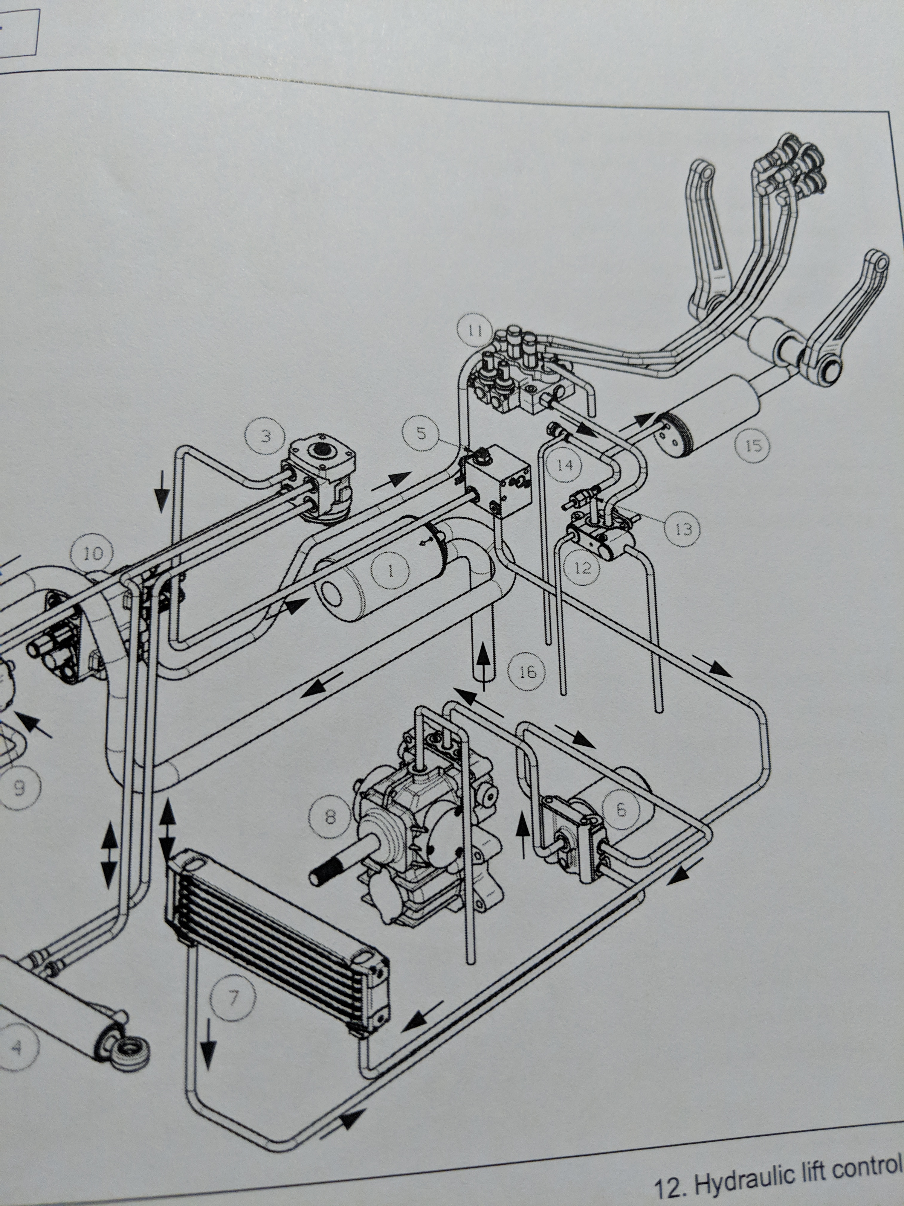

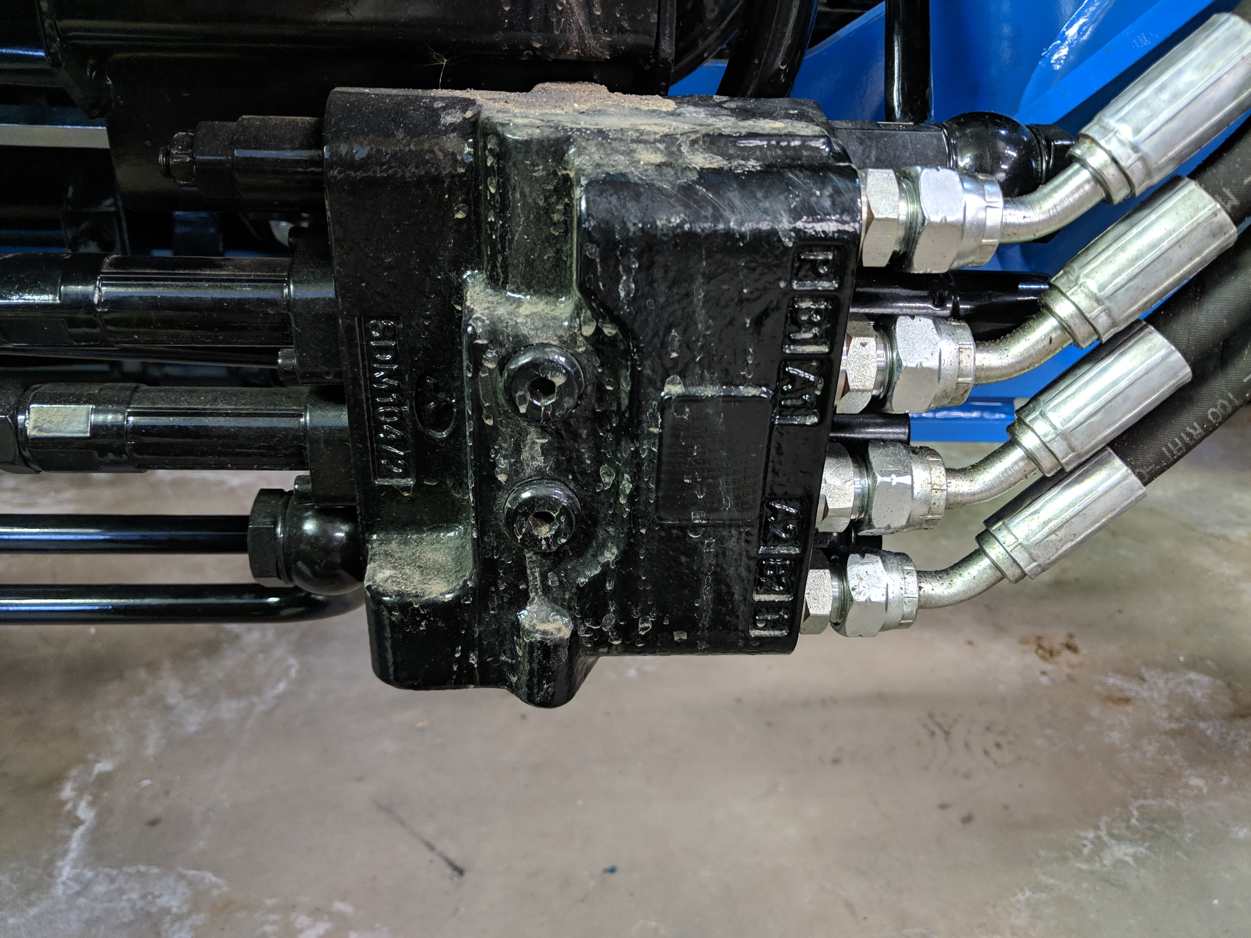

Hey guys I purchased a new XG3140H last fall with plans on adding a grapple for firewood and general clean up. I bought a 3rd function kit from summit and looking for a schematic or image of the correct line for power beyond. I've noticed getting this information for the LS brand is difficult. I have my operators manual and the image shows a different loader valve than what I have. I have included my valve image, there are 2 lines running back, one goes under the seat and the other down low. Any help would be greatly appreciated!

How about the remote valve for the rear what line was used for that one? Think it's the back hard line i'll hook into and see.

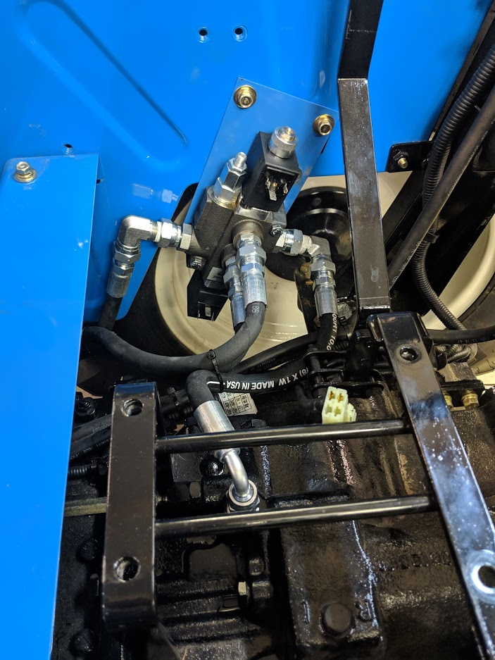

I have it figured out now.
Just need the hoses. Here is my valve installed.

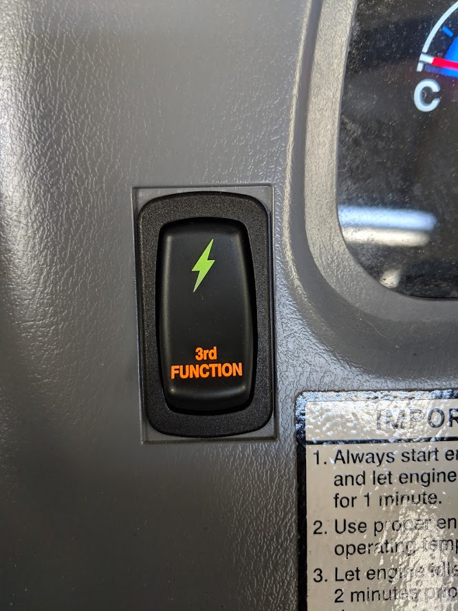

I have it installed and seems to be working correctly and only had a small leak that was a loose fitting. Also installed a switch on the dash to cut the power to the valve relays.

Implement pump (gpm): 8.2
Steering pump (gpm): 5.5
Total flow (gpm): 13.7
Steering pump is what feeds the hydro tranny from the line layout on the schematics. The power beyond only sees the 8.2 GPM. I am going to ask my dealer about it and see what he thinks, no one seems to know much about the LS tractors. I get that deer in the headlight look when I ask technical questions, one thing I hate about the LS brand its so closed lipped.
