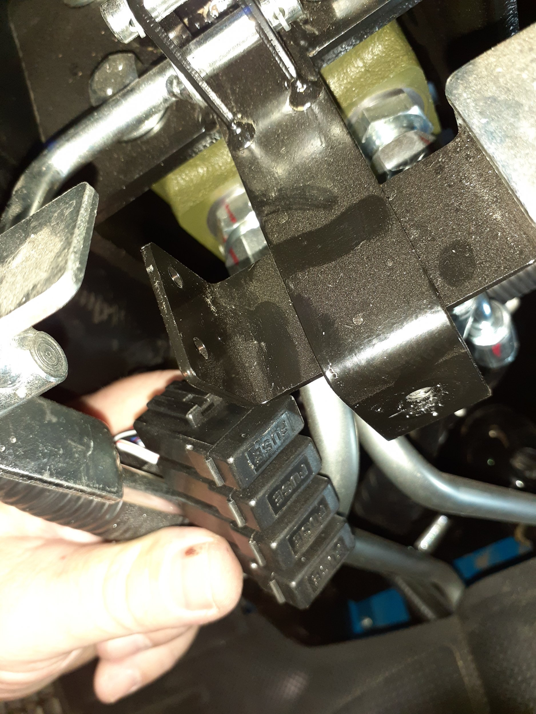

Hi,
I have a brand new 2021 LS XJ2025H tractor and was seeing if I could upgrade the work light to an LED bulb.
Of course I blew the fuse, I think.
So I looked in the manual and could not locate the fuse block :-<
I called my dealer and they looked at another tractor on their lot and couldn't find it either.
Can anyone help?
Thanks and may God bless you abundantly today.
V/R
Steve Koratsky
aka LargeTarget
   / LS XJ2025H Fuse block? Where is it?
#2
I hope this helps others...
Okay, I found it and answered my own question.
I had blown the 5 amp fuse for the work light/turn signals.
It is part of the main wiring harness and is not a "block" but a group of 4 "connectors." It is right by the orange parking brake release lever.
Attached is a picture.
You have to remove the misnamed rear cover mentioned in the manual on page 5-42. It helps to disconnect the light switch cable and the ignition switch cables. You also have to remove the orange knob on the throttle to get the panel off. There is a small Philips head screw on the bottom of the throttle knob.
It should be by the battery or in an easier place to get to, but the engineers who design stuff don't seem to ever actually work on the things they design...
V/R
Steve Koratsky
aka LargeTarget

where is the fuse for the wiper motors
