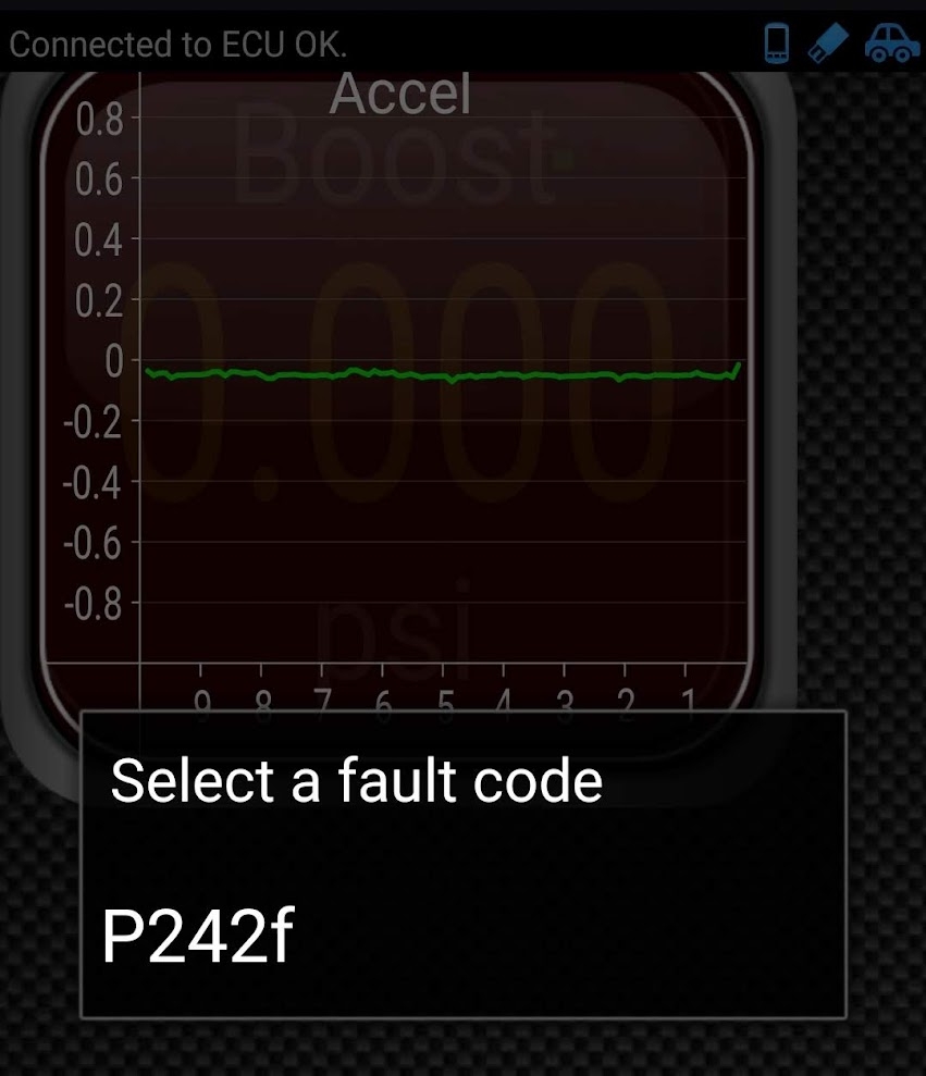

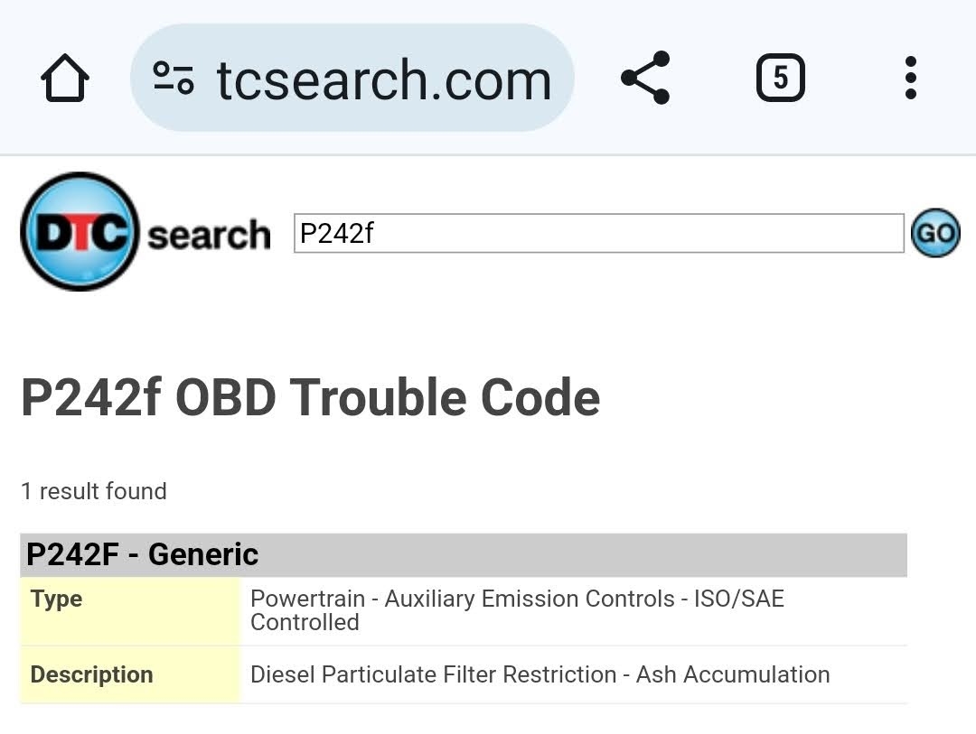

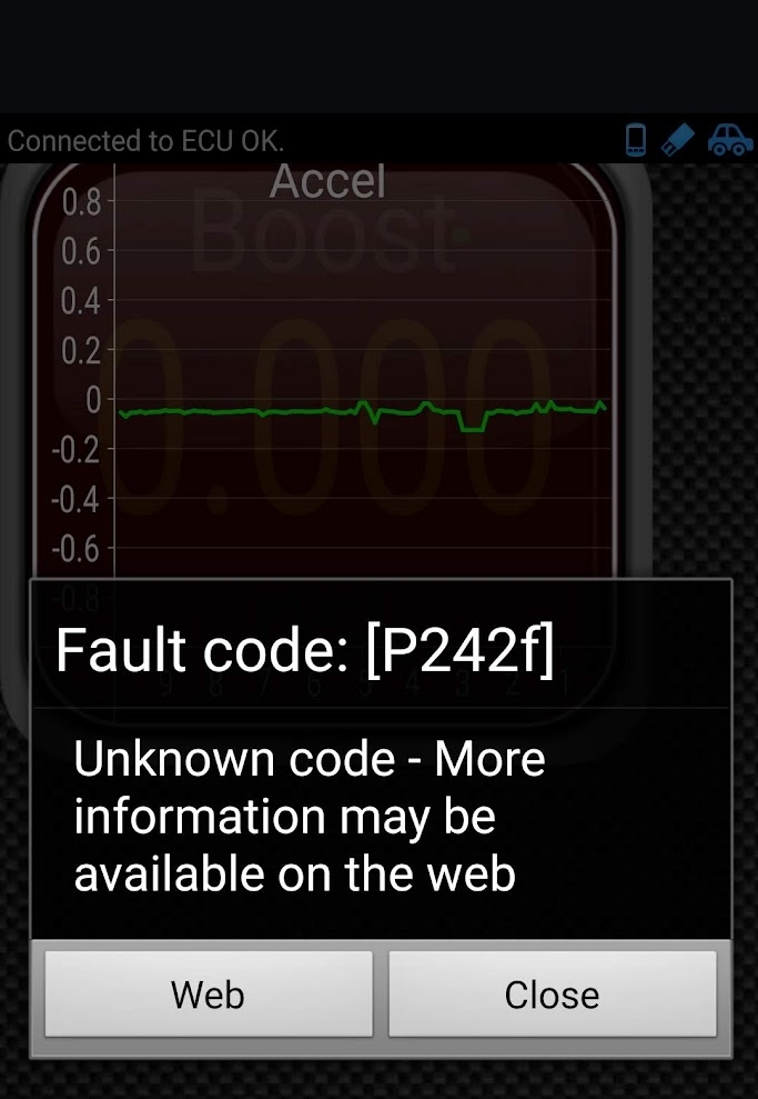

I've actually wanted to plug my ODBII reader into the tractor for a while just to test before it was actually needed. Here are my results. I had 1 code stored in it, and it cleared just fine.
The code opened on the Web and would be my exact issue since I have excessive regen problems.
You might be able to reset your faults to get you out of limp (dealer) mode, and force a regen manually if your model allows that like the new ones do, by holding down the regen toggle.

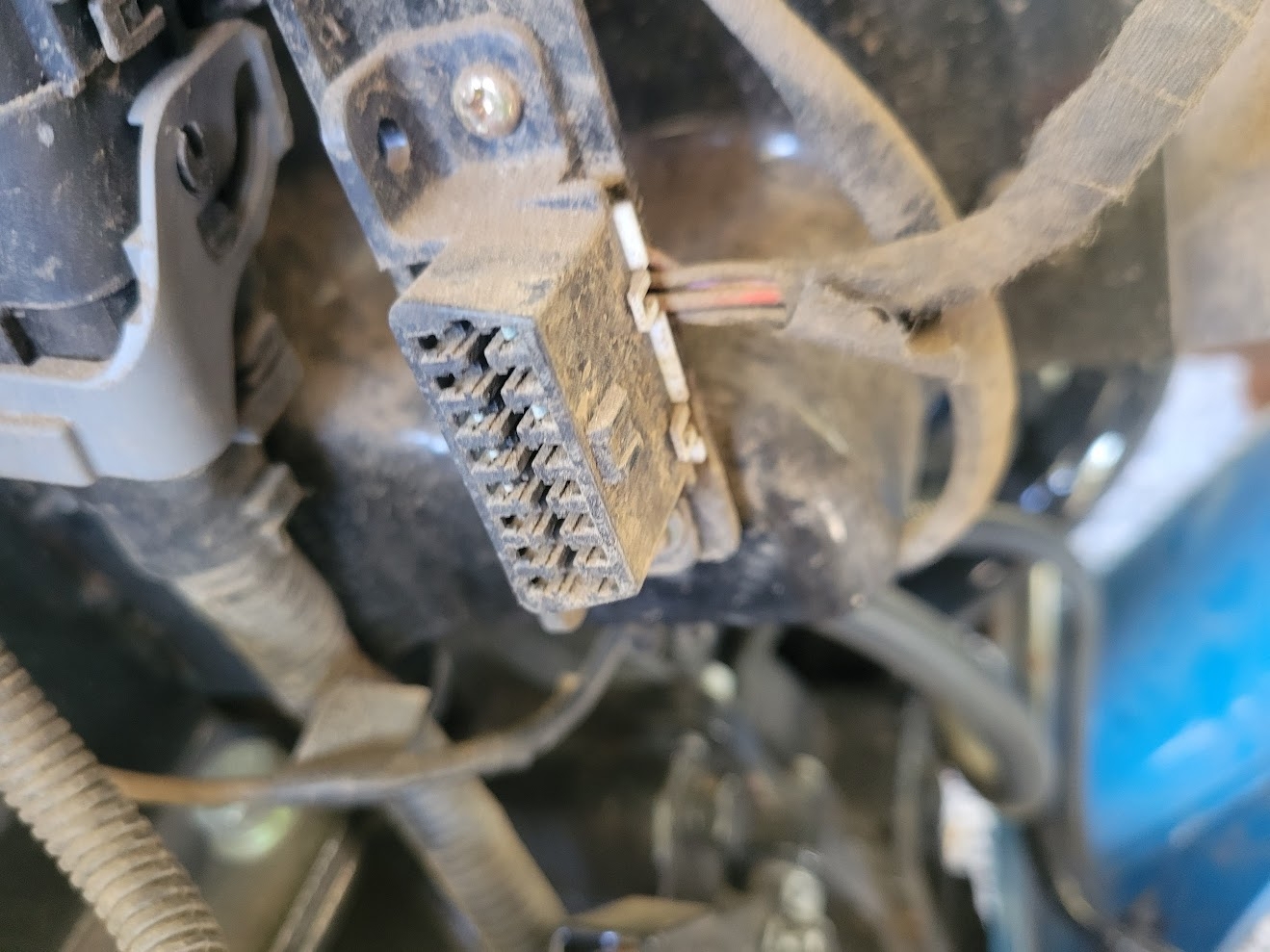

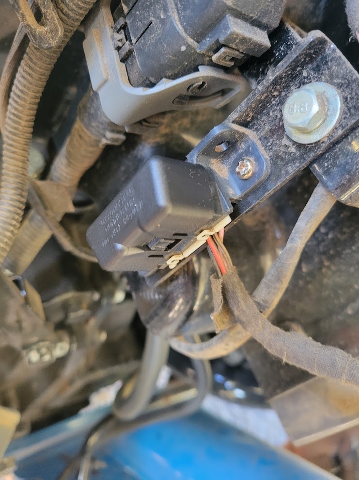

After I put the ODBII scanner on it last week, I noticed how dirty the connector was, so I ordered a cap. Cleaned the connector and installed the cap today. What should be a $2 piece of plastic is really $7 and yes, I know I could use a piece of electrical tape or something lol
Hopefully the dealer doesn't lose it at some point in the future!
I might make it captive somehow.
